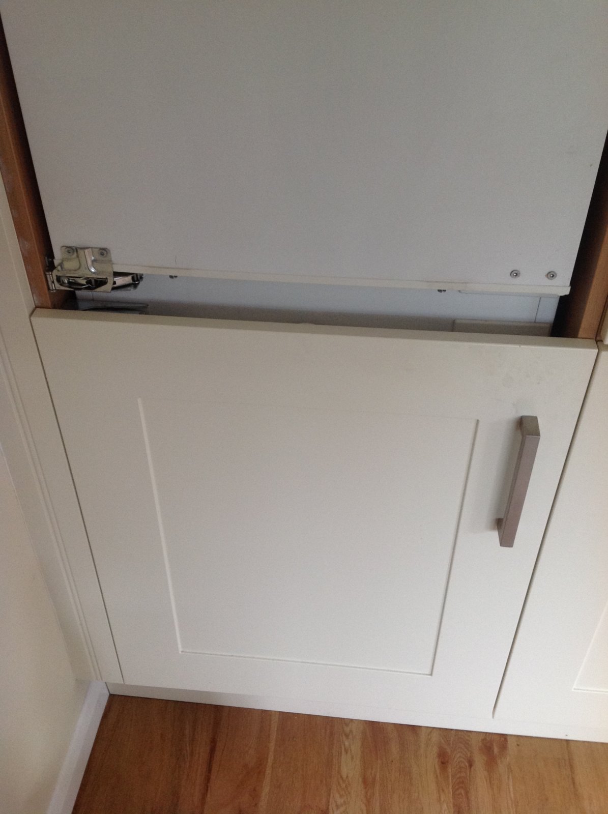

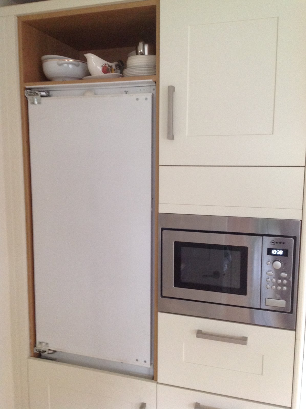

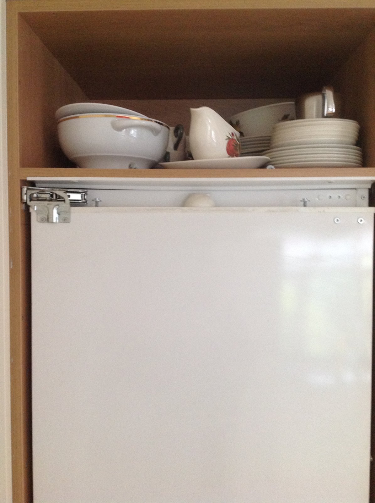

Here are some photos - the door supplied has no cutouts for hinges but I guess that was the fitter's choice

After reading all replies and due to the weight of the cabinet door, I'm inclined to think the cabinet door should be fixed (hinged) to the cabinet frame rather than being simply attached to the fridge freezer door and relying on its hinges as the fitter did it.
Your fridge is designed to take the doors on the front , difficult to change unless you can identify a separate hinge set for the FF.
The doors aren't to heavy for the appliance, the doors have been mounted incorrectly, who is the manufacturer of the fridge?? Bosch, Neff, Lamona??, with this information I can help you to understand how to correct the problem.
Thanks, as I said earlier I don't know the manufacturer - and I have had a good look all over the units.
I also understand how to correct the problem by adjusting the fixing brackets on the appliance doors if that is what you mean, but having taken the doors off and felt the weight of them I really don't want to leave them solely supported by the the appliance door hinges.
I will get the fitters back for some ideas...maybe try a sturdy stay from the top of the door to the 'soffit' of the carcass ( the door goes right to the top of the carcass I.e. above the top of the appliance, and/or an additional hinge inside the carcass in the space at the top
Where the 2 screws/bolts are on the top of the door we have a similar arrangement but we have a support plate attached to the inside face of the fascia door that sits on the 2 screws.
There should be a nut and washer under the support bar to allow you to run the nuts up or down to adjust the hang. Seems to me these may be missing.
