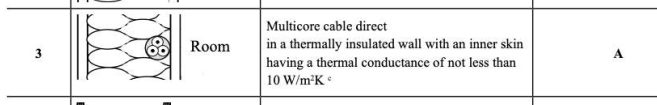

I have been reading all day to try and figure out what reference method should be used for the following as it doesn't seem to be quite covered in any of the reference methods or on any tables:
I've got an outbuilding with OSB stud walls, the outer OSB sheet has membrane then cladding facing outside the building and the inner OSB sheet has plasterboard and plaster facing inside the room. Between the 2 OSB sheets is a 100mm cavity, attached to the OSB sheet that forms the outer wall is a Rockwool/glass fibre on a roll type of material, this is stapled to the OSB inside the cavity, the OSB board it is stapled to forms the outside wall. 2.5mm T&E comes down from the top of these walls in front of the insulation, it will be touching the OSB wall that faces the inside of the building or have an air gap. The 2.5mm T&E is clipped on at the top of the wall along the upper studs then drop down to where each socket will go, the cable is not clipped inside the wall as these wall panels are prefabricated.
Where I am struggling to work this out is due to a few factors, firstly the regs mention "touching" the inner wall and not "clipped", the 2.5mm T&E is between the inner wall OSB sheet and the rockwool, I cannot say for certain it's touching the inner wall all everywhere it's certainly resting on the wall in places. Some of it might be in free air on one or more sides. I can say for sure that none of it is passing through the insulation.
I'm trying to work out if this would fall under Reference Method 102 or the A - G tables? Reference Method 103 really seems to get the impression looking at illustrations that's for scenarios where a cable would pass through insulation or be surrounded by it on all sides.
This does not seem too dissimilar to Reference Method 100 (But vertical) and speaking from my own experience I've never really seen T&E touching all of the plasterboard when laid on top of ceiling.
There seems to be some ambiguity with Methods 102 - 103 and it leaves a lot to interpretation, then there are the Thermal U values and types of insulation etc.
Any advice would be gratefully appreciated.
Following Note A* under Table 4D5 leads to Installation Method 2 and Reference Method A and I can't see your situation is any worse than that.

If any cable actually passes through thermal insulation and is totally surrounded by it that might be a different matter and should be avoided.
None of the wiring is surrounded by insulation, I double checked today with the company that installed the building as I wanted to double check, all cables drop down vertically in each wall panel in front of the insulation, technically should be "touching". Horizontal wires are all clipped running across the horizontal beams above each wall.
The outside cables will pass through approx 50-100mm of rockwool which I am factoring in with those cables.

The problem is with the sockets on the ring final circuit mainly, well come to think of it everything bar the internal/external lighting.
I've been reading the book all day and as much as other sections make sense I keep coming back to ref method 103 which really concerns me. I could understand a cable going directly through insulation or being wrapped in it but without being clipped it seems pretty impossible to get the cable to touch the inner wall surface or plasterboard all over to satisfy method 102.
What baffles me is the company who built the building have built hundreds if not over a thousand different buildings for residential and commercial use with this type of construction and wiring and I assume they have all been signed off at some point.
I think it refers to fairly solid insulation such that the cable is squashed between that insulation and the inner surface of the wall; not the fluffy stuff.
Even if it does not then if the cable is not touching the wall then it does not qualify as 102.
Also, as you have, if there is a space between the insulation and wall then the cable is not "in insulation" so nothing to do with 102 or 103.
Whether this counts as 'free air' or not I do not know but it is definitely better than Installation method 3 therefore must be better than reference method A (20A).

To be honest, I do not think many people consider derating factors in domestic installations because everything has so much tolerance and safety margin, the figures used do not really apply.
For example what is the actual current that would raise a 2.5mm² conductor in T&E to 70º and a normal 2.5mm² ring final could have a 40A MCB/RCBO; the regulation is still written for a BS3036 30A fuse and its derating factor?

Yes, but 103 derates the cables by 50% which is the maximum any cable is ever derated for being completely surrounded by thermal insulation for all its length.
