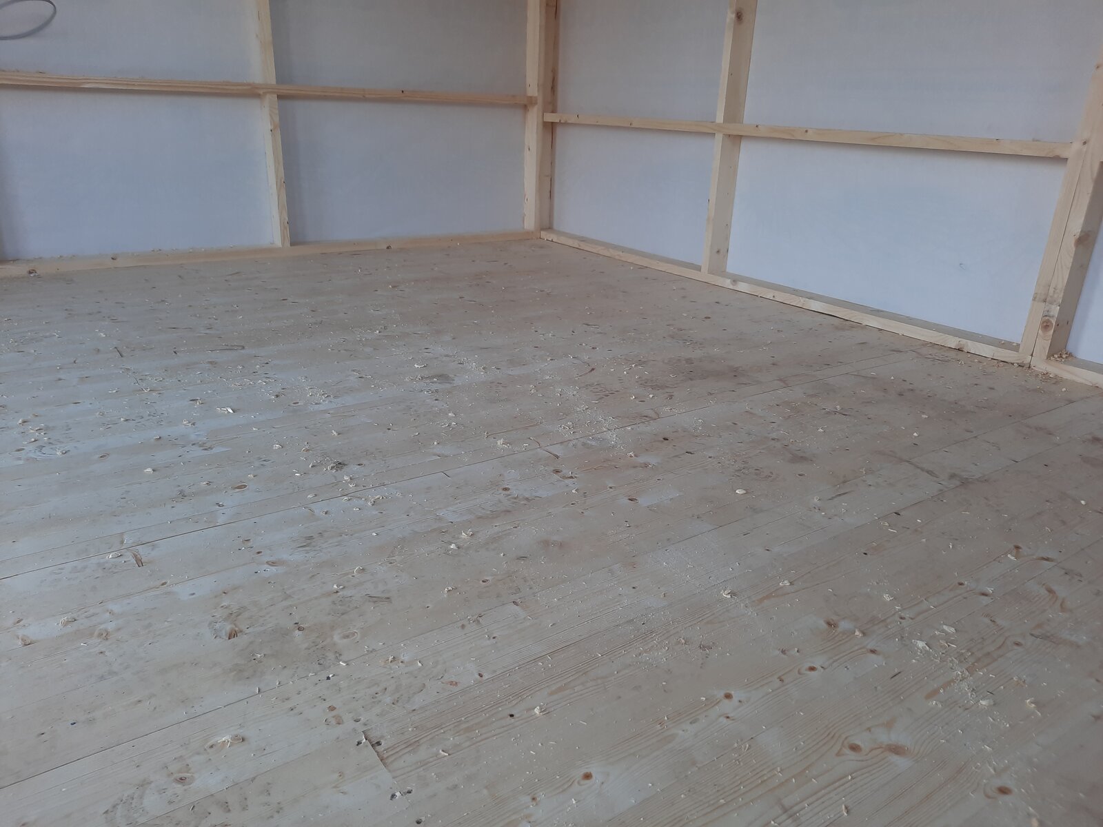

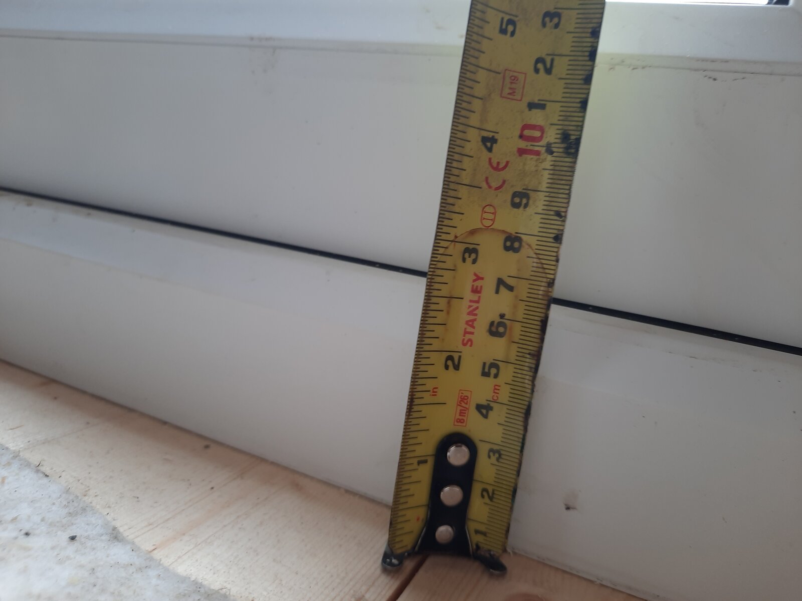

Ok so I don't think I have the height to install any over floor insulation actually. There are 2 ceiling to floor windows with very little clearance from the floor to bottom of the pane. Here's some pictures:

Here's pictures of the floor itself:
Is my only option here to lay some ecotec style 4mm roll to seal it for draughts then put the flooring down and hope for the beat? It's just going to be lino.

Even 25mm (or 30, whatever you can get away with) PIR would be better than nothing. Guess you could possibly also insulate around the outside perimeter below the floor, with vents for the cross flow, using suitable insulation that can be in ground contact. Might take the edge off how cold the floor would get. Bit of a last resort tho

I only really have 30mm from floor to the window frame starts sloping in, doesn't leave much room for ply and finishing.
