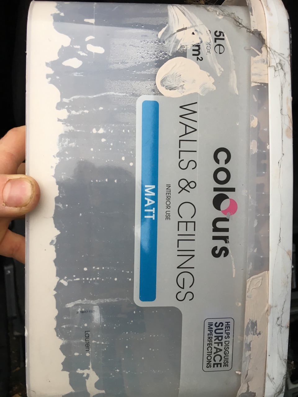

I got some mould issue on the wall and this is what I did:
1. cleaned the mould with anti mould spray
2. painted the area with THOMPSONS ONE COAT DAMP SEAL.
(https://www.screwfix.com/p/thompsons-one-coat-damp-seal-white-750ml/38631)
After the paint is dry, can I paint it over with normal paint? Or that will make the mould issue comes back?
The reason I ask is that I can't really remember the color I used to paint the place. I found the old container with word Lauren on it. But I couldn't find an anti mould paint that matches colour Lauren.
But when I googled it, b&q sells color Lauren beige, is beige the color I should go for? As there are anti mould paint that is in color beige.
thanks
Yes its fine to paint over and someone else asked (which i didnt screenshot) if it was ok to wallpaper over, and the answer was yes to that too.
