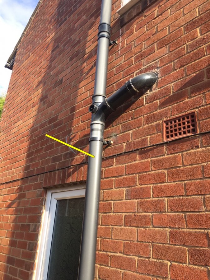

Can I solvent weld a new toilet waste with a push fit main soil pipe
8 Sep 2012
833
11
West Midlands
I am adding a new toilet and need a new soil pipe for it . I was advised to use solvent weld where possIble. I notice the existing soil (which it will join to - see yellow in picture ) pipes may not be solvent weld.
Would this still work with solvent weld? Do you get solvent weld to push fit adapters
Push fit soil is the norm nowadays.
Wastes - yes, solvent preferred.
The pipes are uPVC, and although the current fittings are ring seal (push fit), it is also able to be solvent welded. The offsets to get around the gutters etc on the vent section are usually glued on to prevent the whole lot moving in the wind. For soil pipework, the vast majority is usually push fit, although Terrain and the other manufacturers do offer solvent weld soil systems. Wastes though, professionals will use solvent weld pipework, (different type of plastic, ABS), but principle is the same. Looks neater, is cheaper to buy and done properly, will never leak.
You can graft a junction in as required on that stack, you'll need a slip coupling though to slot the junction as where required. Solvent welding that isn't going to work.
