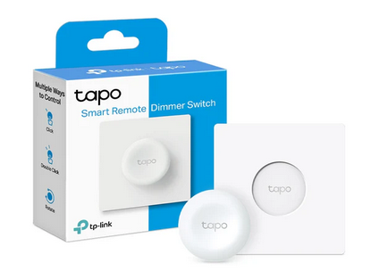

The TP-Link series do a push button with a cover so it looks like a switch 1735439164296.png S200D the S200B does not have the plate. Not cheap, but will do what you want. You would need the Tapo GU10 lamps as well.
