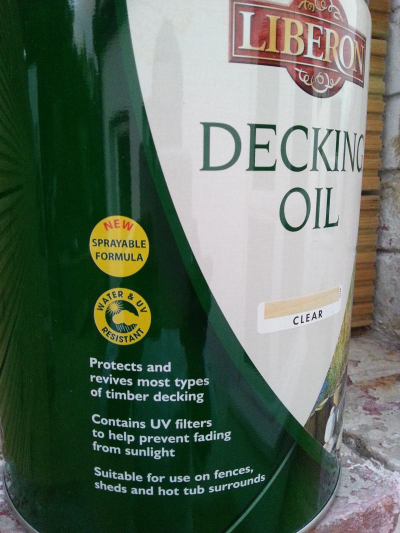

I received the oil can yesterday and it says "sprayable" on the side. Yay! The specs for the oil did not mention this online. Because the decking area is quite large and because I am somewhat lazy I am going use the oil in the sprayer after all since it will be much faster and easier to apply it that way.
It still remains to be seen whether this particular sprayer works with decking oil because the sprayer's specs do not mention oil anywhere, only paints and stains. I am positive that it will work because the oil should be about the same viscosity as paints. I will report back after I have used it.

From the newer label you have posted it appears that they have changed the formula but kept the same sku so it is probably an EU reduced-VOC version. (I can only find the original product data sheet.) A lot of decking oils have been replaced with water-based products since 2010 which are essentially a water-based stain with some extra polymers and UV stabilisers added and can be easily sprayed. However - it will still make an almighty mess of anything in the vicinity such as walls, paving and plants, and will need reapplying every 12 months or so as they sit closer to the surface than true decking oils.

A quick update. I finally applied oil to the decking and wanted to capture my experience here for people who may visit this thread in the future.
I used the sprayer mentioned in my original post and it worked fine as long as high pressure was maintained. After spraying a section of the decking I still had to use a brush to spread out the sprayed paint but the initial spraying made the job faster and easier than if I were using only a brush to apply the paint.
I applied 2 coats (within 30-45 minutes of each other) as recommended by xdave and also as suggested by the instructions on the paint tin. After allowing the second coat to dry for about 1.5 days I wiped off the excess oil with a bundle of lint-free cloth bought from Robert Dyas.
Even though the oil I used was marked as "clear" the decking did become significantly darker than the original colour of the decking. This was mentioned on the paint tin but I had not expected it to become as dark as it did. I am not sure if rain and weather will lighten it in the future.
