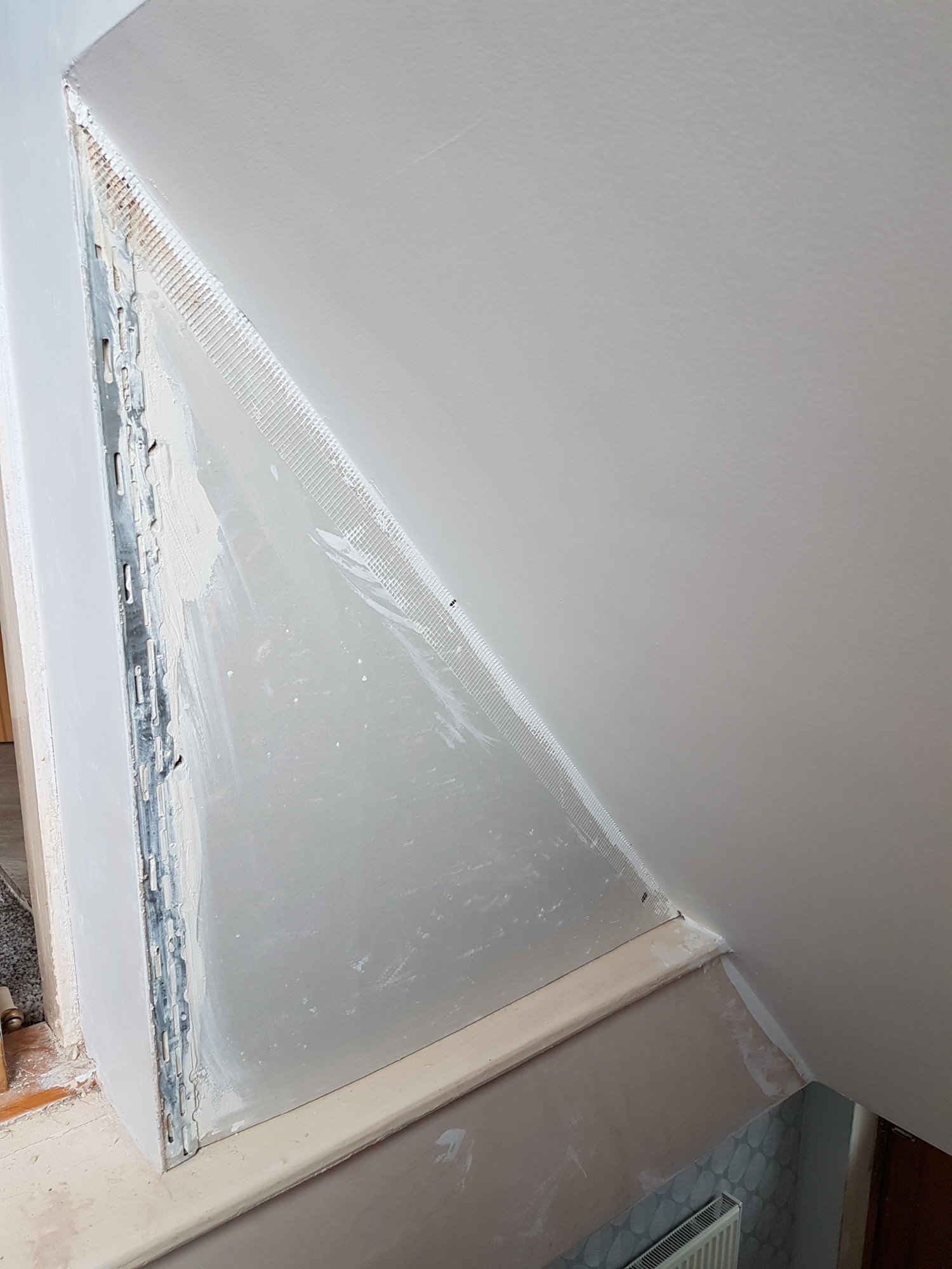

Small section that's needs skimming at stop of stairs, but because of the angle, I can't get a trowel into the corner...... any ideas on how to get it done........
Get as close as you can with the normal trowel, or a margin trowel, then use a pointing trowel, which will go right into the angle/corner. Even a pointed 'small tool" will do it
