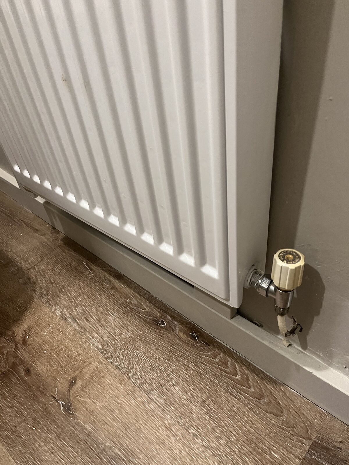

No. I just have a knob to turn one side and the other one with a spanner. Does not have specific numbers on.

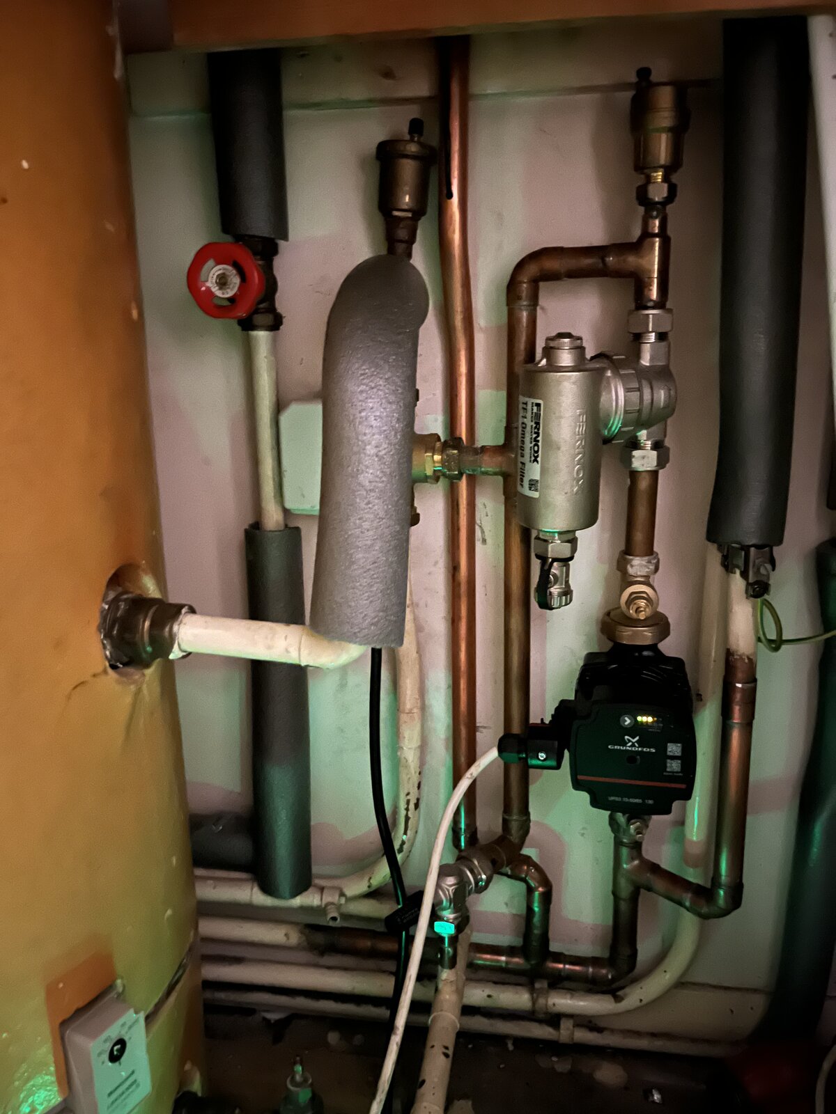

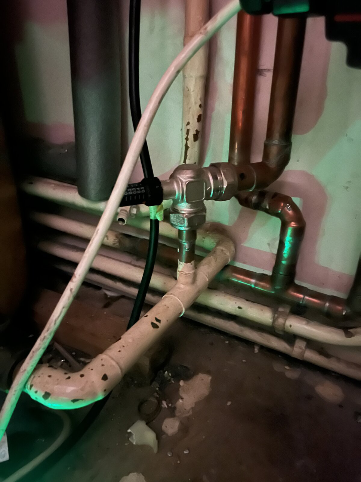

Here

I’m scared if I turn them all off they will go back to none working downstairs as I’ve had to spend ages trying to balance.

The boiler flow&return temps would be useful, also, since information is 1/2 the battle then knowing the flowrate is vital but Grundfos choose not to even display the pump power on the UPS 3 from which the flowrate can be easily read off from the pump curves.

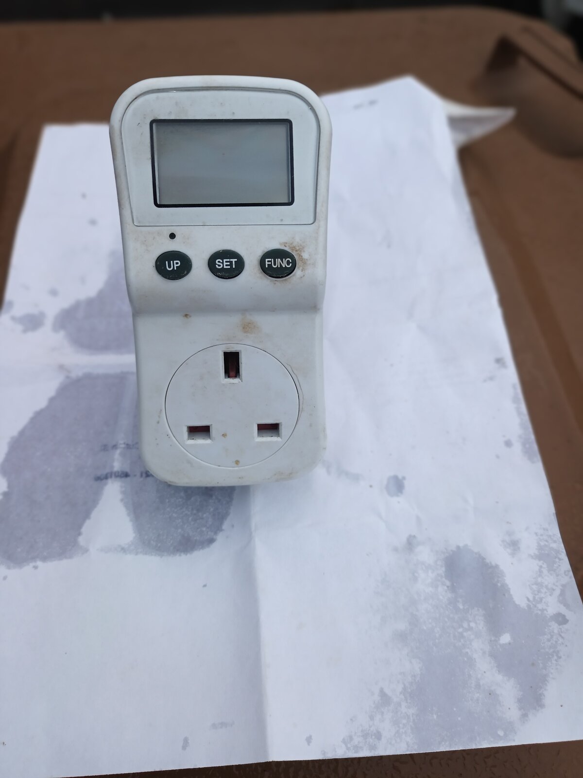

I would buy one of those £15/£20 plug in energy monitors and install it on the pump cable for a start.

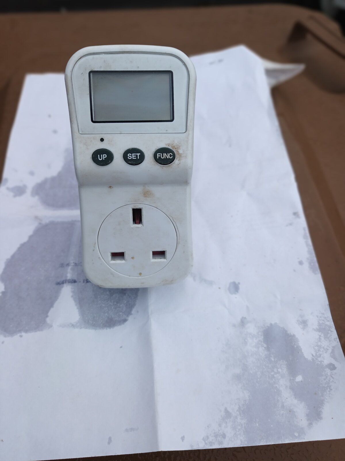

You will have to disconnect (or get disconnected) the pump cable from its wiring centre after carefully noting the terminal block numbers, then connect a bit of cable back into the terminal block with a socket on the other end, connect a 3 pin plug to the end of the pump cable, plug the (3 pin) energy monitor into the socket and plug the pump cable (plug) into the energy monitor and away you go, these monitors are very accurate and even a 1.0LPM change in flowrate will result in ~ 2W change in pump power, very useful even if just balancing rads.

It was actually nearer to 1W power change/1.0LPM
I've never did a full balance on my own or anyone's rads but a few of my ~ 1kw downstairs rads were running at a dT of 7/8C at a flowrate of 1.43LPM, I just throttled each one to get a power reduction of 1W (Wilo Yonos Pico in CP mode at a 3.5M head) , this incresased the dT to 18 to 20C and a calculated flowrate of 0.45LPM.
My 5 year old Wilo only shows the pump power but the newer models, (as do quite a lot of pumps now) display the flowrate in m3/hr, this changes in 0.1m3/hr increments or every 1.67LPM but still useful.
