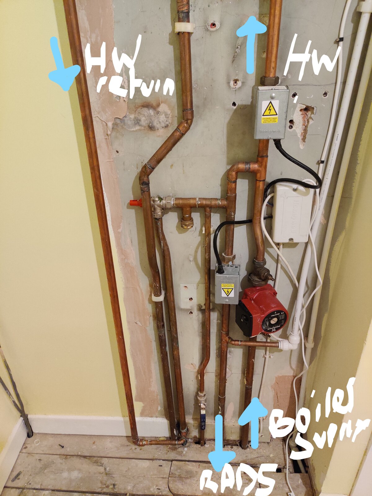

Hi all,
I have a S plan central heating system, boiler on ground floor, unvented tank in the attic (2nd floor) . The pump is currently in a bedroom on the first floor. If I switch on the heating only, water flows and radiators heat up. If I switch on the hot water only the hot water flows up to the tank. However if I have hot water AND central heating, the heating water will not flow up to the attic but the radiators still heat up.
I see 2 solutions, either add an additional pump so there is one pump for CH and one for HW or (and i;m not 100% sure on this one) I move the single pump to be above the HW tank. (of course I can put hot water on at a different time to heating, but that's not ideal)
Any views on this would be appreciated
Thanks in advance
W
Hi Ian, boiler is a worcester bosh greenstar pipe arrangement is in photo hope it maes sense
nothing sticking out there in that pic, you shouldnt need a second pump, not a good idea to fit one anyway, what is the pump speed set at ? try in on 3 and see if it helps

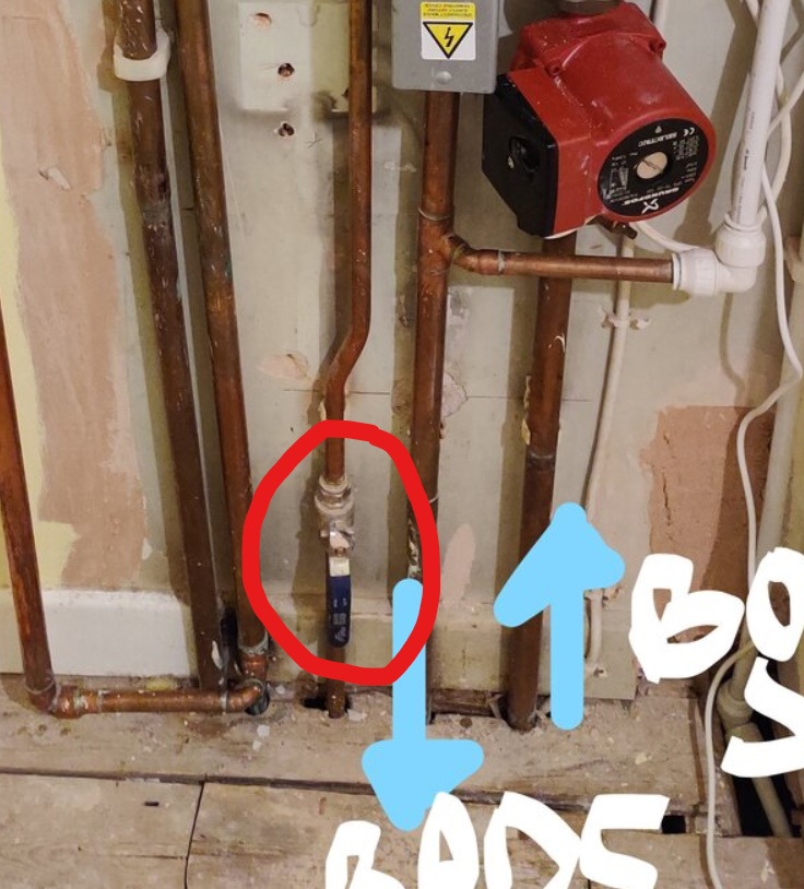

Thank. @JimCrow that pipe is out the the bathroom towel rail.
@ericmark I will check that as it would make sense to increase the resistance in the Ch loop to encourage the flow upwards to the hw coil
Any reason for that last 200mm of return from the HW dropping to 15mm?
If both 2 port valves are opening when both are calling (check the 2 port up to the cylinder is actually opening) and the hot water isn't rising to the cylinder then it's simply down to the available head taking the path of least resistance, which must be around the rads/through the bypass.
I'd head round the rads and turn one off after another and check each time to see when it starts to head up to the cylinder.
