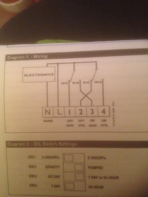

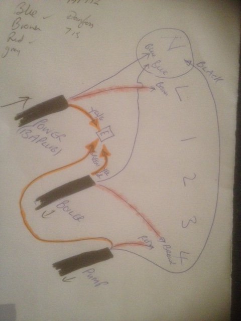

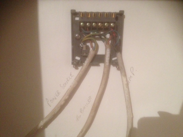

Here goes then. Included are some pictures of what ive got and a small wiring diagram of the timer from the danfoss brochure. Whilst the timer works for the system as it is, once I wire up the new valve, I think it may need altering slightly (??????!!) If I can explain more about the wiringat present. Theres the cable coming into the timer to actually power the timer itself. (brown to live/blue to neutral/yellow to earth)
The cable to the boiler . . . .(yellow to earth/blue to neutral/brown to terminal 4). The cable to the pump. . . .(red to terminal 4/green to earth/black to neutral)
When the timer and new valve are wired up corrctly, should the brown and red (boiler wire and pump wires to terminal 4) be switched to terminal 3 ? (ie to fire up "On DHW"), and then use terminal 4 to fire up the valve im putting, ie, to open said valve. (Even if im right, and theres four wires on the new valve, my loose theory doesnt tell me where any of those 4 wires go in the timer ???????!

You are on the right lines. Here is a diagram of what you are trying to achieve. (The earths are omitted for clarity) With it wired like this, the pump and boiler will run when the hot water is switched 'on' The motorised valve will only open when central heating is switched 'on' I have shown a room thermostat in the circuit, because it would be so easy to add and worthwhile. Just leave it out if you don't want it, the wiring is the same.
You don't need to use the orange and grey wires at the motorised valve, they are for an S Plan system.
You may find it difficult to get 4 wires in one terminal at the programmer, so you may have to join two or more of them together in a separate screw connector along with a single wire to go to the programmer terminal.
The downside of this arrangement is that you cannot have the heating on alone, you must also have the hot water on too, otherwise the boiler & pump will not operate. If you set the programmer to 'gravity' the hot water is automatically selected 'on' for you when the heating is set to be 'on'.

Excellent, Thats pretty much perfect and just what im after. What though, do I do with the two wires that wont be used ? Do i use some kind of "end stop" and tuck them away somewhere ?? (the red and the grey)
The orange and grey wires only go to a potential free microswitch inside the valve so they won't have any power on them. But it's good practice to put them in some terminals rather than leave them floating around loose in case they touch something they shouldn't.
Unless the motorised valve is right next to the programmer then you will need to have a junction box to connect the the motorised valve's flylead anyway, so get one with a few spare terminals in.
