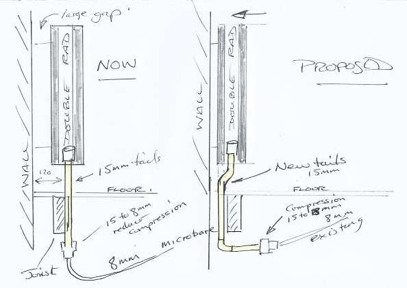

Same query, better explained .... Reading my own post above, perhaps it doesn't read very clear, a sketch should help ?
A hallway double radiator that I want to pull in closer to the wall and run the tails coming from the floor, behind instead of in front of the floor joist.
The tails will be bent dog-leg as shown on sketch to align with radiator valves.
>> Can I do the swap from old to new tails using existing compression reducers 15 to 8mm, without draining the whole system down again? Or is it too risky?
You should be fine if you only have one open end at a time.
I would do it like this:
Isolate rad, drain and rehang
Close any air vents on system
Open one rad valve and release system pressure. You will then find out of the system will "hold". You'll probably get about a litre or so of water.
Make the changes to that side of the pipework and close off rad valve.
Repeat other side.
Open air vents, fill system and bleed rad.
Drink coffee.
Ted

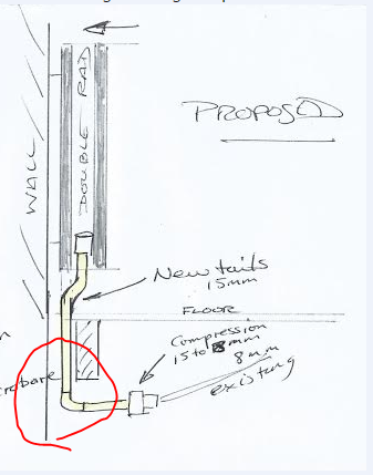

See circled elbow below>>
Will it matter using a compression elbow on the new tails below the floor?
Or should this be a gentle bend with no elbow?
>>> Also. Would you be doing this at all based on what I have described, just to pull a rad and its tails in closer to the wall?
>>> Or would you have left it? See Now and Proposed in sketch in earlier post << Your opinion, just for my curiosity please!

Elbow as circled below, or a gentle bend instead?

Bend is better which you can do dry before you start all this.
Ignore the drain off. Turn off system. Open one valve over a tray and wait for the water to stop. If it doesn't stop, you're into a full drain down. Chances are it will though.
Definitely worth doing
Ted
I find it helps to shut off all the other rad valves first (make a note of positions for balancing).

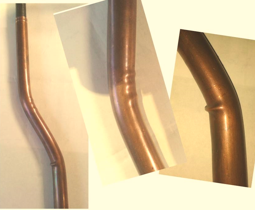

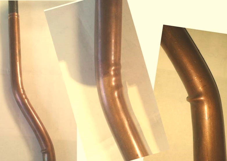

I have tried bending a sample of the proposed dog-leg 'S' bend radiator tail using a pipe spring and bending it over a 4" dia round wooden post.
This is what happened! ............. the one on the right is particularly bad.
I have bent things like this previously and had to really push, this went easily , too much so, which I assume is down to what seems to be thinner copper tube.
I can practice more but it could get expensive with copper currently at £3,471 per tonne and me a slow learner!!
What am I doing wrong? Is the copper tube really thinner than some few years ago? It feels like it is.

If you have 8mm main pipe to radiator why not extend this in 8mm bring it up behind joist and you can bend it to required position easy by hand.
Either replace rad valves with 8mm ones or us a 8 to 15mm adapter with existing valves.

Thanks but that in 8mm was exactly what I had and was trying to get away from because it got kicked and knocked and was forever weeping requiring tightening and tweaking.
I put ina replacement rad with these new 15mm tails on the wrong side of the joist because it was more difficult to bend these, but the radiator is a long way out from the wall and the whole thing being at the foot of the stairs I get a similar problem with it all being in the way, but without the leaks - 15mm is more robust. This was an attempt to pull it all back snugly into the wall.
So 8mm clipped to skirting board itself 90° elbow under valve back to skirting? Or, depending on skirting height and radiator height, bring 8mm up behind skirting.
So 8mm clipped to skirting board itself .........
I was trying to make it more robust by having 15mm instead of 8mm above floor, the only hiccup was this dog-leg tail bend in 15mm.
Sounds like you think it is better to get back to 8mm for the whole run but routed snugger and less exposed.
>> Is that instead of mixing 15mm above floor and 8mm below?
>> Would that be your favoured option from where I am now?
St0rmer66
Those will work fine, just don't look as good.
Q> So what was the issue with the bending shown in photos? Is it down to the thinner copper tube, or me, or both?
I didn't get this problem some few years ago with what then seemed to be thicker 15mm tube.
