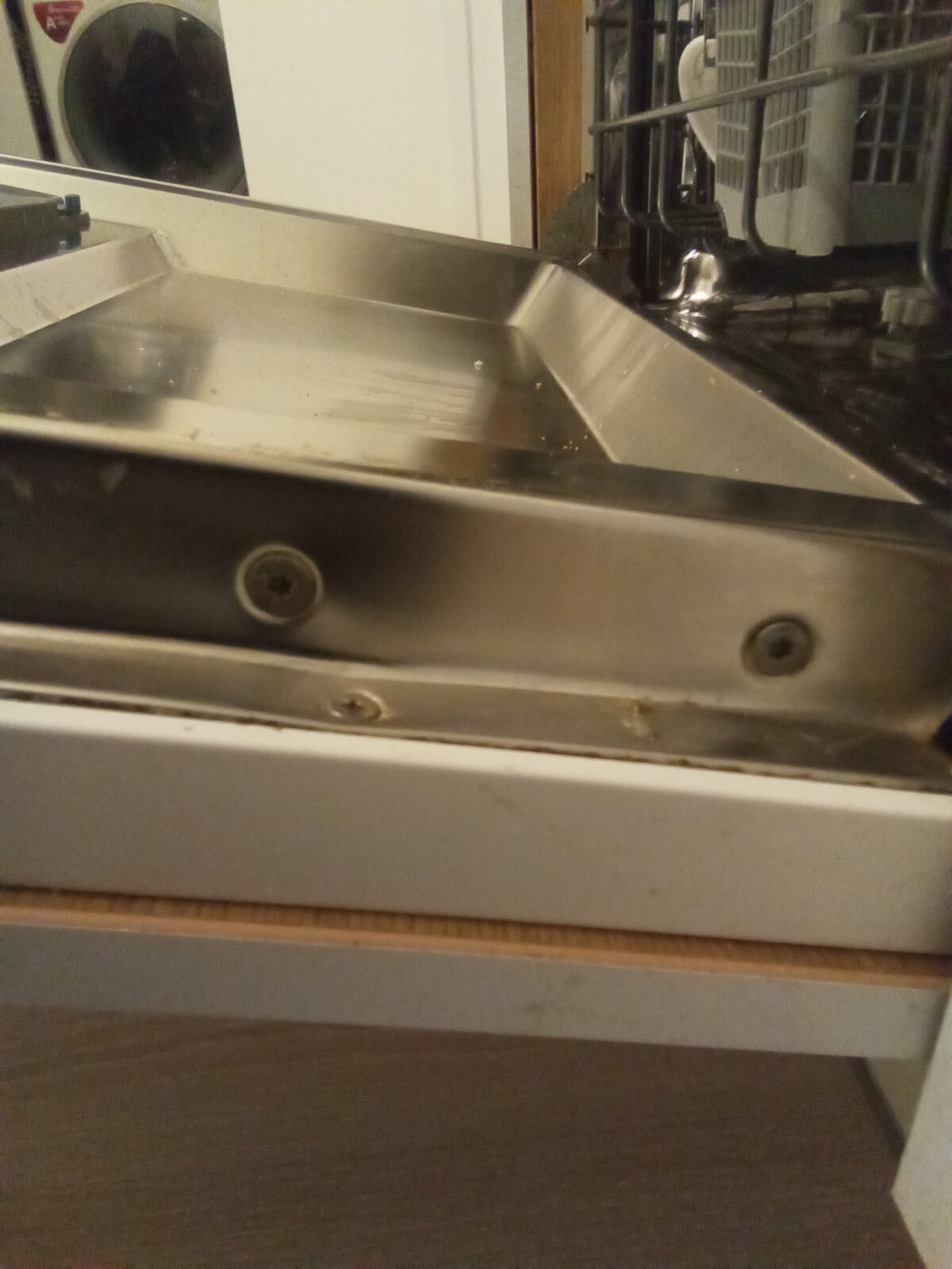

Wife decided she wants to change the handles on the kitchen doors and asked (well, told) me to do it, no bother easy job and it was until I came to the dishwasher, how do I get to the screws to take off the handles? It's a Montpellier MD1700 and i've d/l the installation manual but nothing about fitting/removing a cupboard door. There are 12 screws in the back of the door and 4 star(?)screws at the side of the door. Don't want to remove screws incase I remove the wrong ones. Pic below of screws
Any help please.
It's the cross head screws that go through the back of the door. 12 of them would be a lot more than required to hold the cabinet door to the appliance door though. Only the longer screws need removing.
