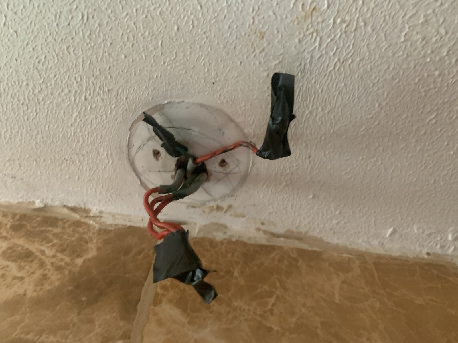

Hi there.
Happy Monday and I hope whoever reading this is well. I'm trying to replace a 40 year old light switch (which has been removed). I am left with 3 x red wires (which their own outer grey tubing) all wrapped together at the end and 1 x other red wire which shares some outer grey tubing with what I think is the earth maybe?
How do I translate this to the new wiring system (new drawstring light switch has 3 holes in the centre block and an earth screw on the side)
Thanks in advance :)
AL.

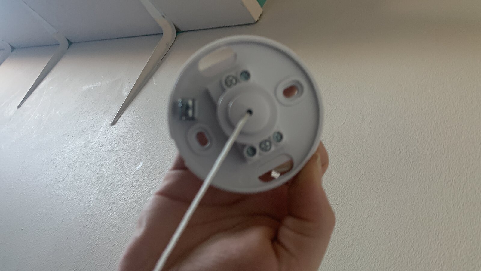

Show us a pic of terminal identification on new switch.
The earth conductor/s go to the earth terminal. The single red would go to com and the others bunched together in L1 would be my suspicion,Or vice versa.
Presumably the three reds in COM and the single red in L1 or the equivalent markers. Earth wire in earth terminal.
The same as it was connected before.
See pictures below. On light switch the available holes are:
- L1 & L2 ( 2 holes on one side, lower)
- L (1 hole on top side)
OK so to confirm. The 3 red wire bundle I can put into L1 and single red into the L? Then earth to earth obviously.
Yes ,or 3 red into L ,and single into L1, as said above it doesn't matter.
