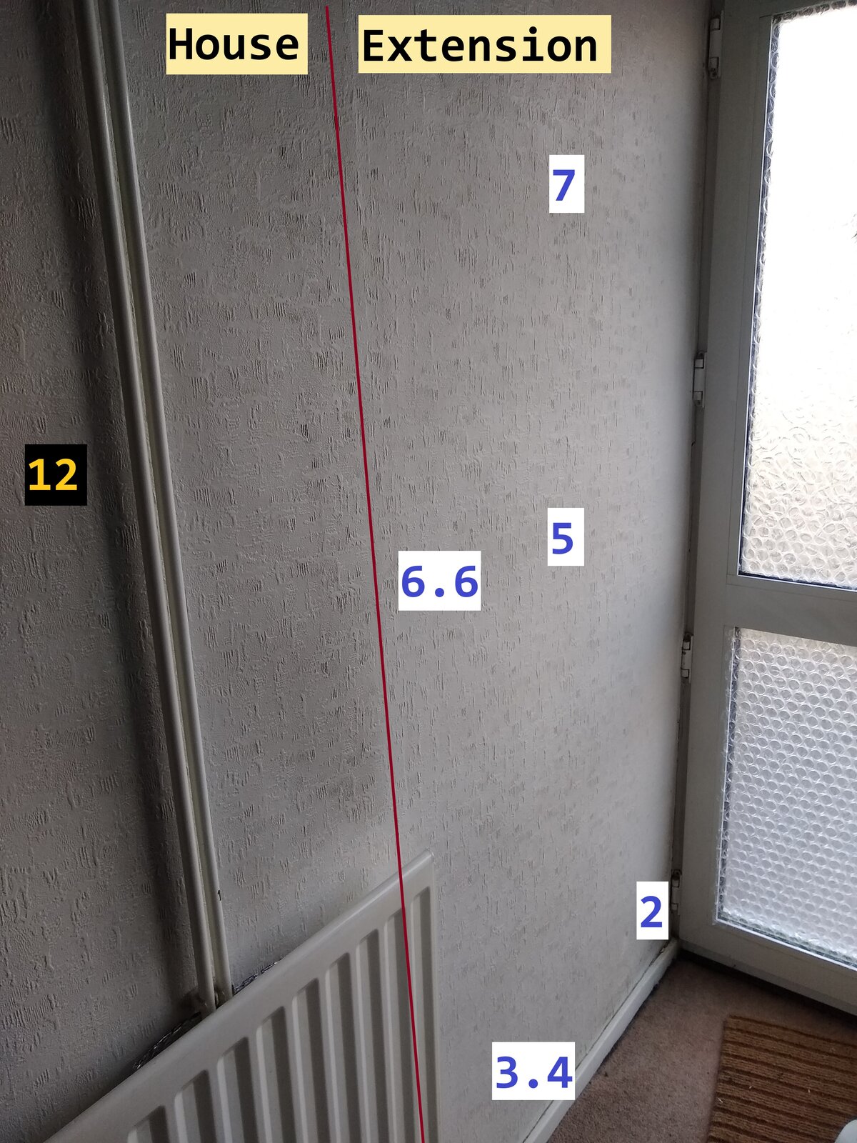

I've taken some measurements with my IR thermometer when it was around 0.4 degrees outside and the measurements are on the internal pic. There's cracks in the plaster round the double glazing on both sides which we can fill but we don't seem to be seeing draughts from but the temperature isn't uniform across the single-skin wall either, we're considering filling all the cracks and going around with some sealant to see if this would make any immediate improvement.

Perhaps you could box in the central heating pipes say 50mm deep, to the right of this box, then use 40mm kingspan tight to the wall and finish in 9mm plasterboard & skim, make a feature of the step?!? (which would be to the left of the pipes.)
I'm not familiar with Aerogel, but can't see 10mm offering a lot of thermal performance.

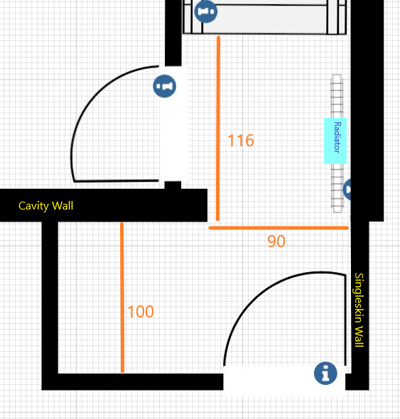

Could you not put another door and stud wall just past the radiator?
Not really, it's a 1 door width square space at the bottom of the stairs. The attached image from the listing should demonstrate (ignore the relative wall thicknesses, they're balls).

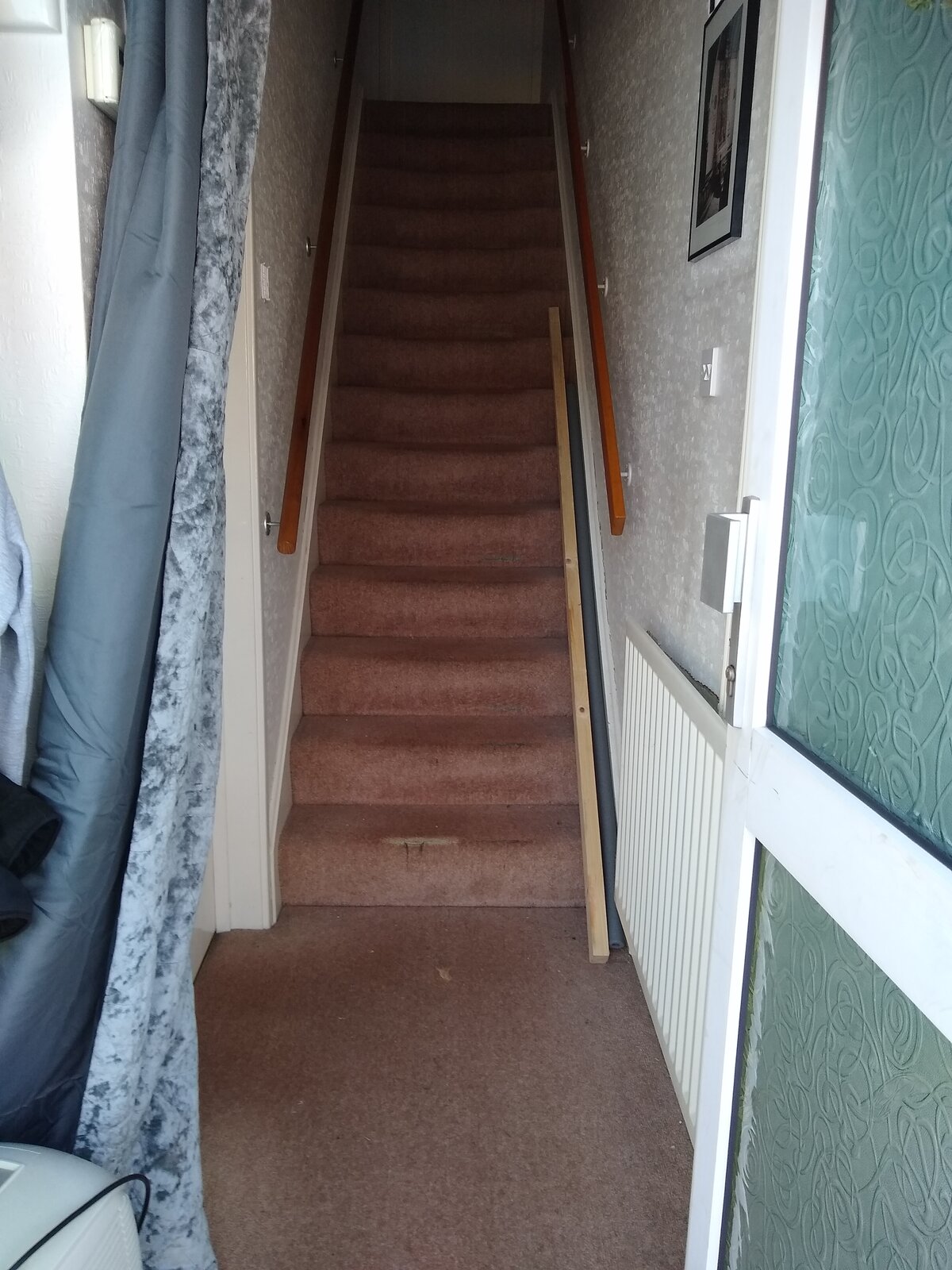

A door, or even a curtain, to block off the house will keep the cold out.
We put in a curtain, that's when we got the damp spot on the wall as the temperature has dropped way too much, the ceiling is the one bit that isn't cold and I'm loath to do anything with it as it'd mean taking off the ceiling tiles which are probably helping right now.

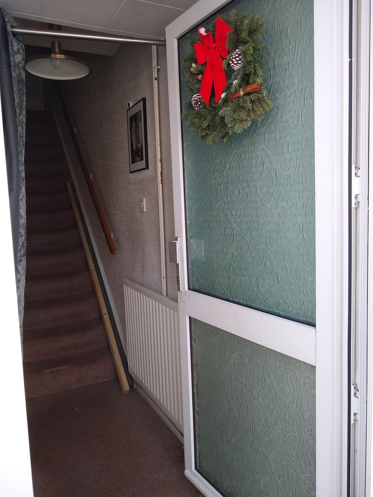

Is there room for a sliding door, one of those lightweight ply flat type?
Looks like the brick wall could take one, on the porch side, if you could make this fit as good as possible, perhaps you wouldn't need to do much in the porch.
As already mentioned, sort out any drafts, gaps etc.

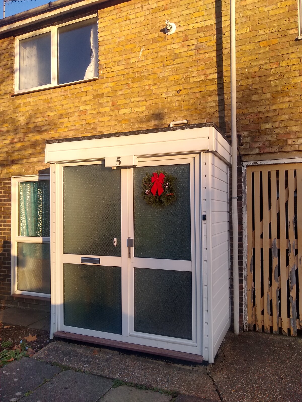

Yes, we could do with better photos, take some from outside looking in please.
Been away and the last few days weren't great for taking a picture.
I wouldn't necessarily presume the doorway in the cavity wall has had a door in over 30 years and possibly has never had one, every house of this age and design nearby has an extension of exactly the same dimensions and design and looks like it dates from pre right to buy (bought 1983 in my case) at least.
Putting in a door is possibly an option but doesn't give you a great deal of room to stand in whilst opening it, it's very tight.
