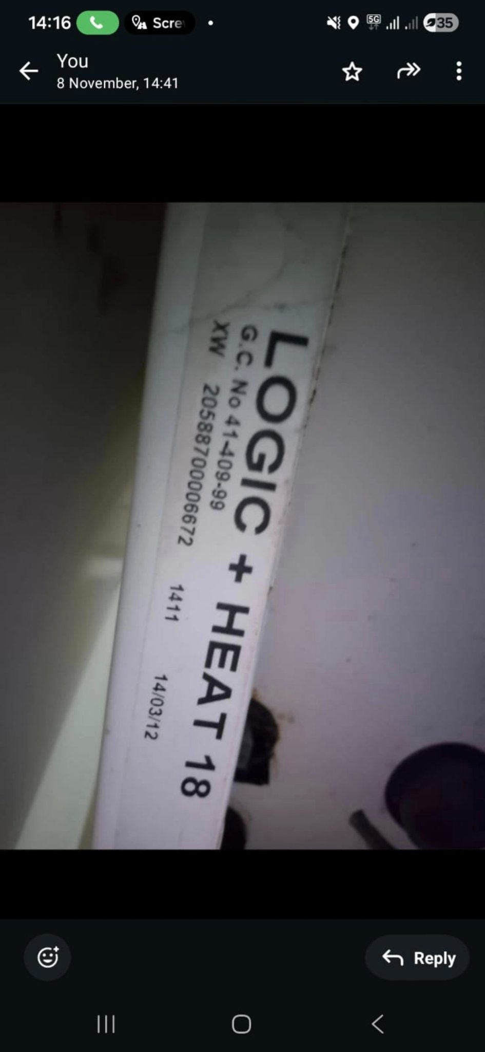

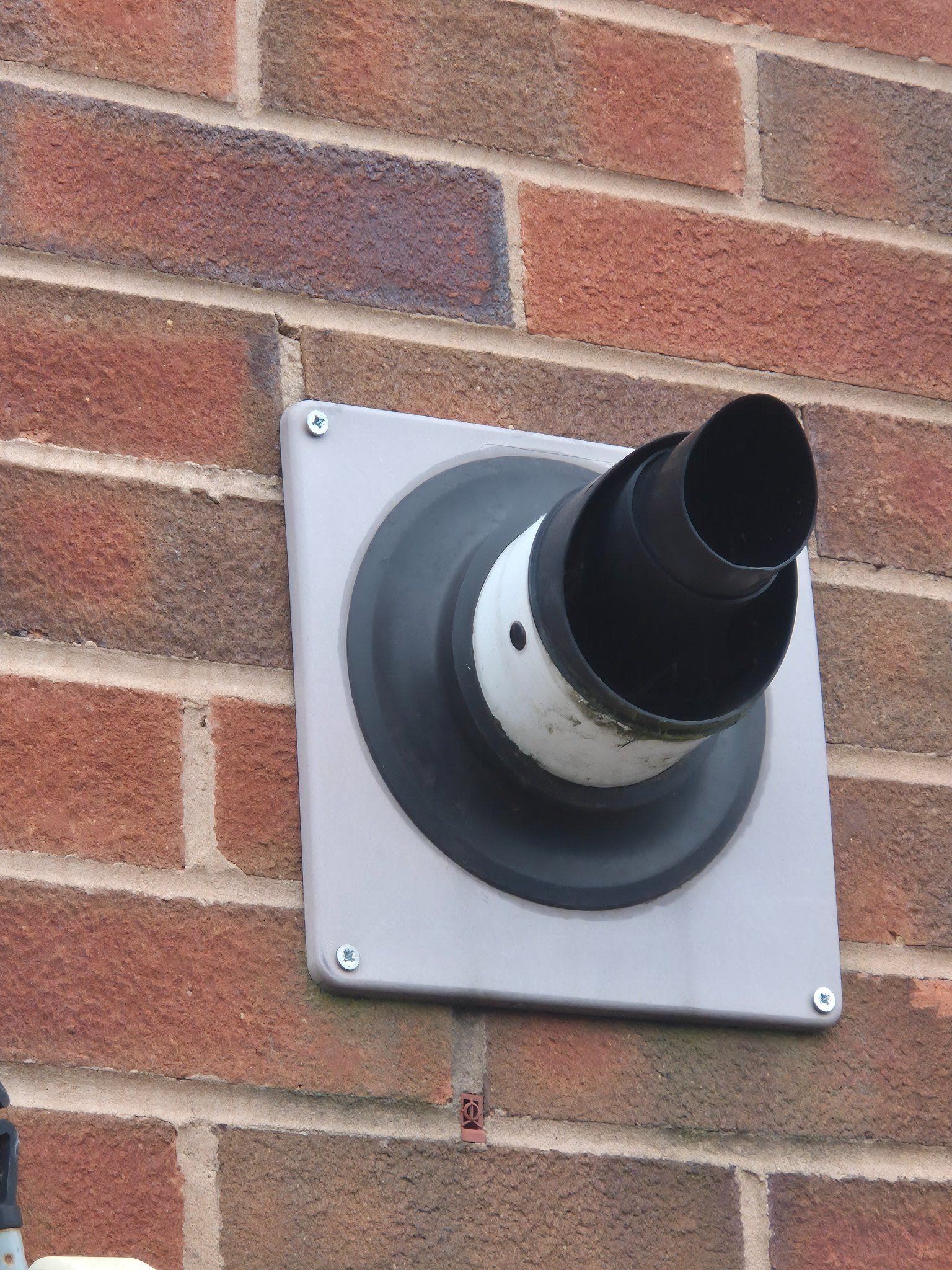

Hi there,
Please could you suggest which plume kit will fit on this heat only boiler. Can I just buy a standard Ideal kit or Worcester Bosch.
Please asvise. We're having a veranda installed and flue needs to be diverted upwards.
Thank you so much
You'll need to buy the Manu's plume kit.
Also, that flue hasn't been cut to the correct length, there shouldn't be any white on show.
