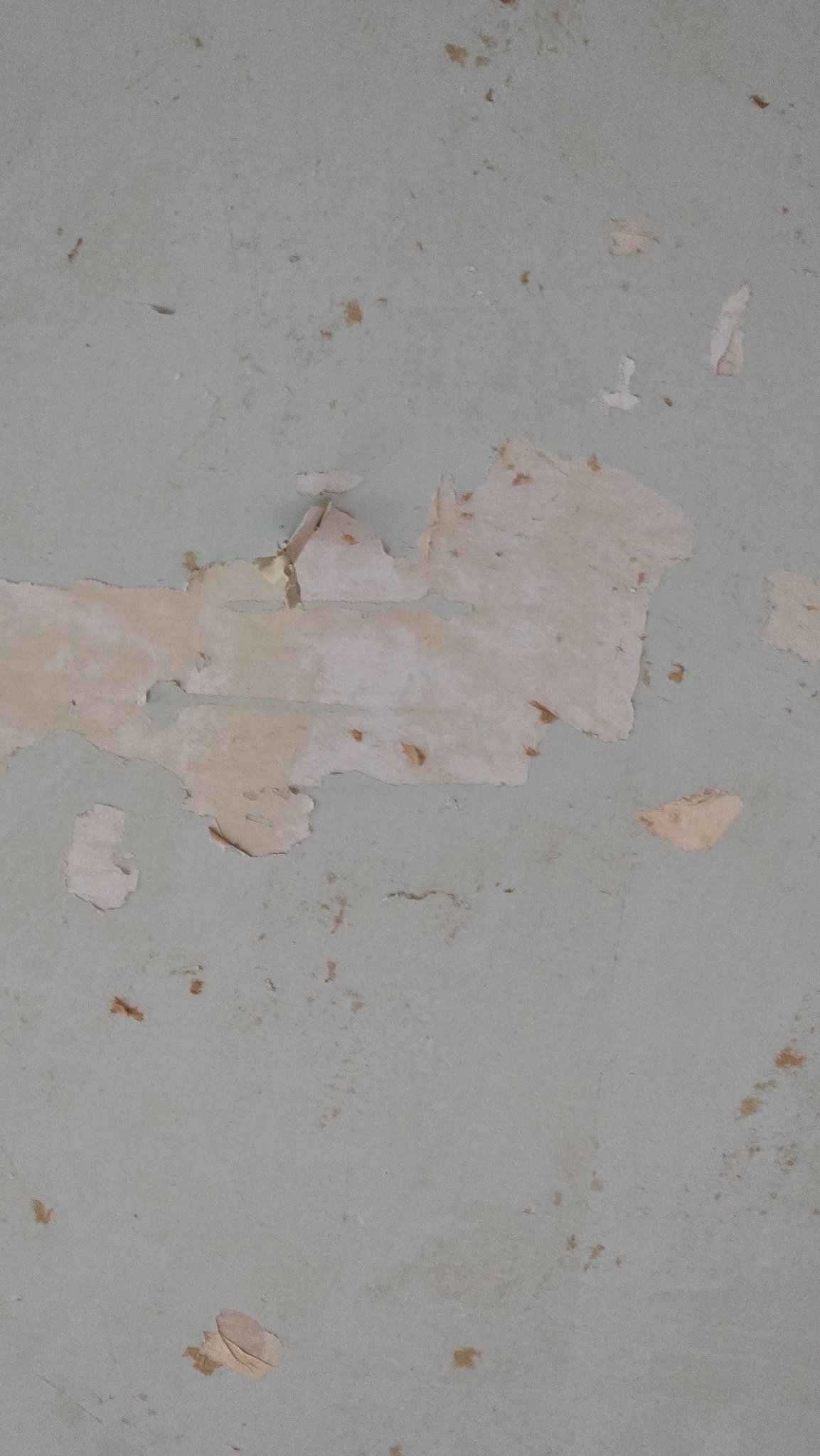

Hello
I have a cilling where after the wallpaper has been removed, what was lef is thin layer either paint or some form of glue. I have tried different products to remove it, like home DIY stuf( warm water with vinegar and washing liquid), paint stripper, wallpaper remover solution, with very little result.
I have attched a photo of that.
Any ideas/recommendations will be greatly appreciated. Thanks

I think your ceiling is painted with distemper. It is a sort of whitewash made of ground chalk and bound with glue made of boiled up horses hooves. It will dissolve in boiling water but not in warm.
I am probably one of very few people on here who has not only cleaned it off, but also mixed and applied it. When treated with hot water, it has a distinctive and unpleasant odour.
It is a very difficult surface to redecorate.
It is possible to scrub it off walls with a stiff brush and constant kettles of water, this will not work on a ceiling.
At this age, the ceiling may well be cracked and sagging L&P, so you might consider pulling it down and having
it replastered
John, thank you for your replay. I was trying to avoid that as the plaster underneath is good.
Will sanding work?
It looks like paint.
If it is distemper, you can soak it with thick wallpaper paste (the powder mix stuff- a cheap product). The water in the paste will evaporate slowly, allowing time to soften the distemper.

I have tried that but no luck.
I have worked with distemper quite a lot, and the glue needs very hot water to remove it.
It used to be used in kitchens and wash-houses.
