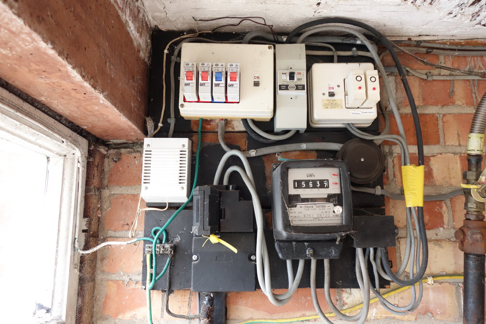

The washing machine (AEG 8000) has gone rogue. Iţ trips the electrics either immediately or within seconds. I have drained it and left it to dry for a few days but to no avail (except to give me a few more seconds before the trip). It is over 5 years old so replacement is probably better than repair, but I want to be certain it is the machine itself causing the problems and not a fault with the house electrics. These are the tests I have done:
1. Run a 2KW heater from the same socket with no tripping. This would seem to exonerate the socket.
2. Tried to run the washing machine from a different ring circuit (i.e. a different one of the four MCBs in picture). The electrics are tripped just the same.
3. Examined the power cable. Looks intact, as does the sealed plug.
So it seems obvious the washing machine is the culprit but there's one thing that gives me doubt. When the trip occurs the main circuit breaker (grey box between the 4 MCBs and the 2 lighting MCSs) switches off but the individual MCBs always remain on. Is this significant?

The "grey" box is an RCD which detects leakage to earth and isolates ALL the circuits downstream of the device

And maybe get an updated CU fitted with RCBO's so that a single fault doesn't have such a negative effect.

....but going back to the initial question, is it normal for the main circuit breaker to trip but the MCBs to remain untripped?
Yes completely normal an mcb would trip on overload or a short circuit, an rcd trips with earth leakage.
It can also happen the other way if the circuit was overloaded the mcb would trip and the rcd wouldn't.
You can also get rcbos which are a combination of the two.

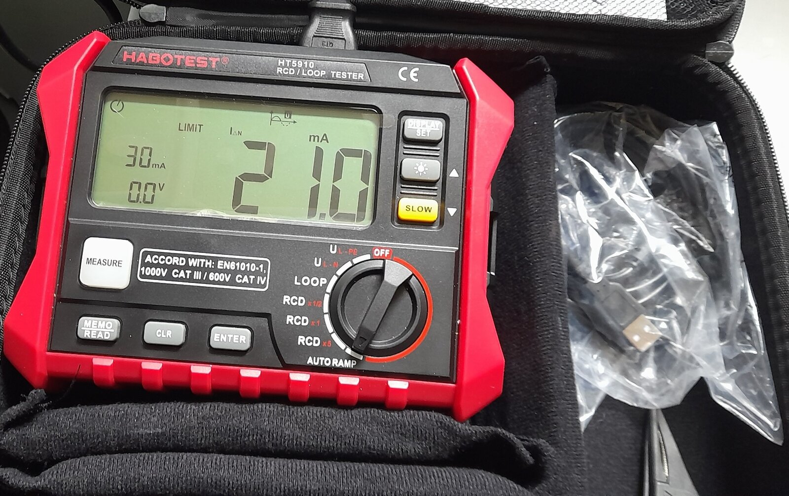

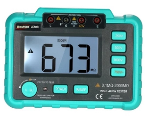

1750105457774.pngVC60B.jpgRCD tester ramp.jpg These are the testers we use, and they are not cheap, I paid £35, £35 and £75 for my testers, and it also needs skill to use them. But anyone would help sort out what is faulty.

It is the RCD which is tripping, which offers protection to most/all of the circuits in your house. If any circuit develops leakage to earth, possibly via you, or a member of your family, or perhaps via water where it should not be - then it will trip.
If your washing machine is leaking water, that could well be all it needs, to cause the RCD to trip. Your most recent post, seems to be suggesting your machine does maybe have a leak. If so, then fix the leak, rather than the symptom.
simple, you find a registered and competent electrician and say “I need a new consumer unit with RCBOs”
It is not a DIY job!
I completely agree with the above.
Hopefully, you will not need to have the "Supply" connections and the Meter changed/moved - at your expense.
A new Consumer Unit is required,
with RCBOs for all circuits.
(Even the existing "Extra Low Voltage" "Bell Wiring" is poorly done - and should be done better.)
Since it seems unlikely that a new CU would fit in the existing (high) location,
it is to be hoped that sufficient space is available below the Supply connections and Meter etc.
