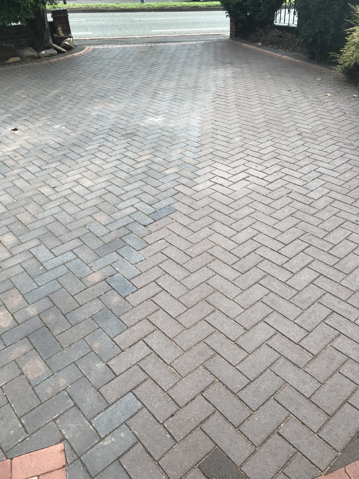

I had my drive extended a week back, compared to the rest of the drive the new area was only a small Proportion (the right area on the main picture)
Quote I received via email stated that matching clay 60mm pavers will be used.
Job took a few days to complete. I paid via bank transfer.
The next day after the sand had been washed away by the rain I had a few concerns.
The bricks used for the extended area do not match.
Bricks were ordered via mail delivery so how could a good match be guaranteed?
Day 2 of the job they realised they would run short so got a handful from a local yard - these are a different shade aswell.
After job was complete I discovered they had used 50mm bricks! (Original are 65mm)
Pictures attached to give you an idea; you can clearly see the different pavers.
I can fully understand that exactly matching pavers which have been laid 20/30 years ago will be a near enough impossible task however this Match appears extremely poor, yes?

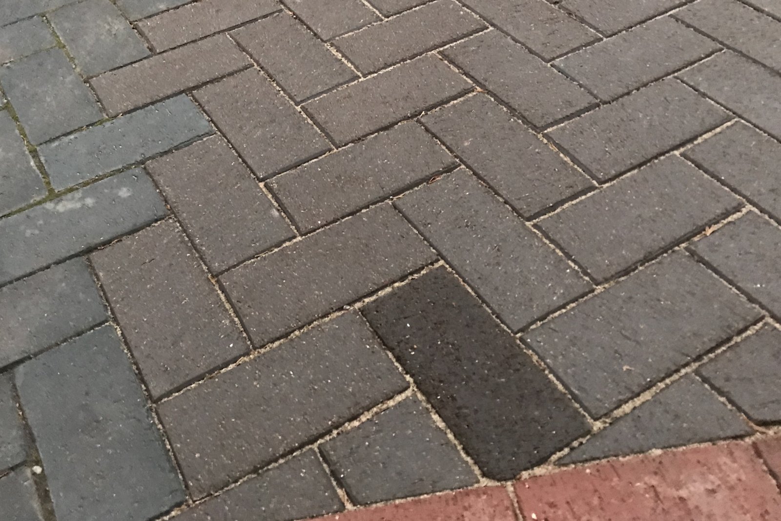

From the image, some of the originals look pretty close to the new, but overall the original has a blue cast and seems more shiny.
It rather makes me think the original, or a section of the original shouldve been lifted, mixed in with the new and laid -but I guess if you start lifting the originals maybe they all have to come up.

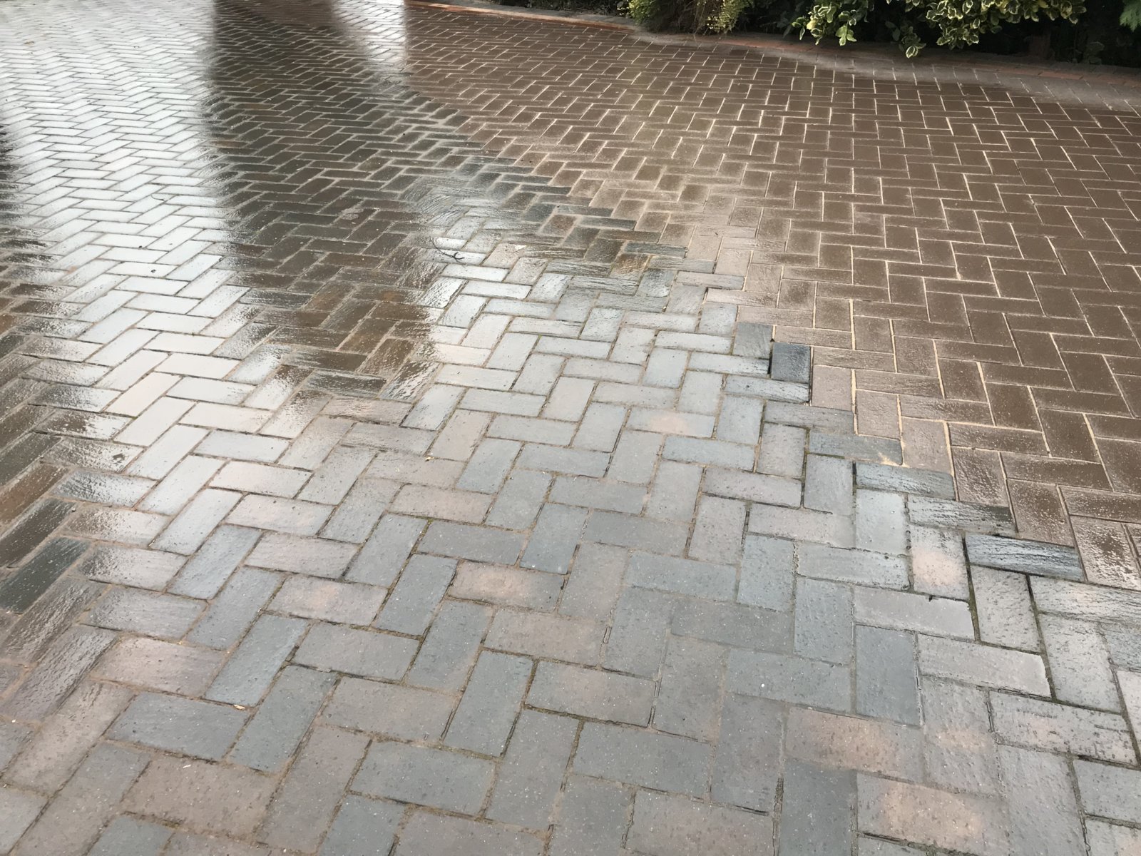

Above is new
Above is original
Hi there,
Yes the originals have a blue tint/shine to them, the new ones are a Matt/dull type of purple. The new bricks are one colour, there is no two tone type colour like the originals.

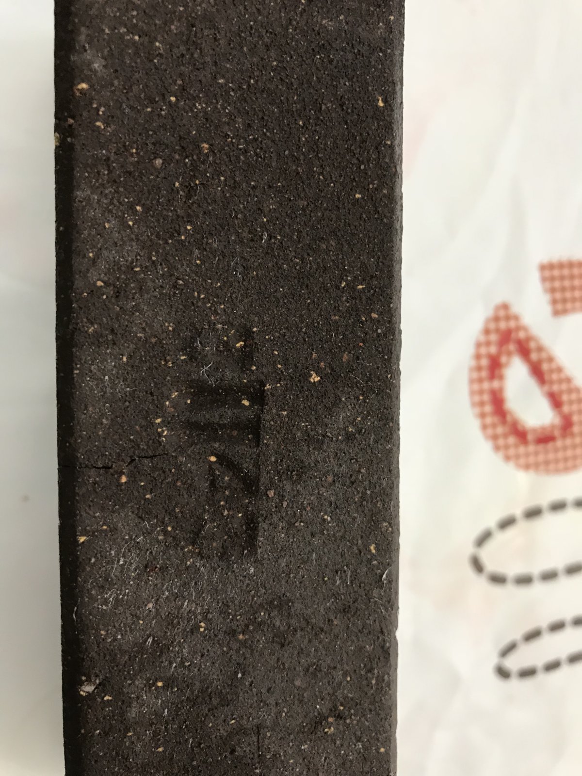

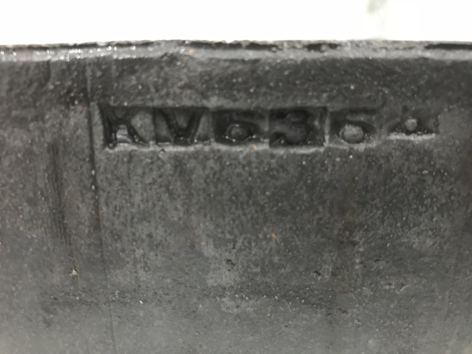

I have lifted 2 bricks earlier and they both have different codes - no brand name though.
I was told that the bricks ordered are “charcoal brindle” however they don’t look charcoal at all!

You cant get 65mm anymore only 50-60-80 mm
To be honest you haven't a hope in hell of getting a good match.
Normally you'd mix them all up and re-lay but with varying thickness thats a real pita.
They do the job for parking so not all bad.

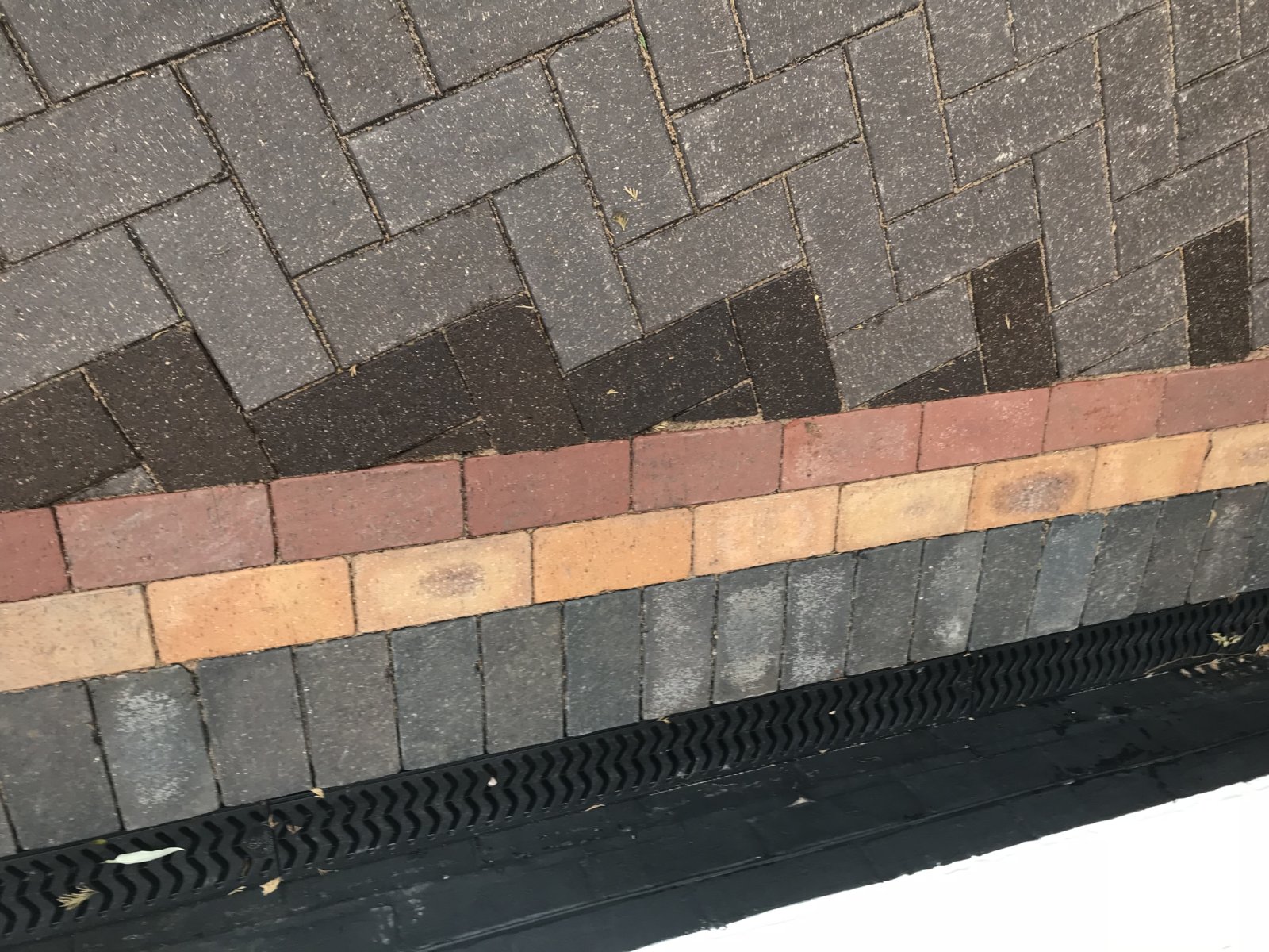

Too less of an amount of the new bricks were ordered, which meant additional bricks had to be sourced from another yard, these are visibly darker - as shown on the first picture.

Completely fifferent colour when wet, one is blue new is brown.

Pic above shows the extra pavers ordered. There are 3 different types of pavers now!
