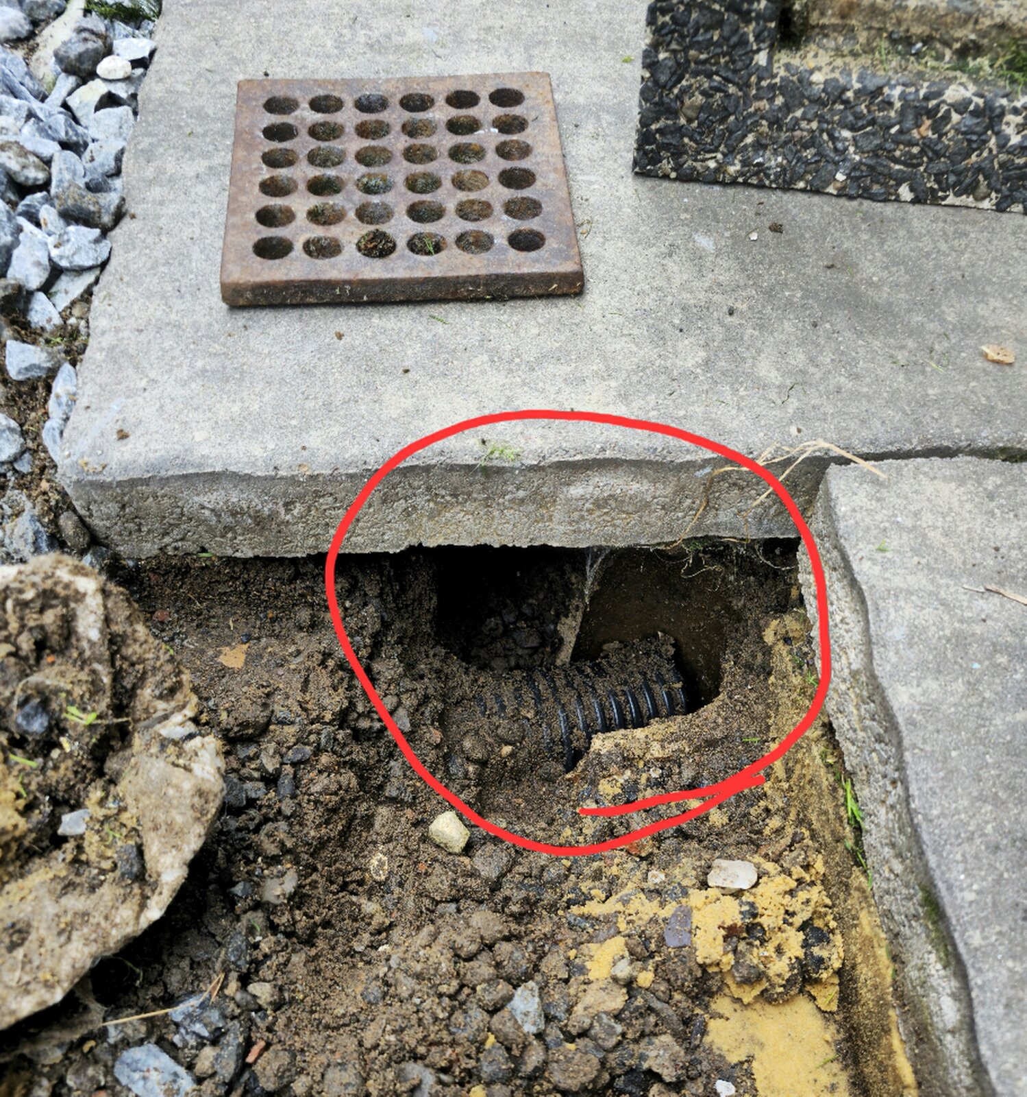

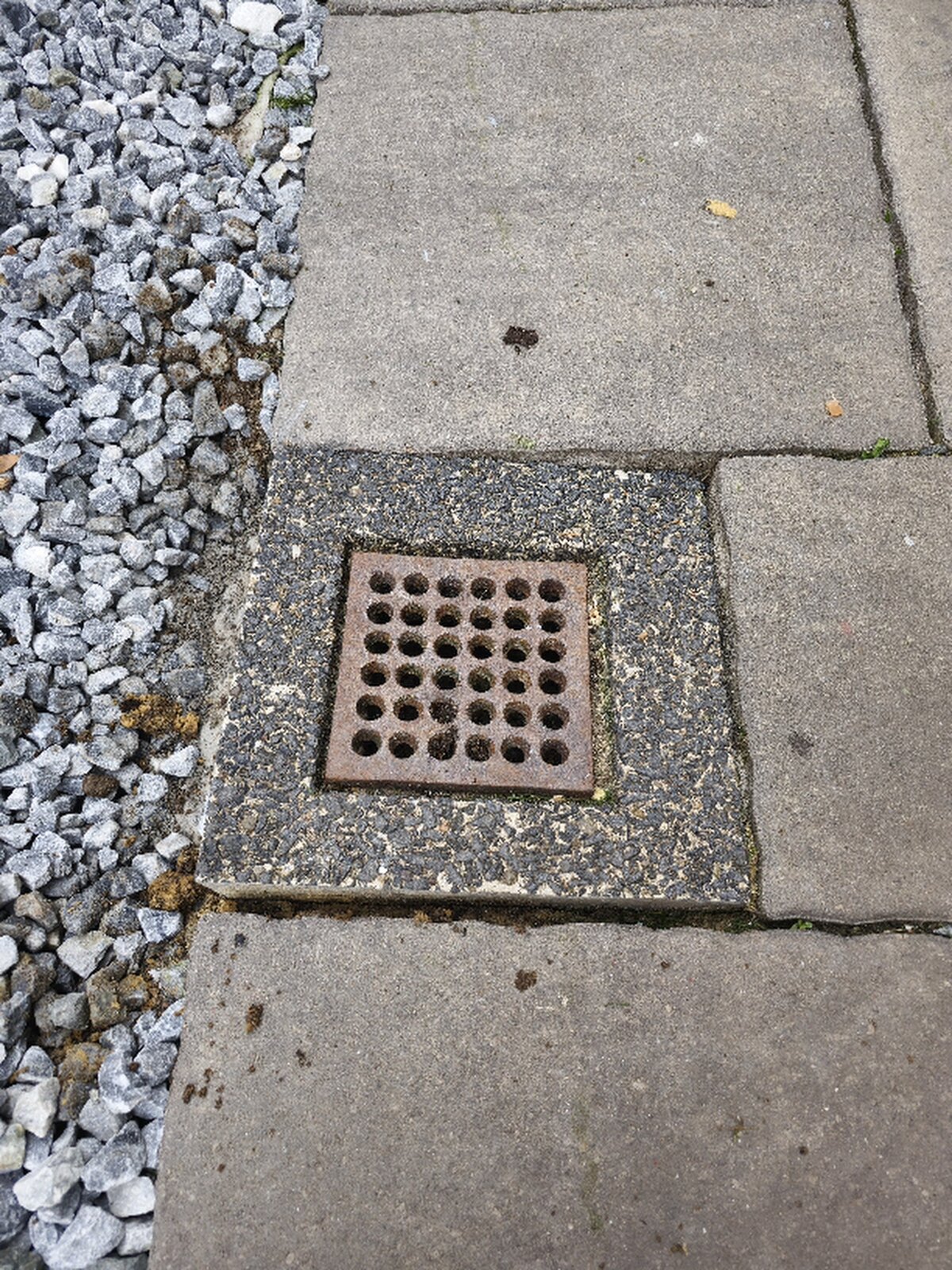

Hi,
So we got some landscaping done a while back and I've since noticed the drainage pipe for waste water isn't fitted correctly.
It turns out the clay pipe has been broken and the drain misplaced, a botch job indeed.
How can this be fixed. Can I attach a clay to pvc connector and run a flexible pipe of some sort to the drain. Or does this need a total refit, cutting a new drain into the slabs?
See images
Attach a rubber adapter so you go from clay to 110mm plastic.
Fit new drain.
Get digging back to good clay pipe
