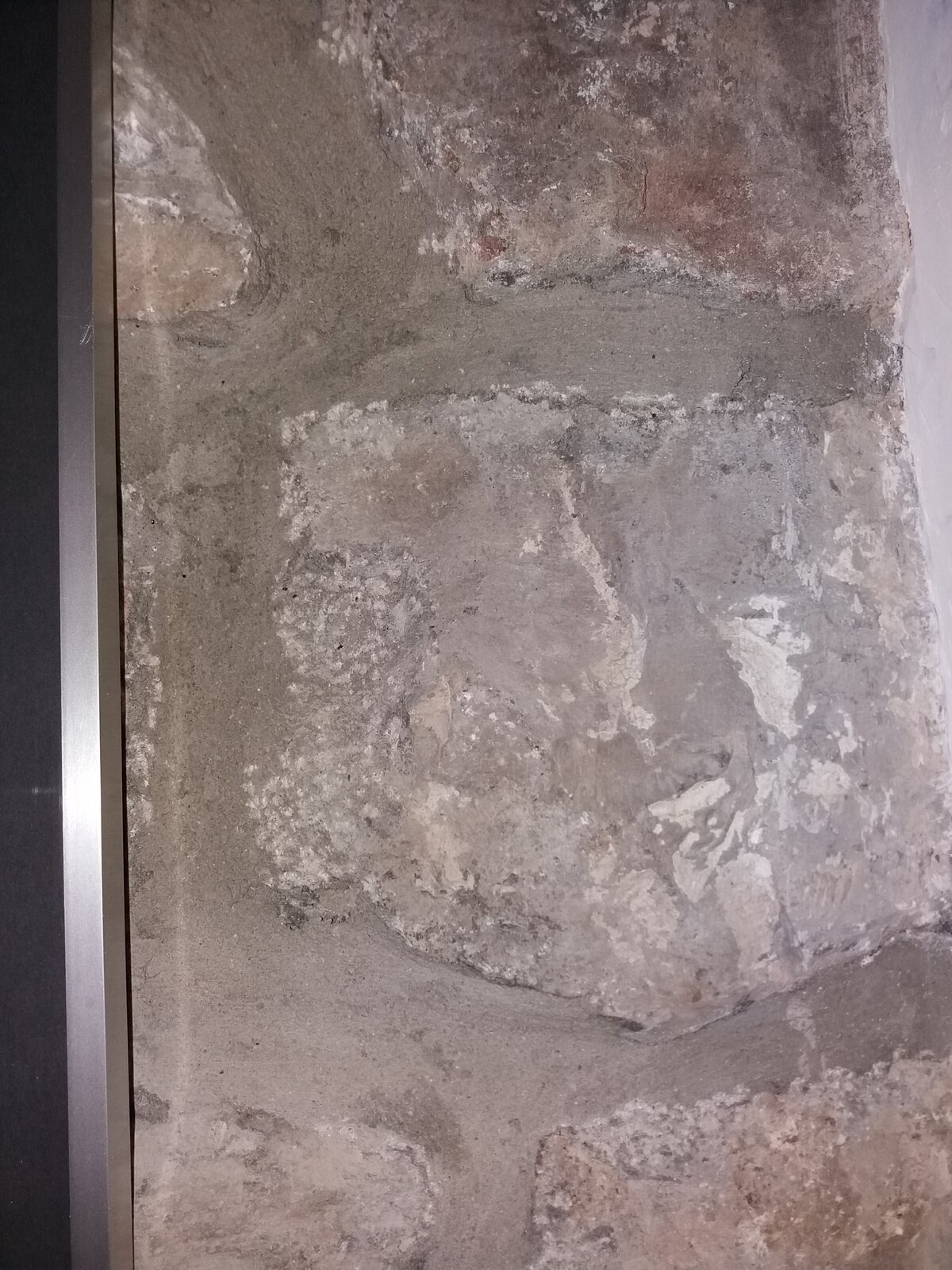

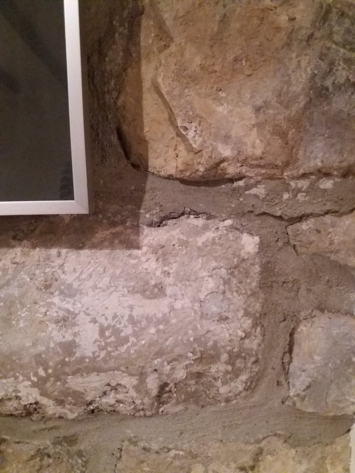

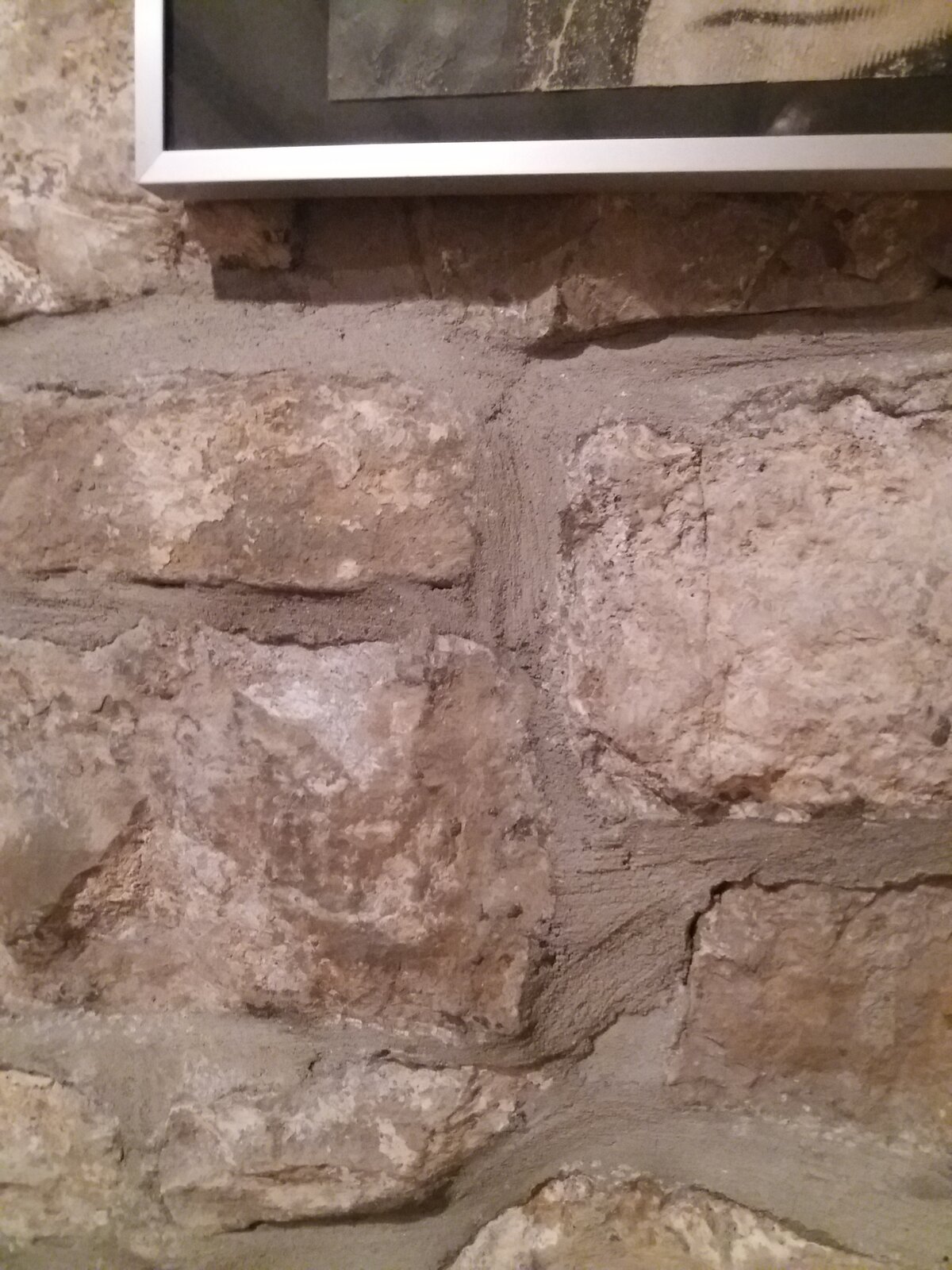

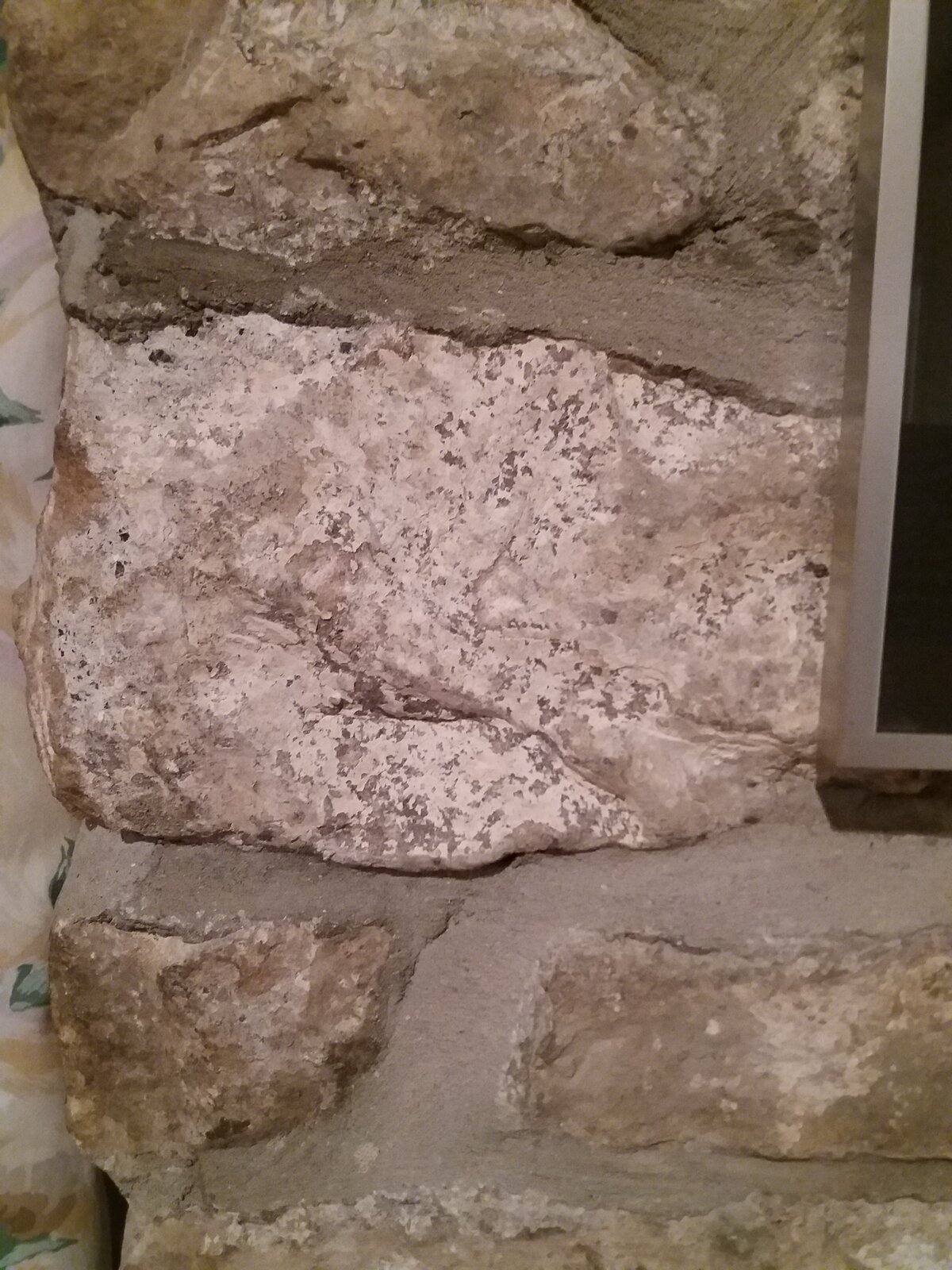

Clean old paint from interior stonework
30 Mar 2012
676
4
Monmouthshire
The stonework was reclaimed/repurposed from a much earlier building. Where there is paint it's chalky creamy and turns rust red if I try to wash it off with water. Will paintstripper gel take it off and wash down without permanently staining the stonework? Generally, I'd like to clean the stone surface using minimal elbow grease.
Thank you.

Try C-TEC PEEL TEC paint remover.
Test area. Supposed to not damage surface
