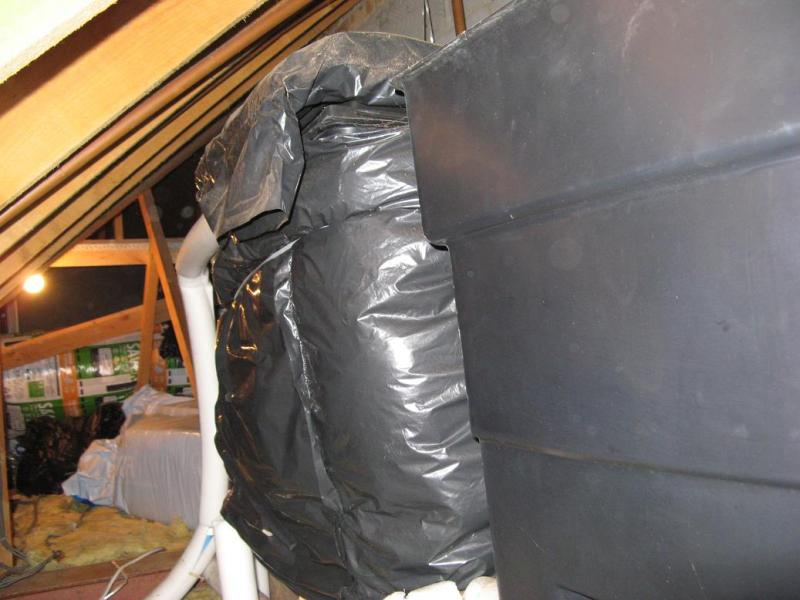

If so, I want to make sure I put it into the correct header tank! In our loft we have three. One small one and two larger. One of the larger ones is uninsulated and has no lid. I've never been sure whether it is actually in use or what it's purpose is. So aside form asking which tank to put the F3 into, it would also be helpful to know what the uninsulated/lid-free tank might be there for.... [Update - I'm going to deal with the issue of the two linked large tanks in another thread]
Here are some pics. This first one shows the two insulated tanks. The third uninsulated one is out of sight behind the large one.
A view looking the other way (so that the "hidden" tank is now at the front and the small one cannot be seen). Sorry for the crap angle but it's all a bit tight in there!

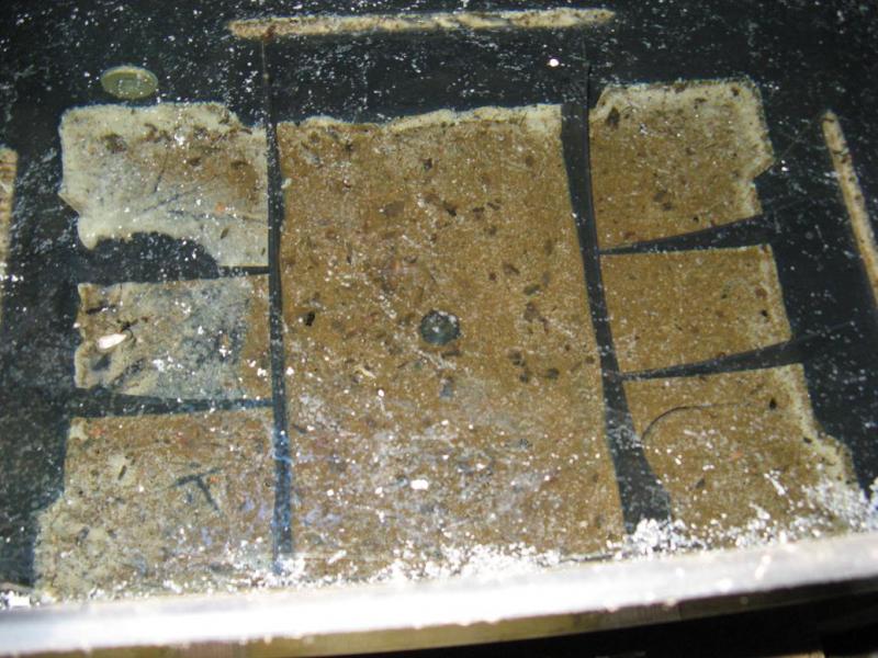

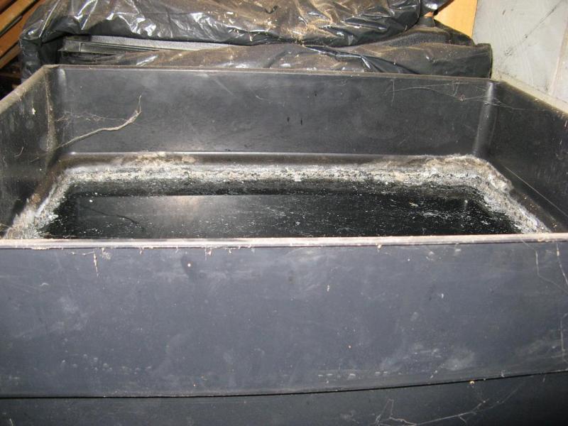

And here are a couple of shots of the uninsulated lid-less tank:

That look like two tanks coupled together. As the ballvalve is in other large tank, where is the outlets?
Also it should have a lid on it.
Daniel.

When I get up there I am going to take a good look at how the two tanks are linked and try to get a better understanding of what the heck is going on with those two tanks. Something doesn't seem right.

Bale out the tank first and sponge it clean. Wipe it round with bleach, including the lid and valve.

OK.... I've been up and now have a tank you could more or less eat your dinner out of!

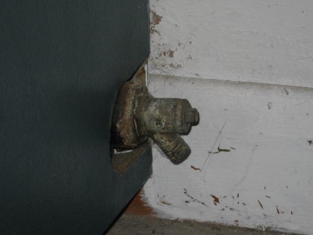

1. The draincock looks in a poor state... I'll load up a photo tonight when I get home. I'm a little worried about trying to drain from it and breaking it and wondered whether you think I would be silly to try - especially given the time of year and the chances of getting help should something go wrong.

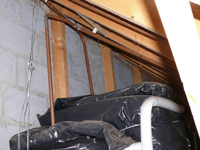

3. A quick aside question... Both the F+E tank and the first large water tank have vertical copper pipes coming out of them. What are they for?

the rubber washer in the draincock is likely to be perished. You can poke it until water comes out, but be prepared to fit a new cock. This will be fairly easy if it is compression fitting. Or just fit a new one near a drain or by the back door. A full-bore valve is even better as you get a faster flow which helps wash out sediment. I used a washing-machine valve, that you can put a hose connector on. Best to put it on a pipe stub so it will not get so hot in normal use. You can put a capnut on it as second-line defence against leaks.
You might be describing vent pipes, in an inverted "U" shape.

I'm a bit scared to do any of that to be quite honest. I may speak to the plumber and ask/plea(!) for him to pop by asap and change the draincock. I can then be getting on with the clean etc before he comes in early January.
Oh, and here's that pic I promised earlier:

Quite possibly... Here are a couple of better pictures. If they are vent pipes, what are they used for/how do they work?

Regarding the vent pipes, I understand now (I think). As the water heats up and expands, it increases in volume. The excess air and water as a result of this expansion has to go somewhere. It goes through the vent pipe back into the tank.
Is that right?
If so, mine look a lot longer than others I've seen! Hopefully they are ok though....
As a quick aside, it's funny... As I cleaned out the tank I kept wondering my there was muck and rust in there. I thought to myself "this tank only ever provides water for the system, water never comes back from the system to the tank, so how does all the crap get in there". Through the vent pipes I suppose....
It actually goes up and down the feed and expansion pipe, as it expands and contracts with temperature. It only rises up the vent pipe if the F&E pipe is blocked, or the boiler overheats.
Oh right, I misunderstood in that case. Thanks for clarifying. So it is there very much as a safety measure; a "just in case". As you have explained it, there would be no need to lag those pipes... Or would there for some other reason I have not thought of?
