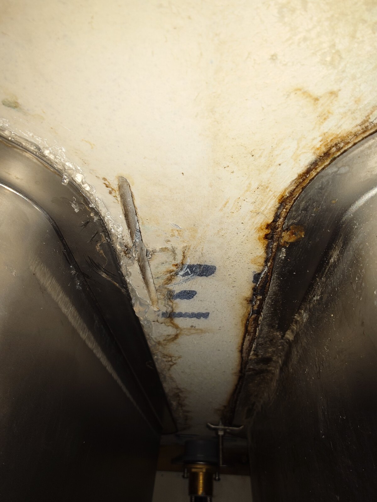

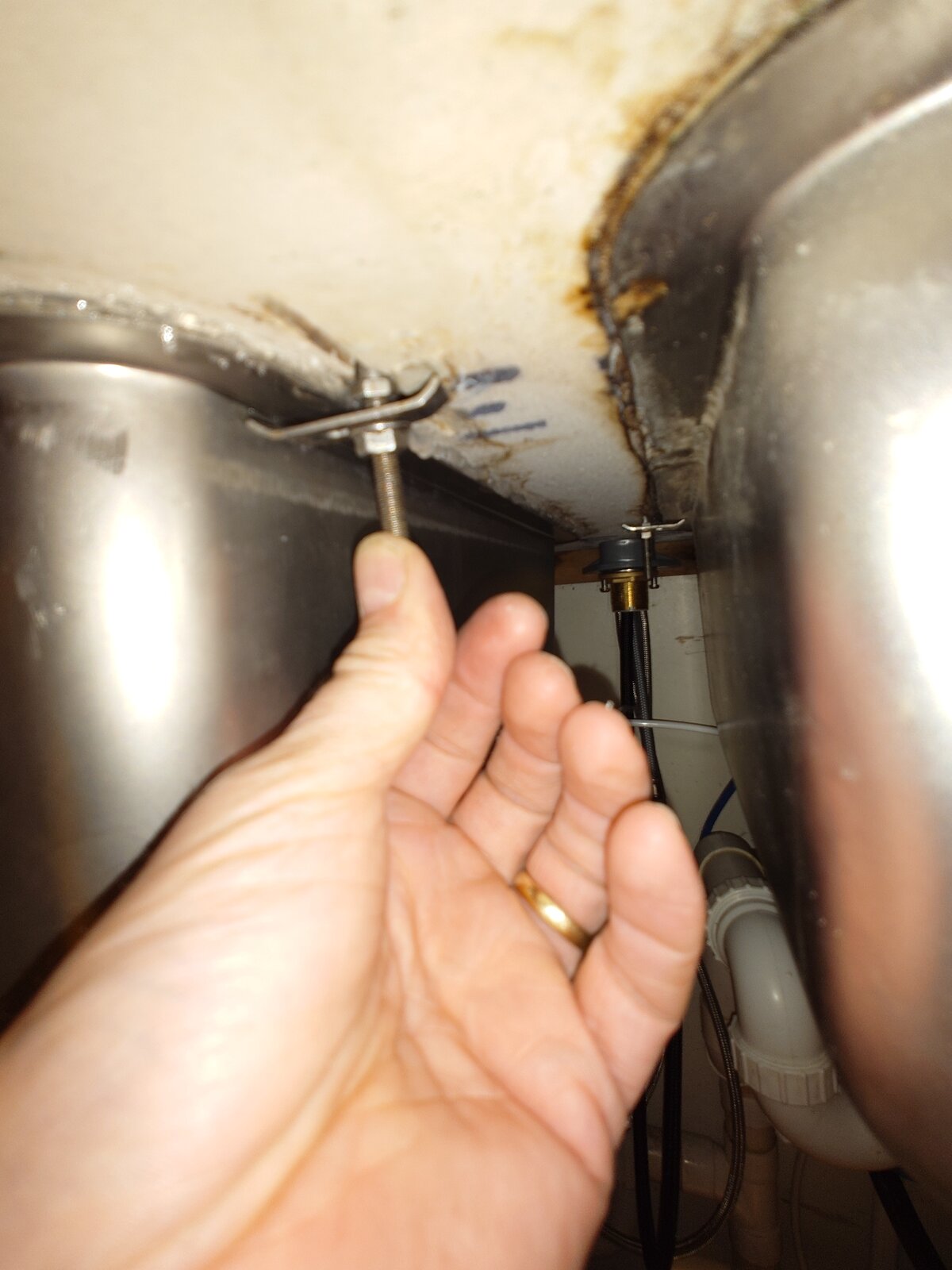

Had to re silicone around my under mounted stainless kitchen sink set in a granite style worktop.
I lowered the sink and when I did some of the clips fell out.
I couldn't get the clips to stay in place after that they kept falling out.
There is a small groove with a hole in the centre when the bolt part of the clip goes up into the worktop but I can't figure out what keeps it in place.
Should I get new clips and if so what type
See photos of current setup.

IIRC I used a small trolley jack and a block of wood to hold tne basin in place while the sealant set, then fitted tne clips in place afterwards. I also used some undermount sink brackets from ebay as I didn't trust tne sealant and clips, probably unnecessary in hindsight but gave peace of mind as it was first time fitting

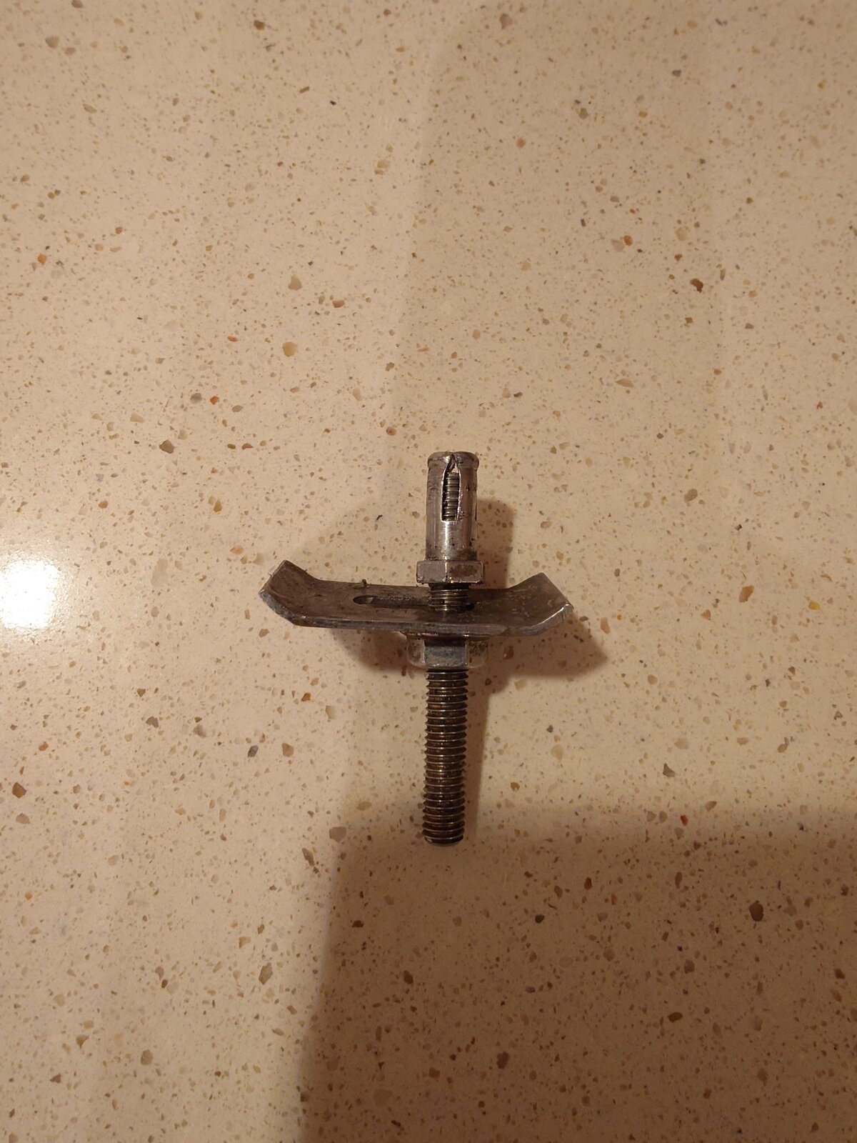

The threaded rod need to be tightened up into the expansion nut to spread the end out. Basically they are Rawlbolts without the head on the threaded rod
When I tighten it up the bracket clip just rotates around, the expansion nut doesn't bite.
So would I better swapping the threaded rod with a bolt or one with a head so I can tighten up enough to spread the expansion nut ? Otherwise I can't seem to tighten it.
Edit: have been googling and I came across drop in anchors - is that what this is ? If so do I need a setting tool to expand it before I insert the threaded rod?
I think it's basically worn out, so it won't grip any more. Not really drop in anchors as such, they are dropped into a hole in concrete and then use the spreader bar to hammer them tight, not what would happen on a worktop I wouldn't think. You may need to get the standard clips, cut a few new slots and use them. They are certainly the better type.
Thanks - what do mean by the standard type.
A lot of what I have seen rely on epoxy which I would like to avoid if I can.
Also, how easy is it to cut slots or holes into a stone worktop ? ( It's one of those reconstituted stone types I think, not natural stone, but for all intents and purposes it's comprised of stone)
