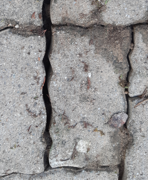

    Hi all,
    Cobbled 30+ years old drive slippery due to moss/lichen now jetwashed. Much cleaner, wow!
    Quite a bit of material dislodged from between the stones per attached. My understanding is that the stones now risk becoming unstable, and best thing to do is re-'grout' them, eg by spreading sand over the stones, brushing into cracks and hosing gently.
    Is this about right? What kind of sand (fine, sharp, etc)? Any tips on method (start from top/bottom - whatever)?
    Drive sloping, and used to park car so subject to considerable forces.
    Any tips welcome.
    Cheers,
    auto
    [EDIT: stones are 25x12.5cm]

    Kiln dried sand into the cracks - then later when the weather warms , a sand stabiliser - not a shiny block sealer . No hosing. Have a look at pavingexpert.com

    As Nige says - make sure its kiln-dried and sweep it in (diagonal strokes) with a broom - on a dry day!

    Hi Nige F and Halitosis,
    Many thanks for the prompt responses. Is there another term for "kiln-dried sand"? In Switzerland here and can't find a direct (French) translation.
    Cheers,
    AP

    No idea what it may be called over there but it is dried in an oven (kiln) to remove all moisture content. If they have block paving or driveways over there then I’d expect it to be common and available from most DIY warehouses or builders merchants. Should come in 25kg sealed bags to stay dry

    Silicone sand maybe?
