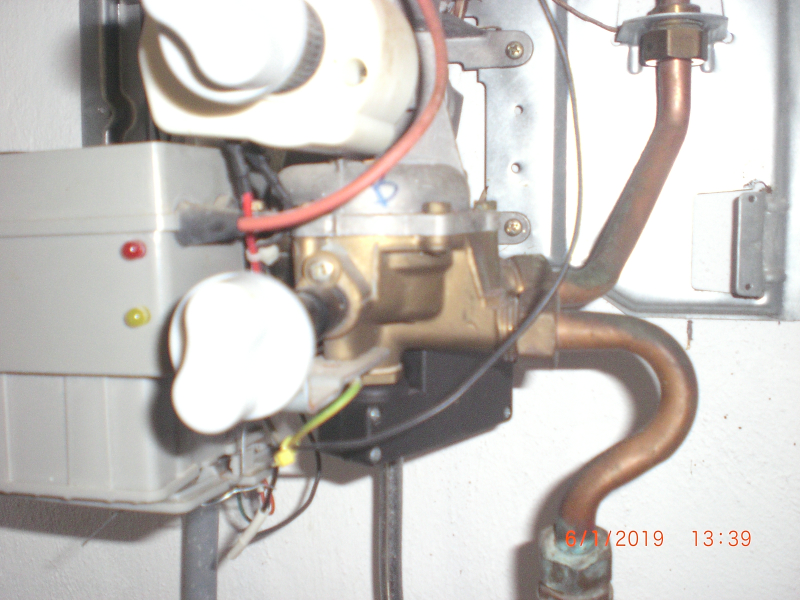

Hello folks, this is my first post.
My problem is that the instantaneous water heater is not living up to its name.
I have two Cointra heaters a COB 10 and a SIP-11.
The COB fires up the moment a tap is turned on, the SIP has to think about it for a good 30 secs before ignition which justs wastes water.
I have done all the usual checks like de-liming and checking the flow which are OK. The batteries are OK. So I think it might be the diaphragm that may have gone hard.
Has anyone had a similar experience who can help? All suggestions welcome.
I have tried to source a new diaphragm for the SIP but have found it impossible. Ferroli/Cointra simply are not interested and many of the usual caraven dealers don't have anything either.
I am reluctant to strip the valve until I have got the new bit since it does actually work. The valve on the SIP is totally different to the COB and somewhat bigger where the diaphragm goes.
So, I am open to all offers of help.

I don't think that's a UK model, so I doubt you'll get spares for it without importing them directly from Spain
Thanks muggles. You are right, it came from Spain. I have tried Cointra/Ferroli direct in Spain but have not found the right place to ask as yet, so I am struggling. The place where it came from was no help either. Typical of Spain they just want to sell you the stuff but offer no after sales help. The last thing I want to do is replace the heater because of a £3 part.
If I get the part, rest assured that to change it requires no intervention into the gas side, see picture. Just removal of the screws in the brass bit and two water pipes.

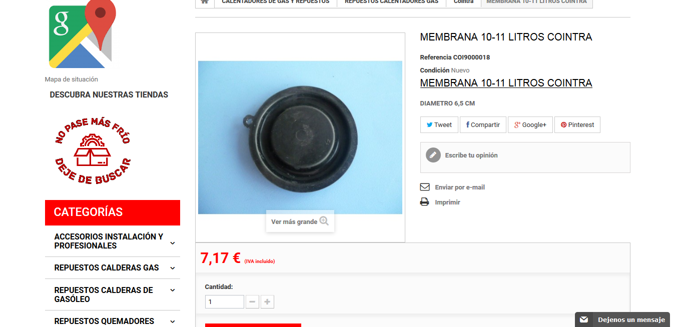

Ref your previous post, they have identified what I need which is a 65mm dia diaphragm, so I'll get one on order.
Here is what they sent.
