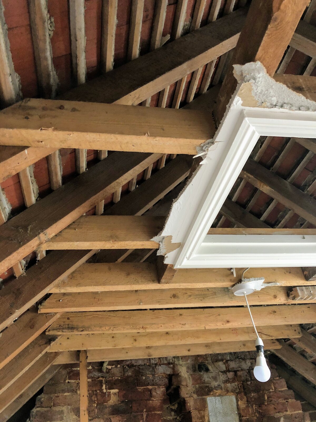

Just after people’s opinion on best way to remove these beams? A structural engineer has ok’d for them to be moved up, but unsure as to how to remove.
should I hand saw flat against the roof rafter then try and remove the small piece that’s left?
And then would these be good to re-secure them https://www.screwfix.com/p/turbocoach-coach-screws-yellow-zinc-plated-10-x-160mm-50-pack/27508
Or something else?
thanks
Move these one at a time. The old one can be cut out with a recip saw and cleaned up with a hand saw if needs be then reinstalled in the new position, although I am surprised that your SE didn't specify replacements in something like C24 softwood. The coach screws you reference should do the job. Personally I'd prefer to use coach bolts
