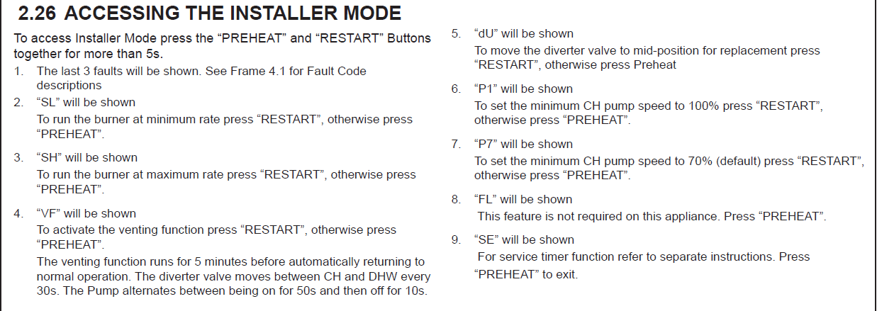

Have you done the obvious and vented all the rads with boiler off?. there is also a automatic venting function, see below. I think the boiler has a 7M pump which is automatically controlled but you can set the minimum speed to 70% (it may have been set to 100%) which may help to reduce the hissing, see below.
