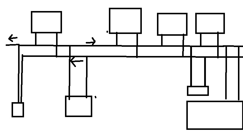

hi all brought my first house not long ago which was fitted with a worcester bosch 28i junior combi. the old boiler used to be a back one so alot of movement took place
when i moved in some radiators were boiling some not so
i took advice from my grandad who used to be gas safe years and years ago before combis and has fit a few in his time
i learnt how to replace all the radiator valves as nearly all for the 8 rads leaked when turned
i replaced the rad in the front room with a new double one.
problem im having is the temp from the kitchen radiator is at least 15 degrees hotter then the front room. i have tried balancing but doesnt make much difference
this is a small crappy pic of the layout. the boiler runs flow and return 22mm but above the boiler it joins the existing single pipe system and reduces to 15mm all the way. the hallway radiator hardley ever works and it it does its because the radiators have turned off. trvs elsewhere
i have read that the return flow must be below 55c for the boiler to condense properly i get to this return easily.
i have to turn the boiler up to 6 or max to get any decent heat in the front room rad but means the return to the boiler is super hot
there seems to be a weird pipework to the downstairs rad too but cant be rectified
all the radiators downstairs run from upstairs. the front room and hall wall dont feed any return to the boiler. if they do its very luke warm
my grandad has said to replace the lot with 22mm simplify it a little and run 15mm to the rads. will this cure my problem?
just to let you know all the rads work just some are no where near as hot as others. the ones at the end of the line
many thanks for your suggestions

in the pic the arrow to the left is to a rad by the boiler in the toilet
the diagram doesnt show any weird t pieces that are scattered. all pipework is 15mm
problem I'm having is the temp from the kitchen radiator is at least 15 degrees hotter then the front room.
If you are referring to the return temperature, that is not unusual. It is common for a kitchen radiator to have a much smaller output than a lounge radiator, so the water looses much more more heat as it passes through a lounge radiator than a small kitchen radiator (it may be 4 times as much for example)
With balancing you may be able overcome it to some extent if you can decrease further the flow rate through the hotter radiators, so that more goes to the cooler ones.
the temp is the heat coming off the radiator i used a probe. or the temp of the radiator itself
the lounge radiator is helped by higher temps on the boiler but balancing means i end up turning the rads off rather then getting a good temp at the rads near the end with the rest on luke warm. im sure its down to pipework myself i seem to see 22mm across is thr norm then branch off 15mm to the radiators

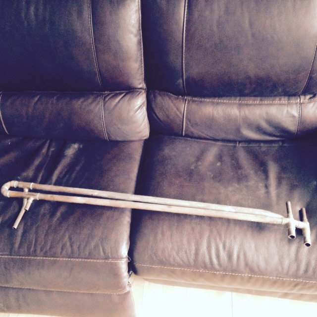

just to give some feedback on this. with the amount of t pieces we decided against ripping all the pipes out as they run under the bathroom which wasnt accessible
we decided to cut the 22mm section out and fix the piping to the front room
when we stripped the floor boards up we found this
seems as though someone cocked up and fed any flow back to the return
we simplified the front room piping as i wasnt happy. cost £50 and a days work replumbed all the 22mm in the main flow and the radiator to the second bedroom
its all 15mm now. the hallway radiator that never worked very well works fine the front room radiator is red hot
ive turned the boiler down by about 3 settings and the front room still comes on :)

What you show is seen frequently, and was not the result of a 'cock up' it would have been done deliberately when the system was installed to maintain the correct flow of water around the system and through the boiler.
that would make sense but this is the second radiator near the boiler which doesnt make sense at all. the tank was removed and some piping kept which is where i feel the issue was as it looks like its all been joined together
i now have a much lower return temp on the boiler but red hot rooms wherever i desire.
the front room and hallway come on instantly now and a temp increase happens very quickly even on a lower setting on the boiler
im aware it will use more gas but i dont have cold rooms now
having read up on the web there should be a bypass fitted. theres not and this bit of pipe didnt have one
it says if the furthest radiator is fully on which it is that will surfice.
seems bypassing via a radiator doesnt seem popular anymore
Yes it did, it's the 180 degree bend shown in your photograph showing the pipe that you cut out. It joins the flow and return pipes together.

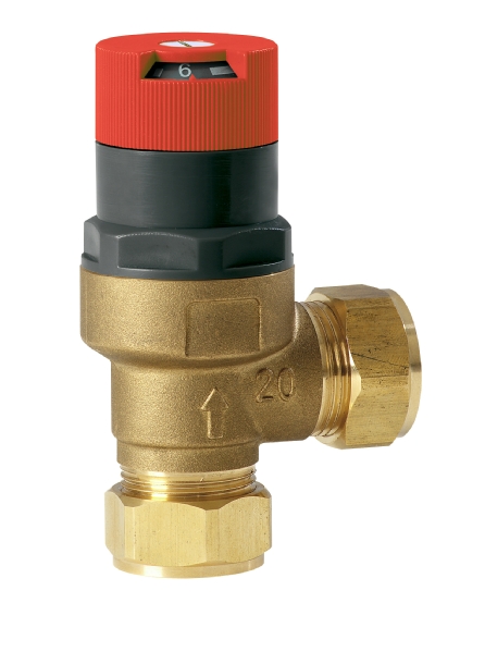

That would only be OK if the radiator doesn't have a thermostat (TRV) fitted and has lock-shield valves at both ends so that it cannot be turned off inadvertently.
Seems bypassing via a radiator doesnt seem popular anymore
Because an open pipe connection is uncontrolled and can divert flow away from the radiators unnecessarily, many systems have automatic by-pass valves fitted instead, they open only when a by-pass flow is required. They remain closed when there is sufficient flow around the radiators, like the example below.
thank you that makes sense. as the last radiator is in my bedroom its set to 5. i renewed all the radiator valves and my bedroom does have a trv. i will take it off and fit a lockshield cap. the lockshield side is fully open

It doesn't have to be the last radiator on the circuit that is used as the by-pass. It is normally the radiator in the room where the room thermostat is located, often the hall or the lounge. That way the room thermostat controls the temperature in the room where it is located, and the TRV's look after the other rooms. With what you propose, you could end up with a very hot bedroom.
By the way. Not all boilers need a by-pass. The manual for your Worcester Bosch (or someone who knows the model) should be able to inform you. The by-pass would probably have been a requirement of the original back boiler installation.
