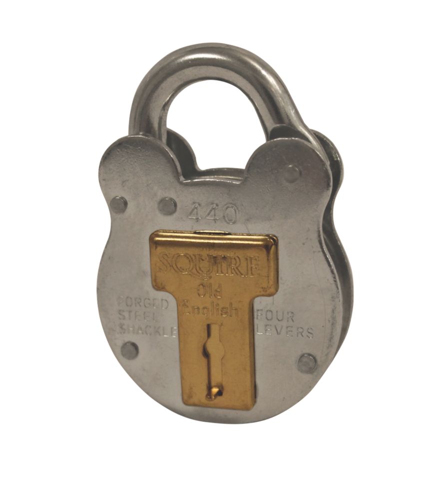

Squire 660
I use them in a similar location.
It looks old-fashioned, but inside the galvanised case, it has a brass mechanism. You can wash out the dirt every five tears or so in paraffin if you want. It is a 4-lever lock. Last 20 times as long as a typical cylinder padlock.
It's the brass moving parts, and the large size of the internal components, that makes them resistant to corrosion or jamming with dirt or grit.
If you spray-paint the outer case, it will extend the life of the galvanising (which eventually weathers away)
You are just going to have to put up with keys. You can get several locks suited to a single key if you want. This is very convenient. Ask for the same PES number (a proper locksmith will be very familiar with this).
You could also get an "FB" (fire brigade) padlock, which is similar, but not very secure as it has a standard key.
You may sometimes see other heavyweight padlocks with a brass-lever mechanism, they are sometimes used on roadbuilders sites, suited to the same key for convenience. Screwfix used to do one, I think imported from India.
ERA make a 5-lever and a 6-lever "Insurance" rated padlock, at a higher price

64mm Squire 660

When your next padlocks stop working, buy a 660.

I have had a number of Squire locks and, whilst being pretty good, they can be fairly easy to pick the levers.

The Squire is the only one I have experience of, that has given me a 20-year life, exposed coastal, and still working.
