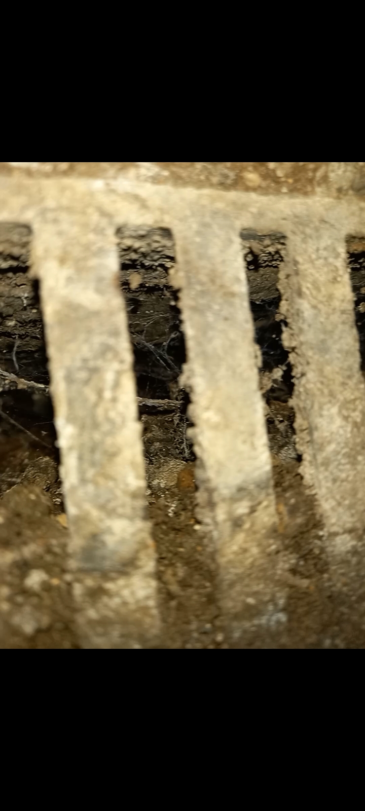

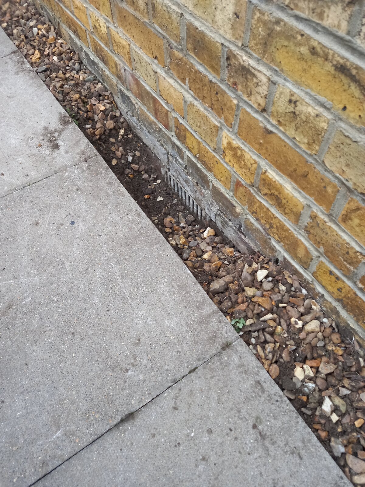

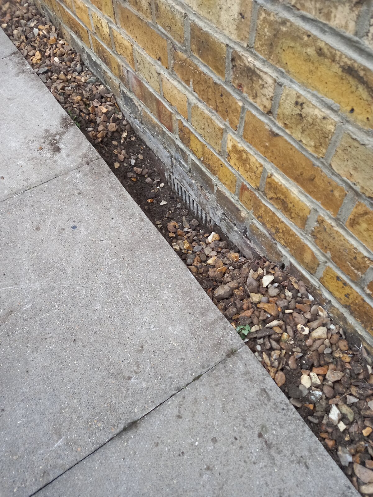

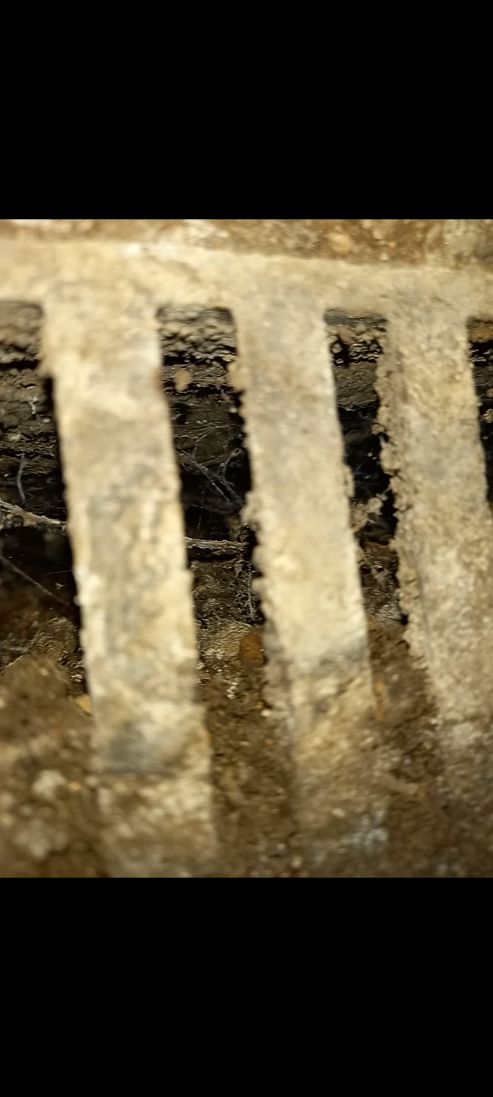

Hi, I am trying to better understand the flooring in my home and hope some expert advice will clear things up. I have dug down the side of my Edwardian house that was covered with pebbles and found the air bricks way below ground level. My internal floors are concrete and means I wouldn't necessarily have to have air bricks open and uncovered.
But what I don't understand is that inspecting in the air bricks is a void space. The air bricks are open and I can see earth and cobwebs through the air brick slats.
I know there are issues with high ground around my house and the driveway was built on top of the previous one by the last owner. See photo.
I am trying to prevent any damp or major problems from lack of ventilation or water ingress into the void under my house. Any advice appreciated.

But could I cover them @Mr Chibs ? As I plan to run aco guttering along the chanel pictured to reduce ground height and divert rain water to sewer rather than accumulate in a trench. This area was also badly hit by the 2020 christmas floods, another reason for the Aco.

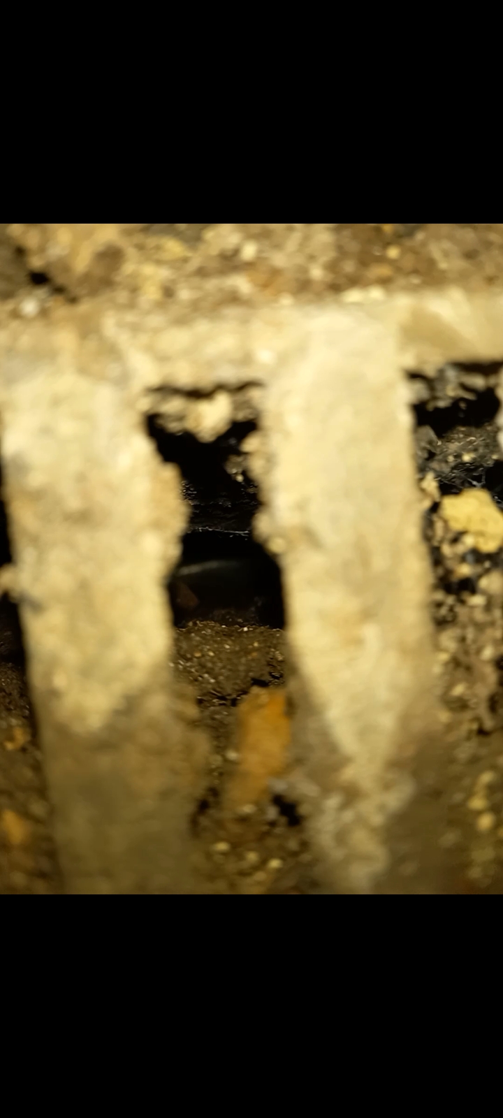

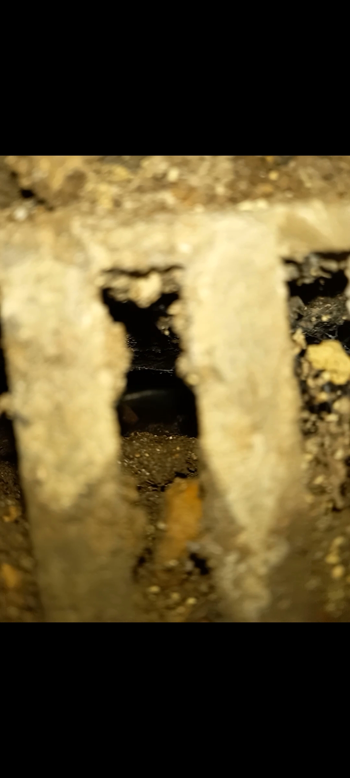

Definitely a void space @sxturbo which can be seen through the airbrick (in the screenshot above).

@Mr Chibs it is difficult to push a garden cane in as the vent gaps are narrow and the ground is high so cannot get the angle. But a 15cm screwdriver goes all the way in. I would say a cane would. There is lots of earth in there and the void is only 1 course deep, so either poor backfilling or no backfilling?
Photos are difficult but you can see quite far back on the photo attached.
