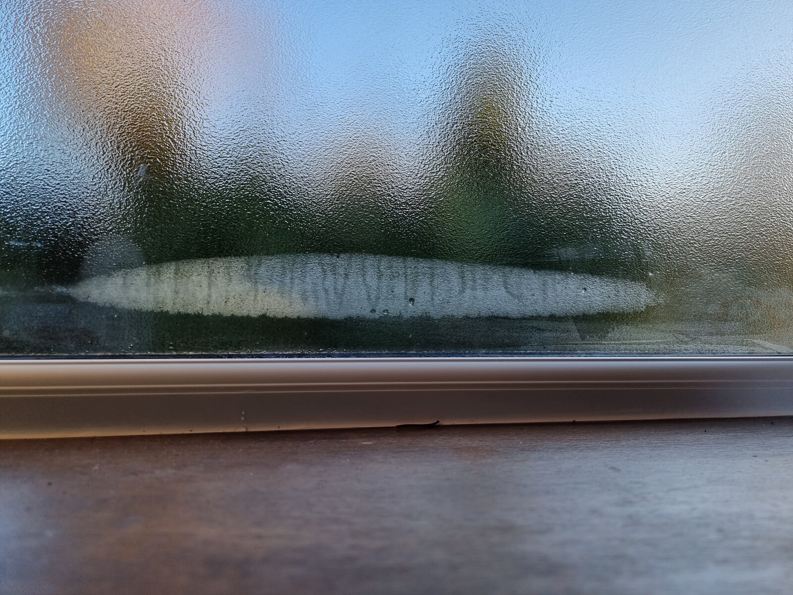

I've lived the same way for many years and never had a condensation problem before until i got new windows to replace the old double glazed windows. Also I don't have any problem in the room where my gas fire is nor in my bedrooms.
Get in installers back. The glass needs changing.
I was going to do that but this morning the condensation inside the glazing that I'd photographed had gone! Maybe cos the room's been warmer as i had the heating on last night as it was so cold. I know I hadn't imagined it as I'd taken the photo but I can't get them back when there's nothing to see so not sure what to do.
Also a neighbour suggested that the condensation could have been outside, is that possible? As it's gone now I can't check that unless it happens again.

Mine and next doors windows this morning
Likely a manufacturing fault.

As Crank says , majority of sealed units are not vacuum , just normal air . Vacuum sealed units do exist but are normally very thin and used in particular ' heritage ' situations.. as goes the Argon gas , again Crank is completely correct, on average the Argon is gone within 5 years ( no way of testing it less you have an expensive ' spark tester ' ).
ANY condensation between the two panes of glass is a failed sealed unit ...100% , it may dissipate but its still a failed sealed unit
Any condensation on the outer pane of the sealed unit ( literally outside) , is a side effect of modern double glazing and is perfectly normal, and showing that your sealed unit is doing its job.
Any condensation on the inside of the property is from water vapour , caused by many things, modern sealed units may still create a bead at the bottom of the glass... modern double glazing DOES NOT eliminate condensation despite many thinking it does. Condensation is best dealt with by Purge ventilation (opening a window ) , or dehumidifiers, or PIV/MHEV systems
