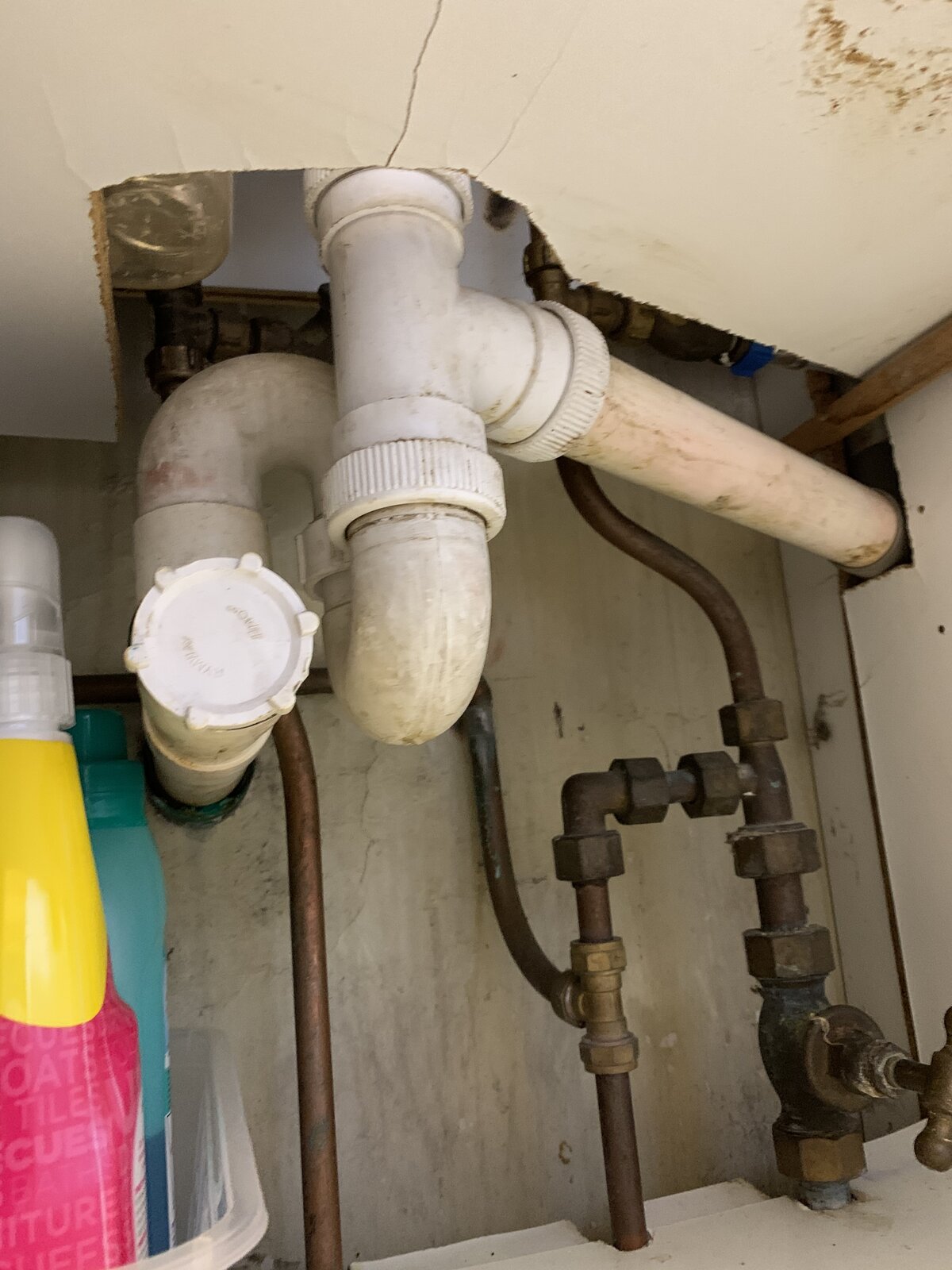

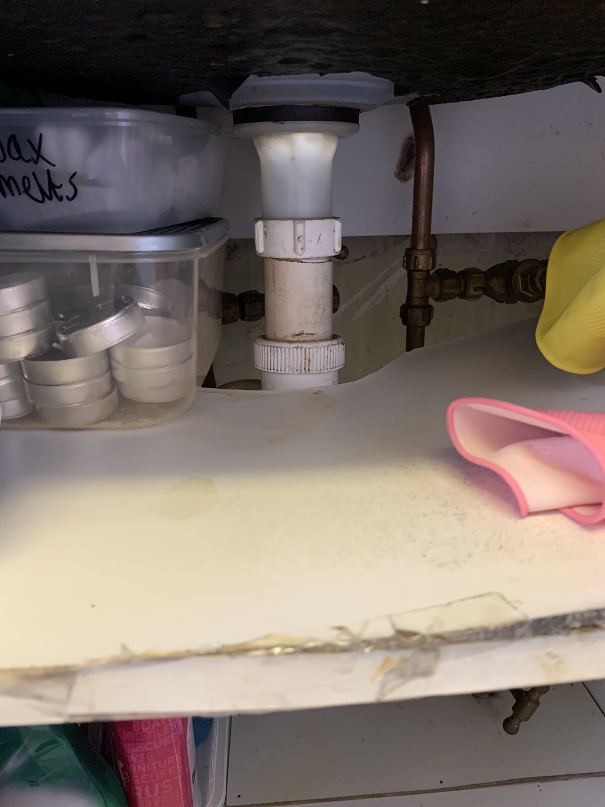

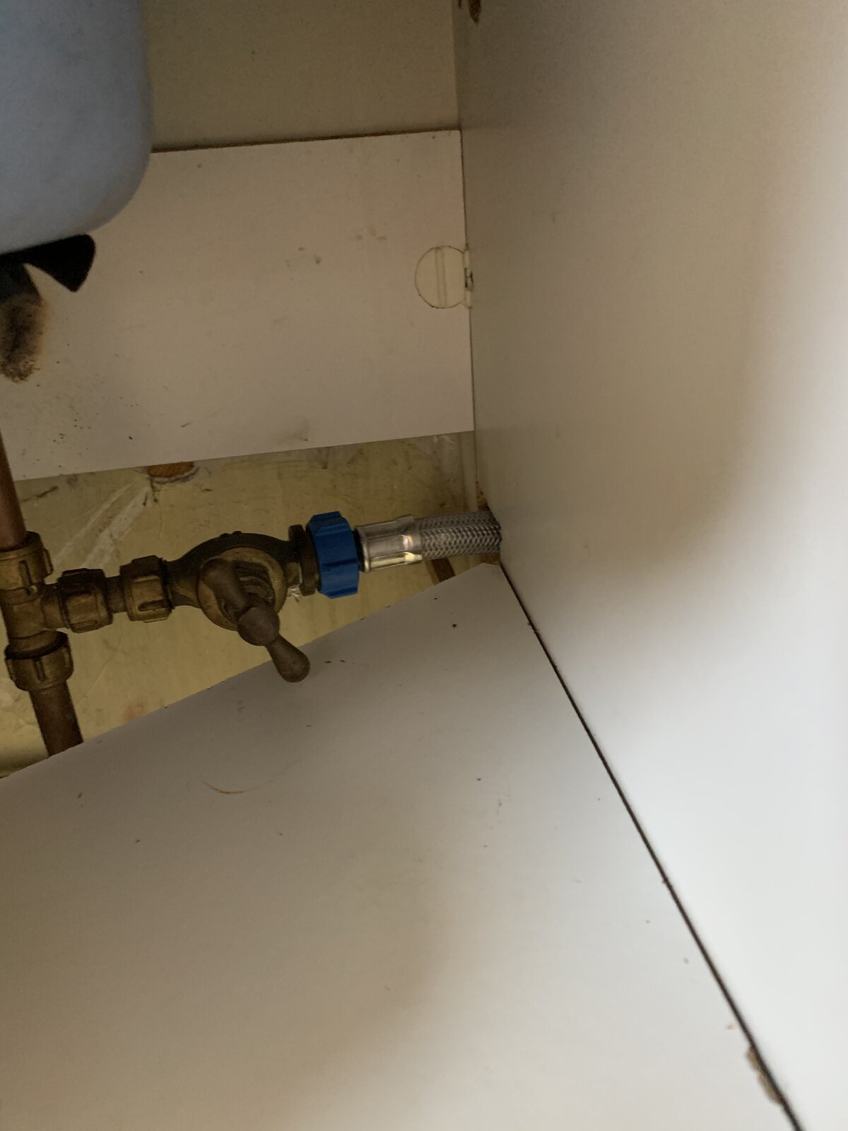

just moved into a new house, fairy dated looking to connect up a dishwasher temporarily for a month or so until kitchen is re done.
attached photos 1-3 are the existing set up.

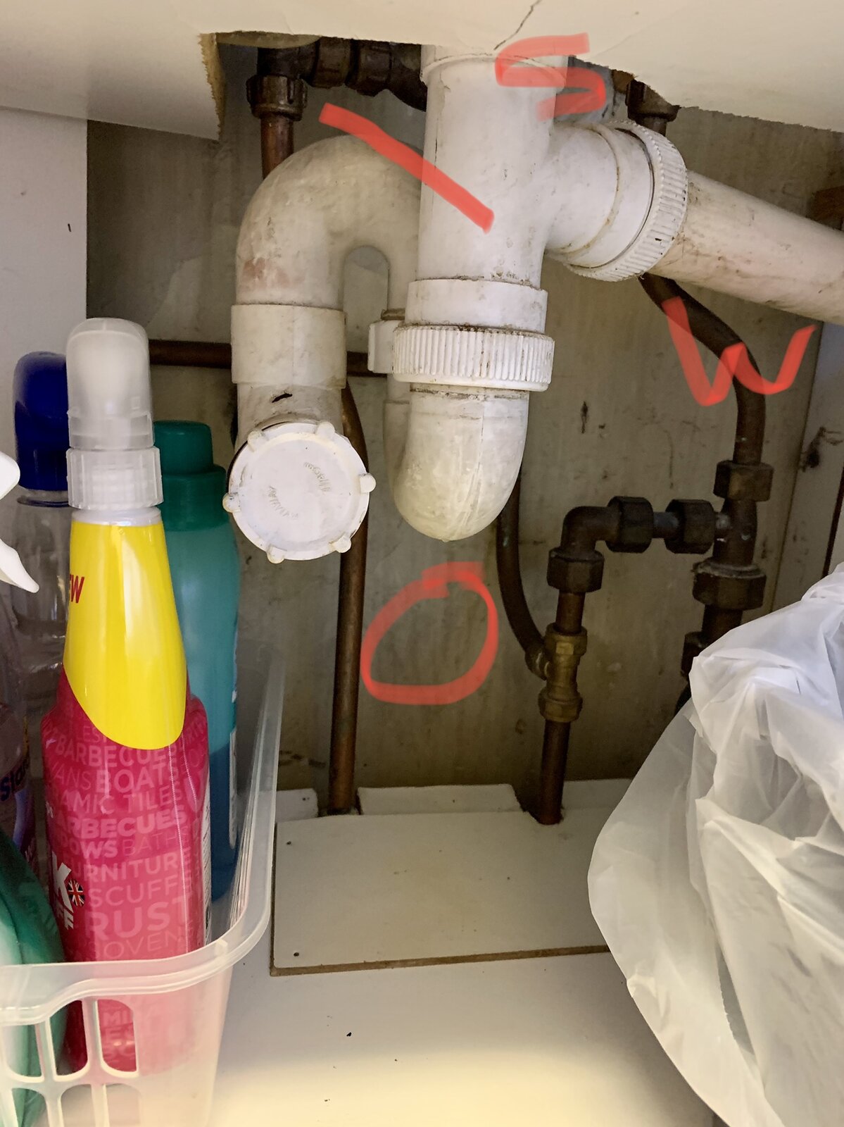

photo 3 is the a T piece like this you can buy with a dishwasher feed?

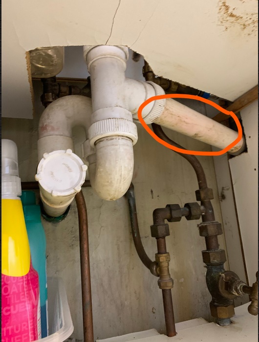

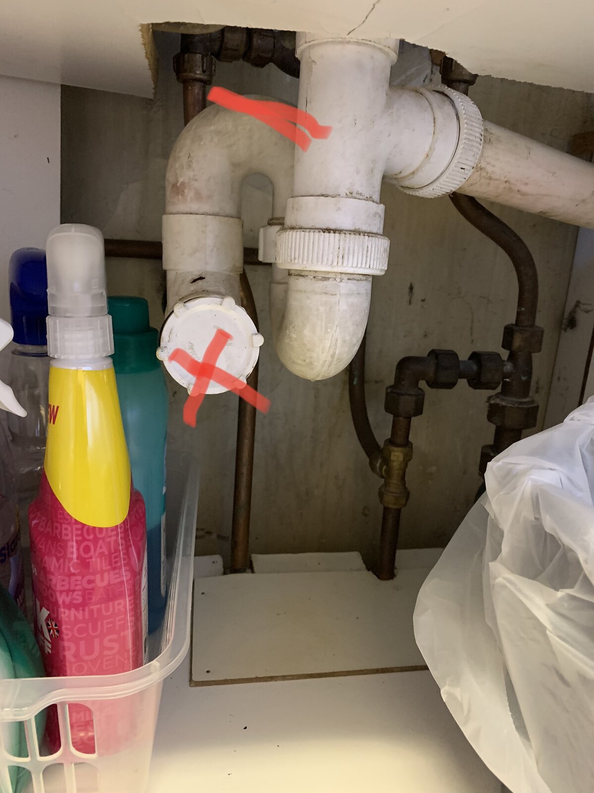

photo 3 where the X is this appears to be capped so would something like photo 4 do the job?
any other ideas?

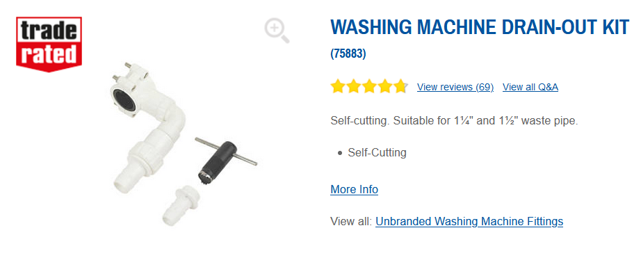

photos 5 is where washing machine feed connects, so think photo 6 will solve that issue?
thanks

The x marked cap is the rodding access, to allow the pipe behind to be cleaned. You wouldn't use the double fitting you linked to, that's for the top of a standpipe. If you could get it to fit (thread/size etc) the fitting you would use would be this
th
As far as the cold feed is concerned - you can take off the WM feed, cut a larger hole through to where the appliances are for the supply pipes and fit one of these onto the tap end
th
Thanks for the info, yeah I should have said a single version of photo 4.
ok so I can’t use the section where X is. What fitting would I need to take dishwasher drain, sink, washing machine drain and then the out flow.
the existing looks to have washing machine drain pipe, sink and out flow in a T piece so I need to change this to include a dishwasher feed?
marked photo as S - sink W- washing machine, O outflow

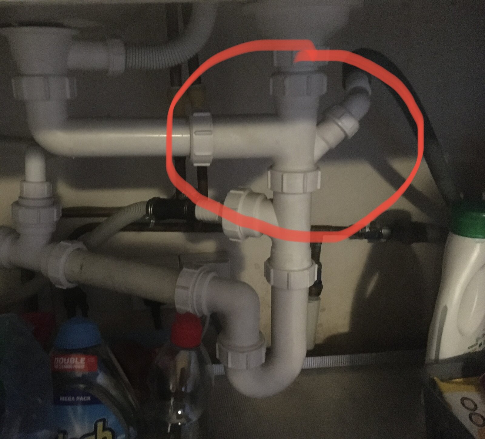

Anyone know where I can get this from it what it’s called? It’s what I was thinking as I meantioned in earlier post
red circle what I need I place of blue circle T piece

Thanks for that, thats the piece, however really just need the T piece section anyone know if you can get that save spending £20 odd for a part that’s prob £5 off
