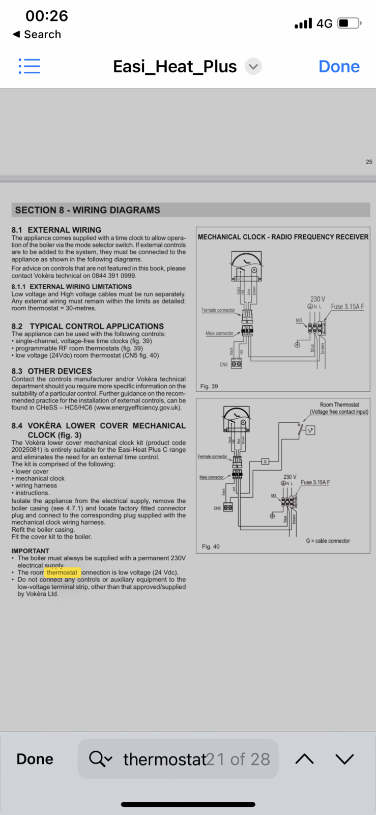

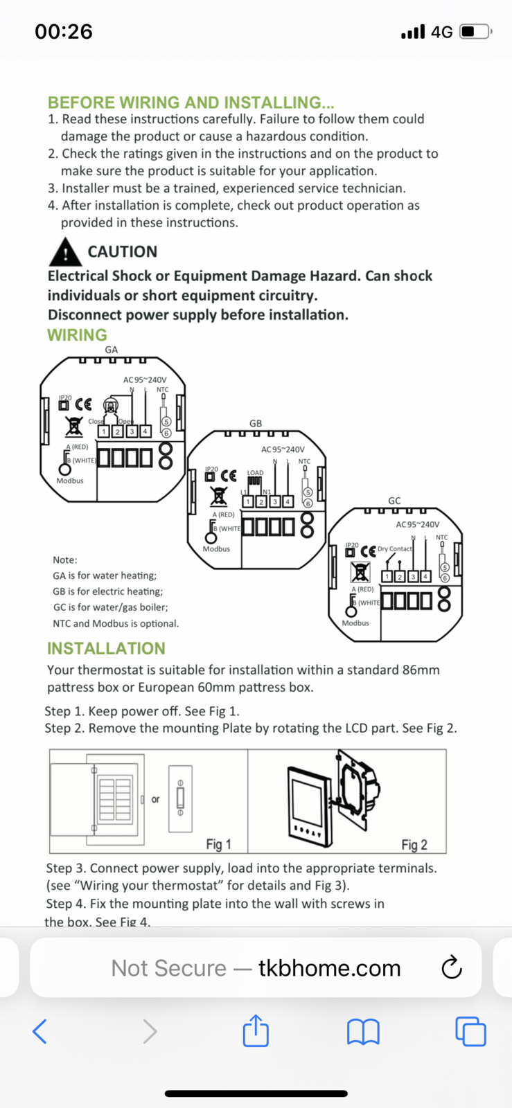

Hi all,
What cable do I need to run from my thermostat to combi boiler? Will only be using the thermostat for radiators.
0.75mm² is the usual choice. 0.5mm² theoretically could be used, but is very thin and far more likely to break.
Larger sizes will be more difficult to install as the terminals on thermostats are usually tiny.
