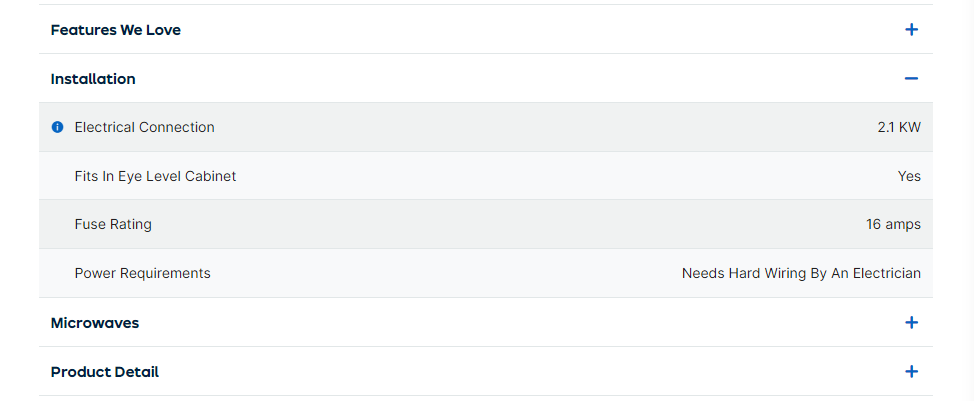

If we went for this microwave....which says 16amp / 2.1kw / needs hardwiring.... Can this be connected to socket circuit ? the 16Amp bit has thrown me as I thought 2.1kw would translate to less than 13Amps.
https://ao.com/product/zvenw6x1-zanussi-microwave-stainless-steel-75420-50.aspx
2.1kW @ 240V is 8.75A so can be supplied through a socket and plug - with a 10A or 13A fuse.
2100/240=8.75.
Stating it requires a 16A fuse is pointless and misleading. There are no 16A fuses for commonly used accessories in the UK.
As I said, what there are, are 16A circuits in Europe.
So all your worrying about 16A this and 32A that is no indication of what you actually require.

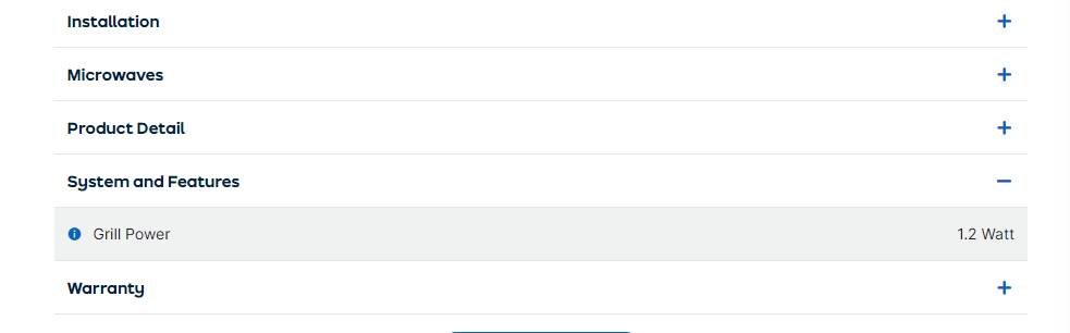

The description I see shows it is a 1000W microwave and grill. Electrical rating 2100W
1000W μ ~4.35A assuming same losses ~5.1A. (4.9)
Is there any chance it's a 2.1KW grill at 9A ? (1100W doesn't seem much {our cookers top oven dual grill measures 5.3/8.2A})
Total 14A?
This is guessing as something doesn't seem to add up.
