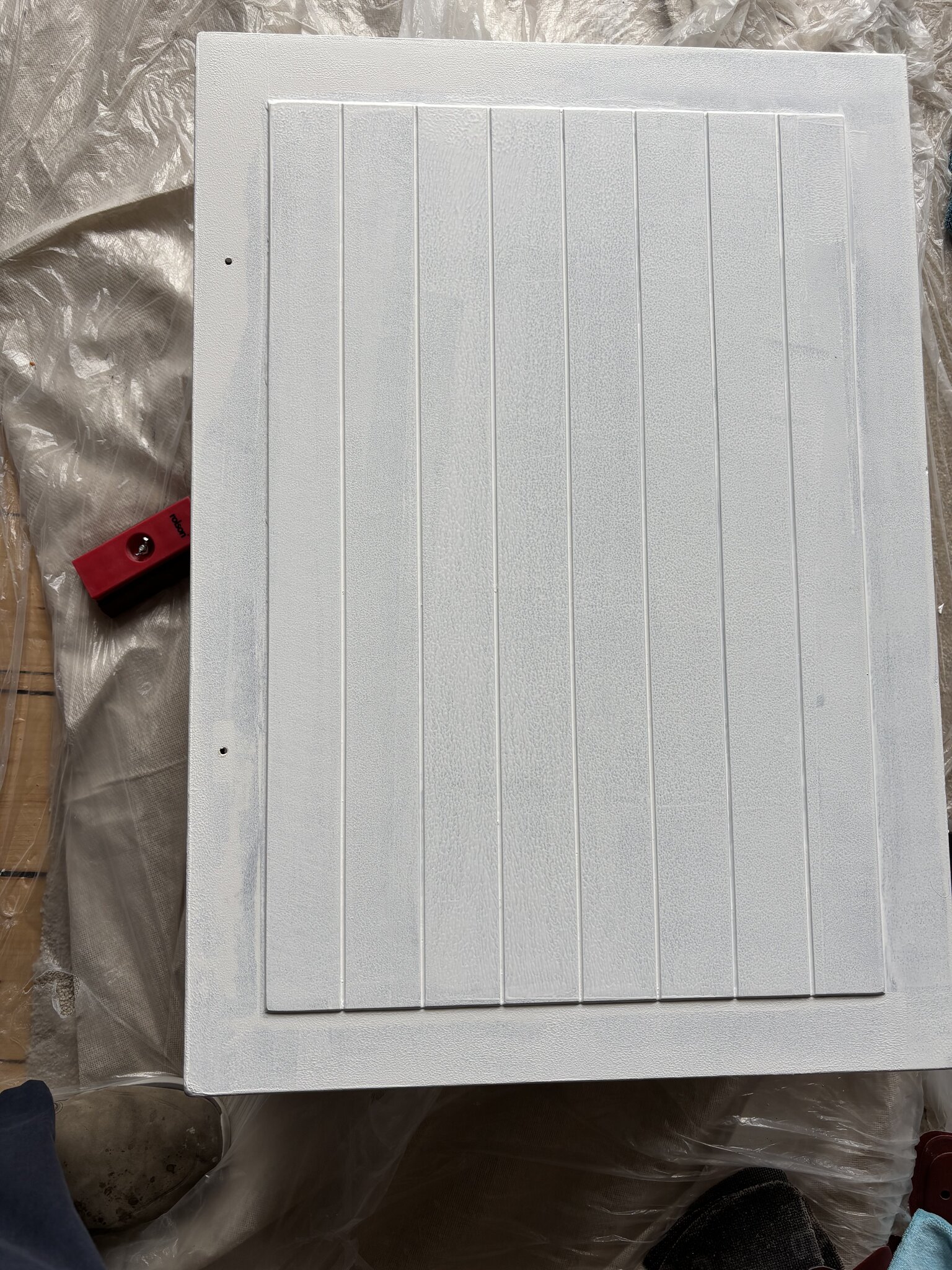

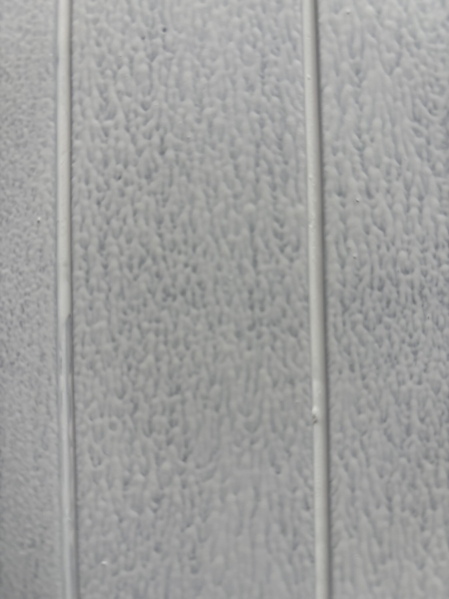

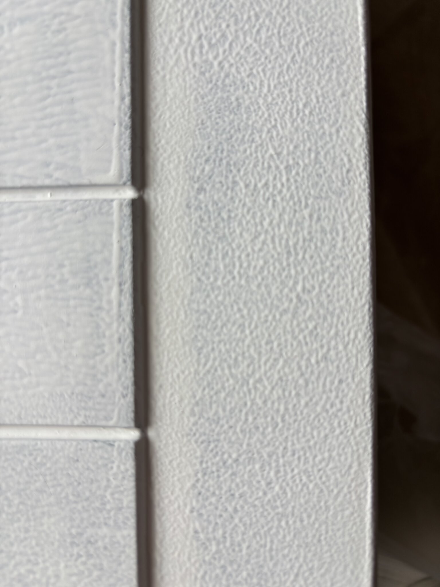

We are trying to paint our kitchen cabinets. We have watched a few videos on youtube and the foam roller seems to be the most popular recommendation.
However, we are not getting very good results. See pictures.
- We have thoroughly sanded the cabinet. It's very smooth.
- We have cleaned the surface
- We are using a paint for wood and metal from Johnstones
- We are using a foam roller from M&B Home
We seem to have better results with a brush, but it takes time. We tried a more traditional roller, but it was quite hard to use and it did not actually 'roll'.
Any advice?
Thanks!
What paint are you using?
Also that cabinet is neither wood or metal is it?
Most prep doors with fine scotch pad or 240 grade sanding pads.
Clean with a pre paint cleaner like Zinsser universal cleaner.
Use a waterbased adhesion primer.
Then maybe a undercoat if required.
Then two top coats of satin or eggshell paint
As a complete novice, when I painted some furniture I had built I purchased some 2 Fussy Blokes smooth roller sleeves - they are microfibre, not foam. Foam as you can see tends to leave air bubbles. However I also then "layed off" (I think is the term) with a good quality brush. I can't quite remember but they may have been Pro Dec or similar - if painted and left to dry flat, the finish is pretty good if I say so myself. In the end the technique was pretty much application with the roller, finishing with light laying off with the brush.
I did also however primer and undercoat first (was raw MR MDF), and then a few coats of eggshell to finish. Also a very light sand between coats to remove anything left from previous.
Foam rollers blow bubbles into thin paint, mohair are better, you used to be able to buy short bristle rollers which gave a finish close to spraying but not seen those in shops for a while .
Have always used ESP to prime cupboards much quicker and easier than sanding .
Foam rollers blow bubbles into thin paint, mohair are better, you used to be able to buy short bristle rollers which gave a finish close to spraying but seen those in shops.
  • Microfibre Short Pile (e.g., ProDec Advance): These are considered top-tier for smooth, lint-free finishes, superior paint loading, and preventing 'orange peel' on trim, doors, and cabinetry. They are suitable for all paint types, including water-based and gloss.
