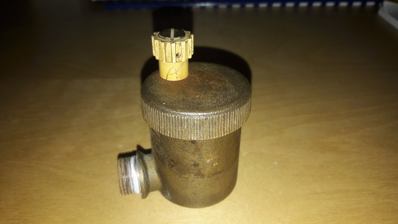

Hi all,
The Q&A for https://www.screwfix.com/p/bottle-air-vent-15mm/34359 stipulates that the automatic air vent can be installed horizontally, which I find strange, do you think this is correct or a mistake?
I need to replaced a damaged 1/2" or 3/8" air vent with side entry but not sure about the best way forward.
The main question is how can I determine if the thread if 1/2" or 3/8"? (sorry I am not very knowledgeable is imperial measurements)

Why not photo the offending item,showing the valve and the connection. An oem part may be available,then you wont need to faff around with adaptors.

Here is a photo of the auto air vent:
I have now determined it is a 3/8" thread. Since I cannot find any direct replacement (i.e. air vent with 3/8" side entry), I am thinking of getting:

Is that the best solution? Or do they still sell air vents with 3/8" side entry?

Thanks Terry, I managed to find a 3/8" male to female elbow at my local plumb shop which allowed me to install the 3/8" air vent in a vertical position, all sorted.
