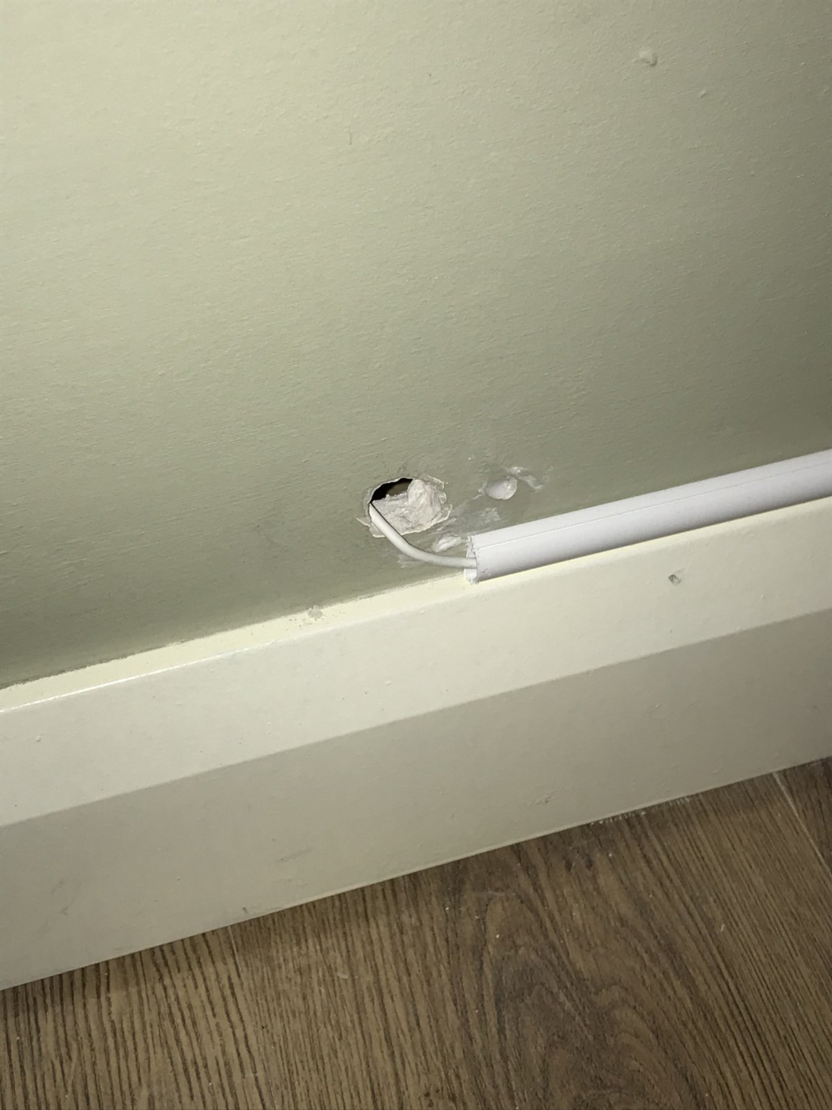

Hello. I just routed a USB cable behind a dry wall for my thermostat however there is an unsightly hope at the bottom where the cable comes out. I’m looking for one of those little split rosette collars but can only find them for radiators. Thanks in advance.

I'd actually extend the hole so that the cable comes out by the trunking, and then just fill it with filler. Then put a small dab of silicone sealant to fill the end of the trunking.
