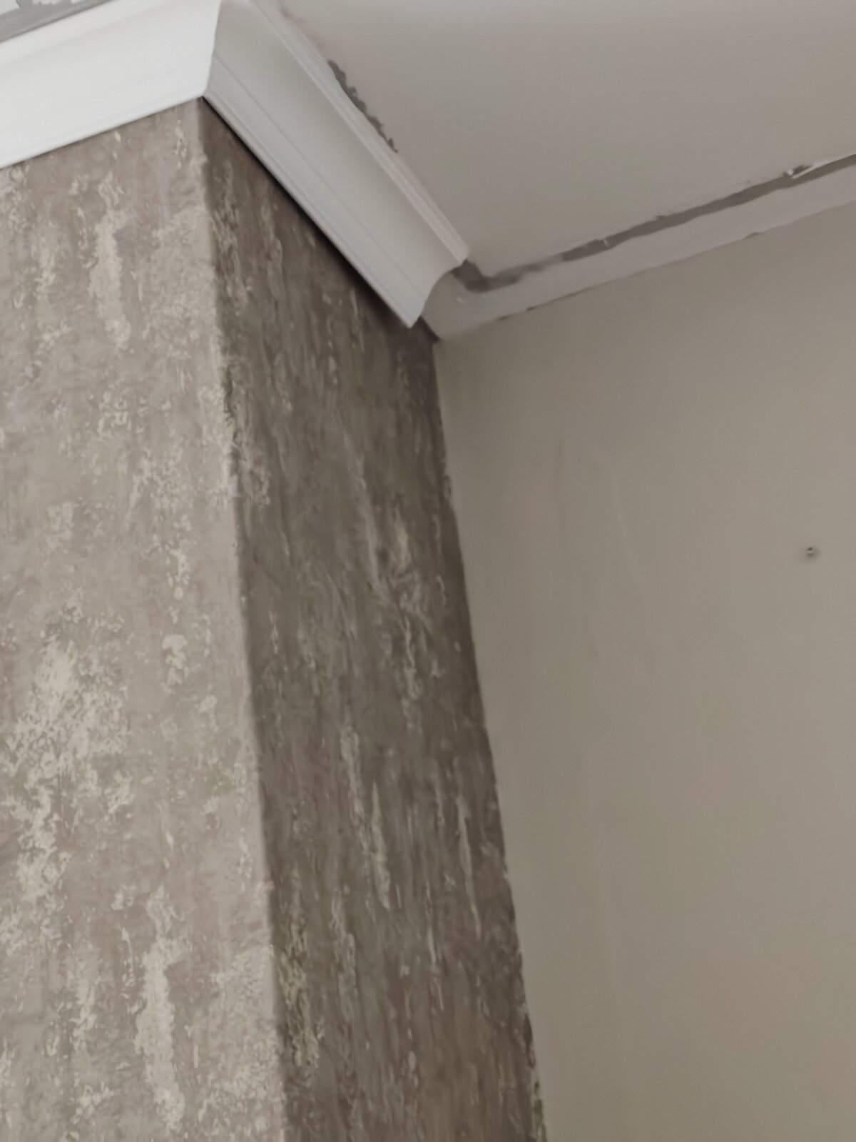

You have to adjust the angle of cut on the 2 pieces of coving. If they are at a true 90 then angles of cut is 45 degree, if wall is 2 degrees out (say) the angles of cut need to be increased or decreased by 1 degree depending which way wall angle is out. Or run fish with wall and be creative with filler
