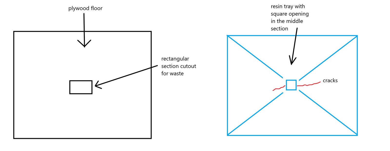

Would anyone be able to recommend a shower tray repairer who does not charge an arm and a leg?
The shower tray, since fitted a year ago, has developed two hairline cracks around the waste, which is in the middle. The tray sits on plywood, but is not well supported (fitter used foam), and in the middle section there is an A5 sized cutout to accommodate the waste, which means that area sits over nothing but thin air.
The hairline cracks have got progressively a bit larger over a year, even though we do not step on the middle area.
The tray which costs only around £250, cannot be removed as that would require breaking a lot of very large tiles and injuring the tanking as well.
I have read about professional repair which injects foam under the cracks and then glues the cracks together - but one place I asked he wants £400-£500. And in any case, if their plan is to inject foam, it will only disappear into the void under the plywood, through the A5 sized opening.
Alternatively I had another idea, to install a very thin film over the existing tray, or just over the area with the cracks - we will continue not to step on the cracks, and the film will form a barrier ?

Not what you want to hear but - once they are cracked then really it's time to change, the trouble is the existing cause would still be there so those cracks would invariably return. do the crack fully penetrate and is the tray leaking through?
As far as the section removed from the ply, obviously some of it has to be cut out to accommodate the waste and trap, how much is usually dictated by the size of the trap and waste setup, unfortunately can't get away from that. How long has it been in?

Yes but a repair might prevent the crack extending further, especially since we do not step on the centre. But at £500 it seems crazy money.
Have you contacted original installer? It obviously wasn't fixed to manufacturers instructions.
Yes, he says he uses foam everywhere and is adamant that the tray was defective ... The manufacturer explicitly specifies a bed of sand and cement with special attention to the waste area...

A year, and the cracks were there from installation. The tray was covered with some hardboard and the tiler used it as a prep area putting a lot of tiles on it, bags of adhesive and large mixing buckets! The cracks were discovered when the cover was removed.
This is a photo from a year ago when the cracks were fresh (hairline). And the next photo is today, you can see the progress of the fault.

If that happened right after the install then TBH that's when it should have been taken up with the installer.
It would be interesting though to know what the installation instruction detailed with regards to the install method, I have seen a manufacturer mention using expanding foam (can't remember which one off hand). Also I presume the tray is stone resin, is it flat bottomed or ribbed? Do you have a make?

This manufacturer ( cannot recall name ), and another ( MIRA ), both DEMAND a bed of sand and cement, and go to great lengths to emphasize that and absolutely no foam or silicones.
Stone resin, flat bottomed, 25mm overall, thinning to about 10mm as you get into the centre where the water collects and drains off.

Nope - unless they can grind out the whole crack there is nothing really that will stop cracking from getting worse.
Very low profile - not surprised it's cracking if it's down to 10mm with nothing underneath it.

For what its worth, I've just installed a stone resin shower tray and enclosure, employing the very welcome guidance and advice from contributors to this forum. I was left in little doubt that the tray had to be bedded properly with tile adhesive or sand and cement, and the former is what I used. I'm only a DIYer, but had someone suggested expanding foam I would have been somewhat sceptical, to say the least.
OP, in your position I'd be thinking "shower tray replacement", I'm afraid, starting from scratch and having the job done as I was advised to do it by members of this forum.
