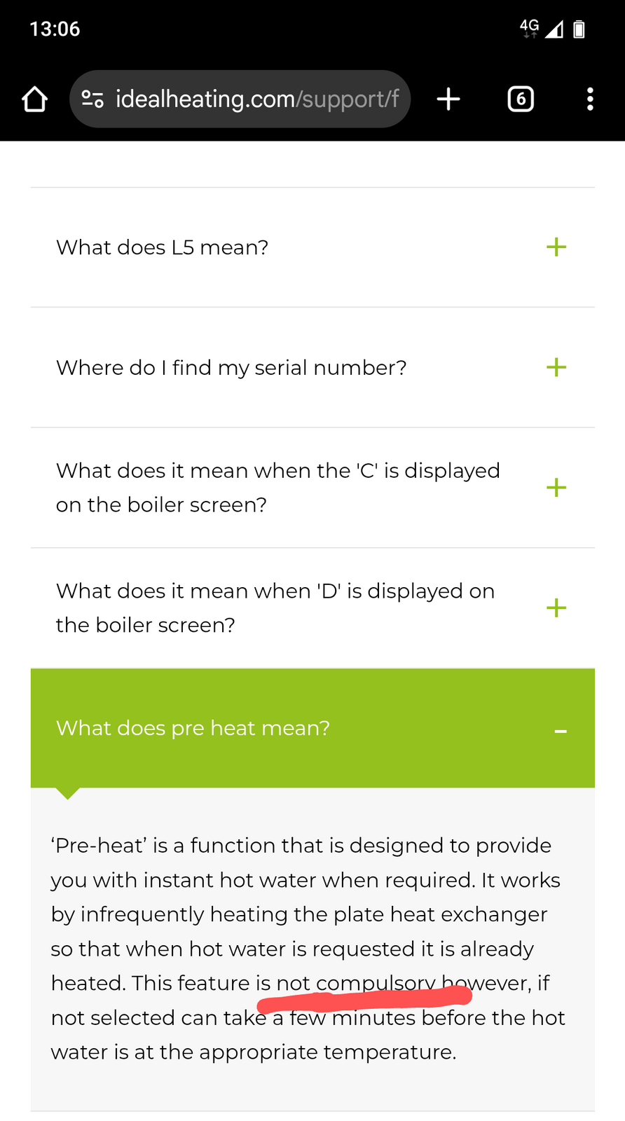

and has an eco mode that can’t be turned off so comes alive at night.
My understanding was that the eco mode (pre-heat) function could always be turned off?

We have been turning it off for a year fine but my question is about the spur and if it is possible to use that.
No not on this boiler.
Maybe it's not being done correctly?

Thank you it’s an ideal esprit 2 30kw boiler from 2012 and doesn’t have this function unfortunately. We rented a property a few years ago and it had a valiant boiler and you could turn eco mode off to stop it firing all night.

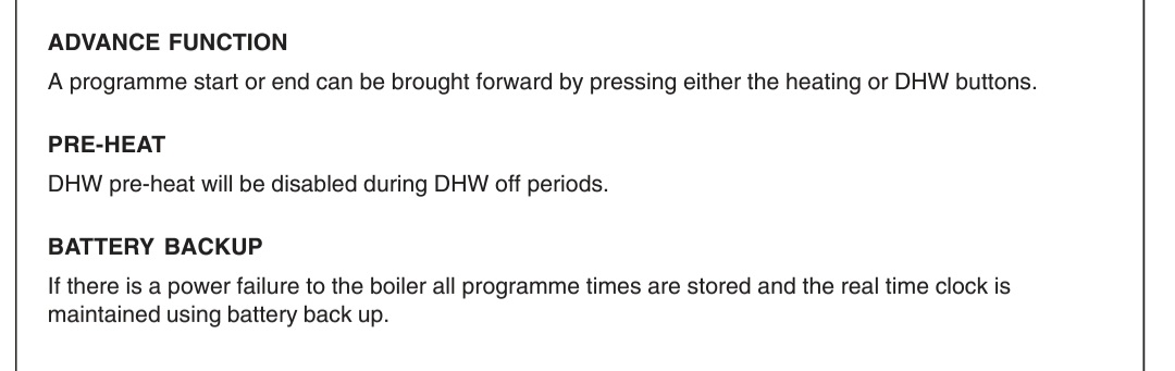

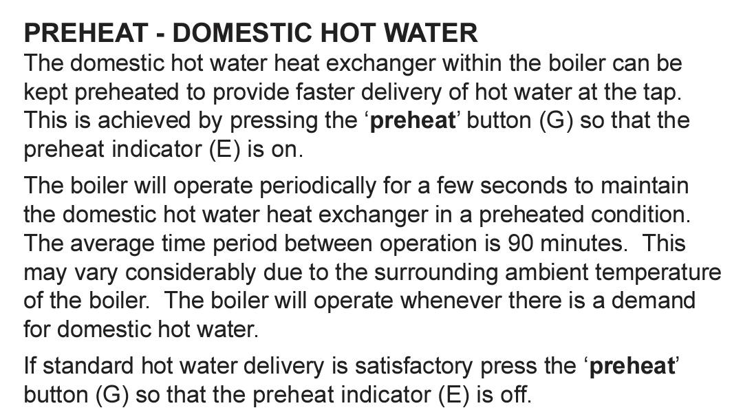

Is it the frost protection, being activated? Perhaps the protection temperature is set to high?
It seems as if the pre-heat is enabled during the programmed hours of HW demand...
That sounds like the answer!
I hadn't actually realised on a combi that you could program hot water times. I had assumed hot water was always available on demand.
