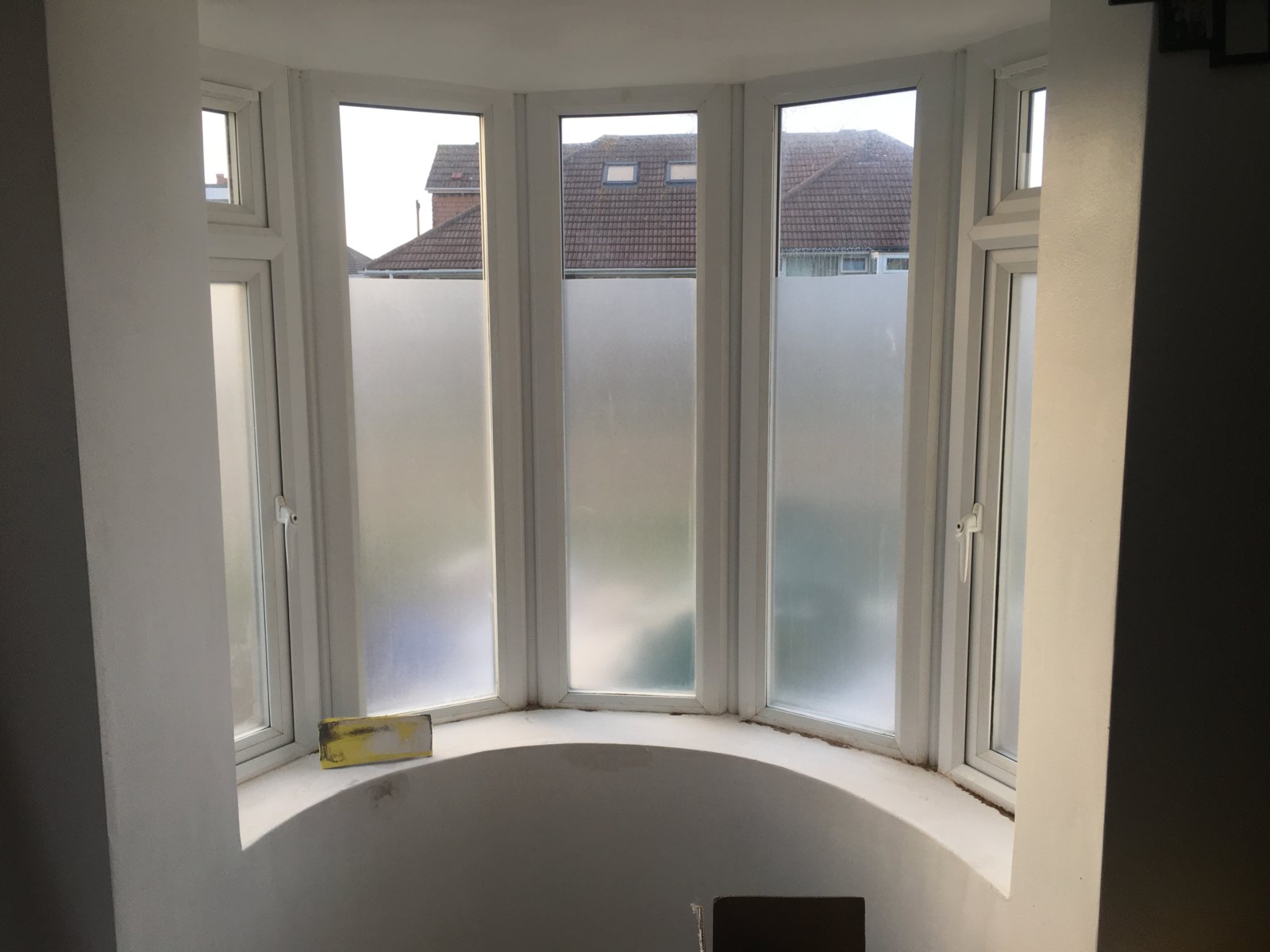

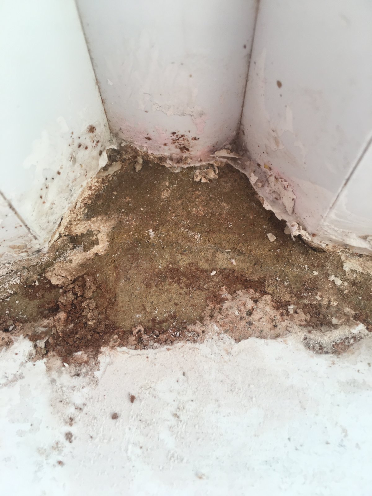

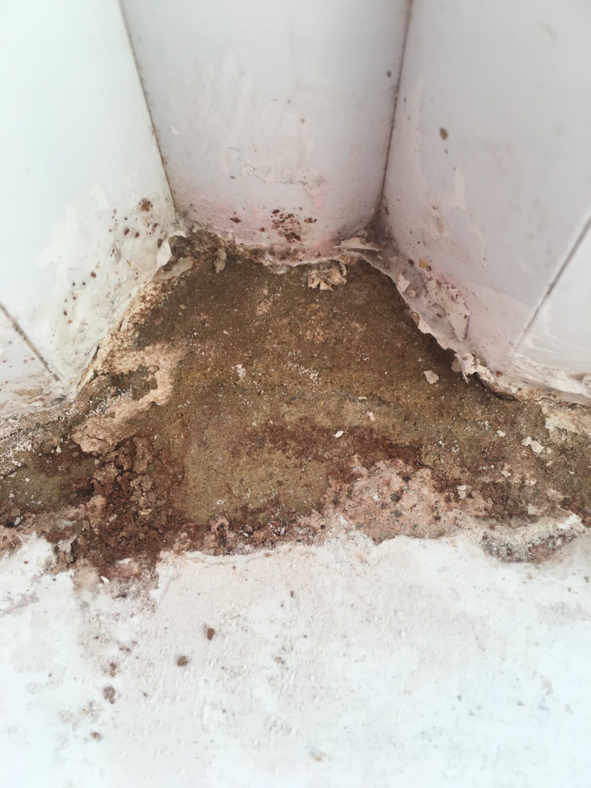

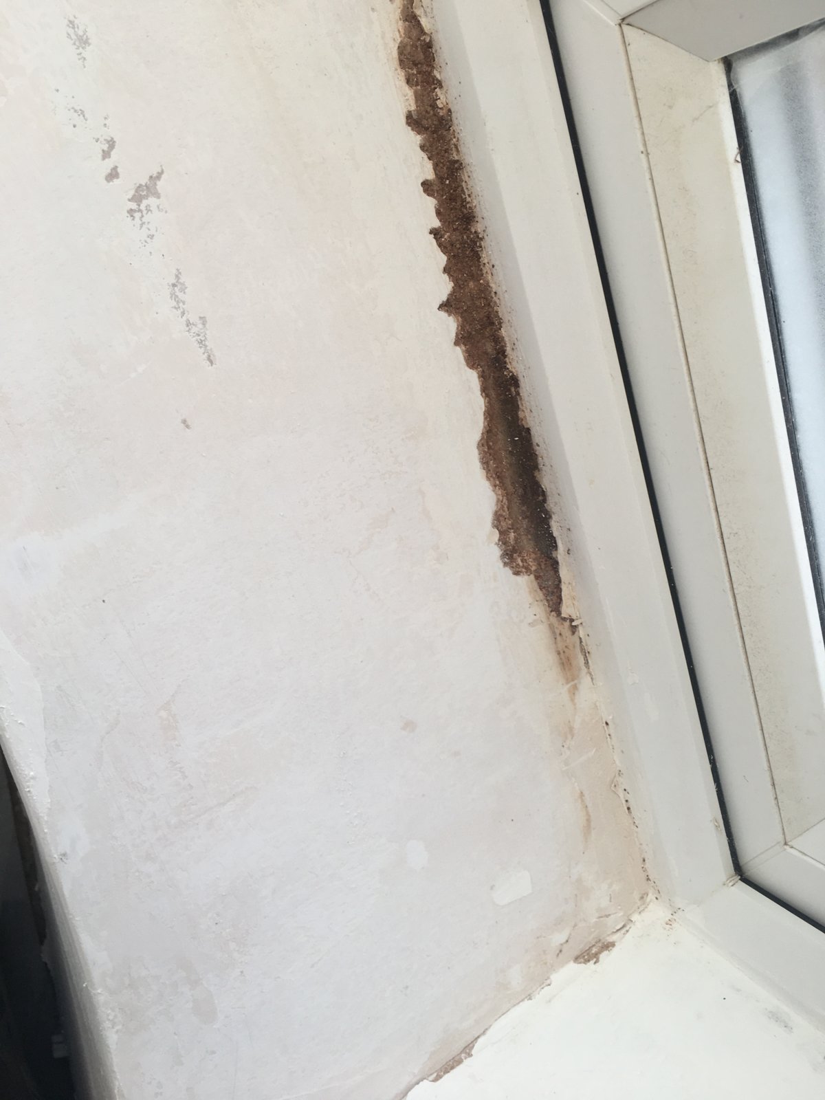

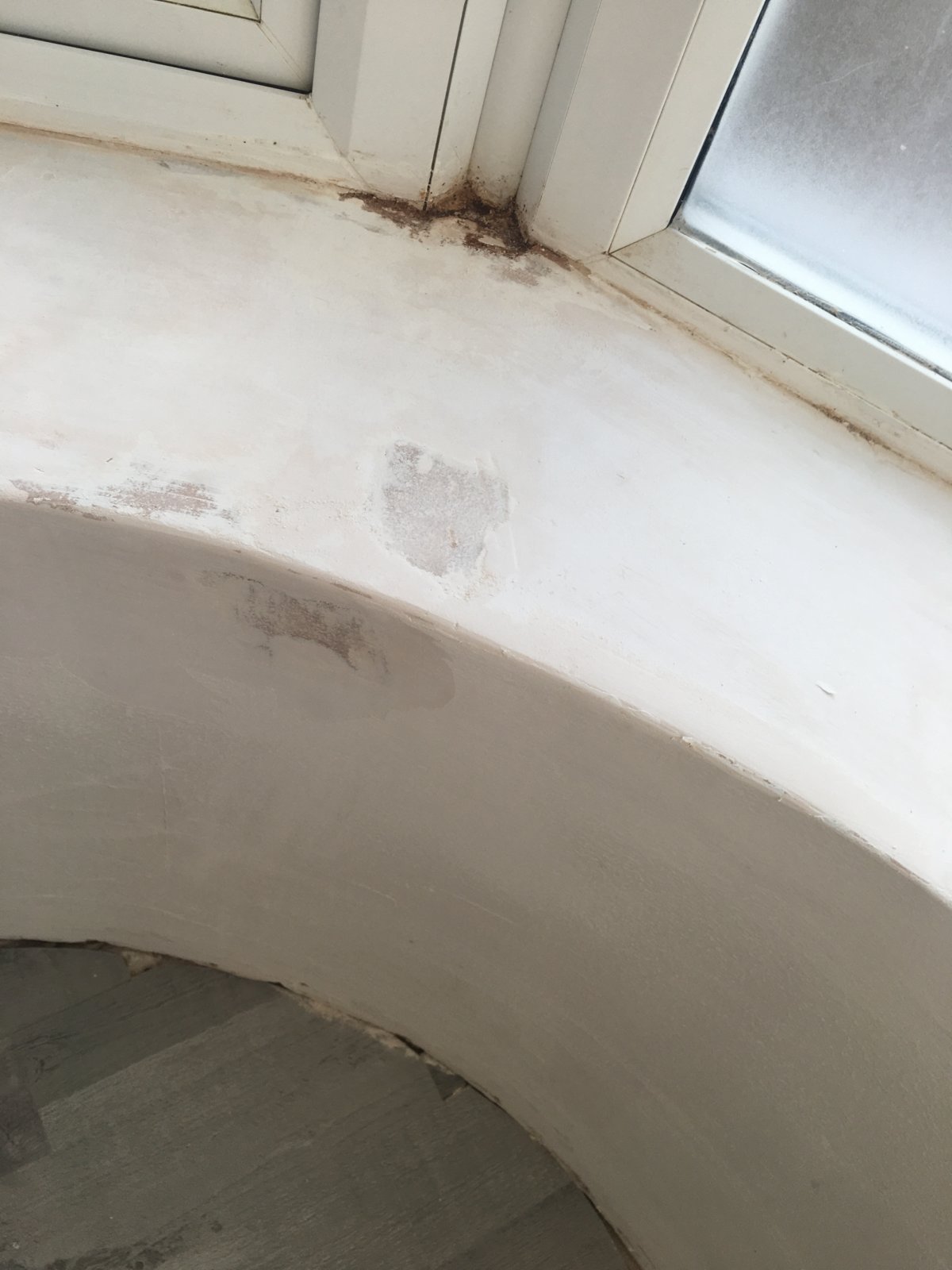

House I recently bough has damage around windows all paint as peeled of and for me it looks like there is plaster under a lot of filler !? Not sure .
Window corners look bad condition also what ever is there is just coming off .
I also had little damp and condensation around there what I cleaned off with baking soda/vinegar.
Not sure what to do next now

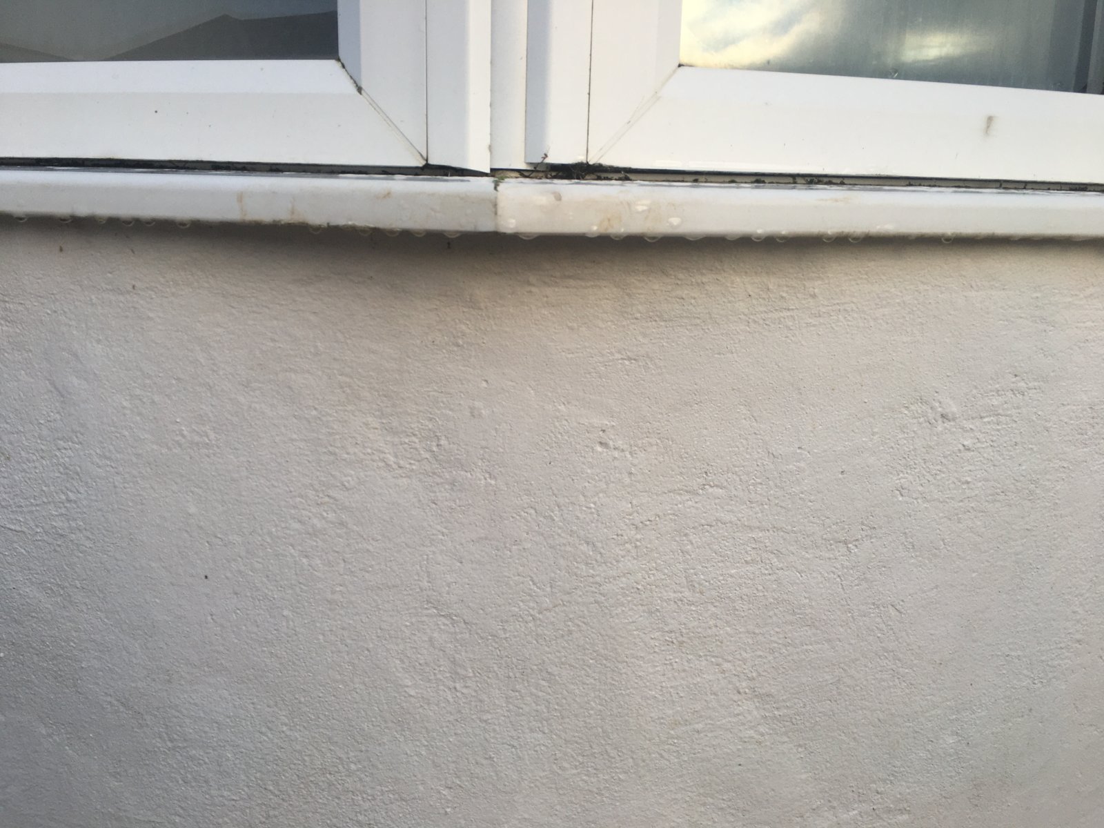

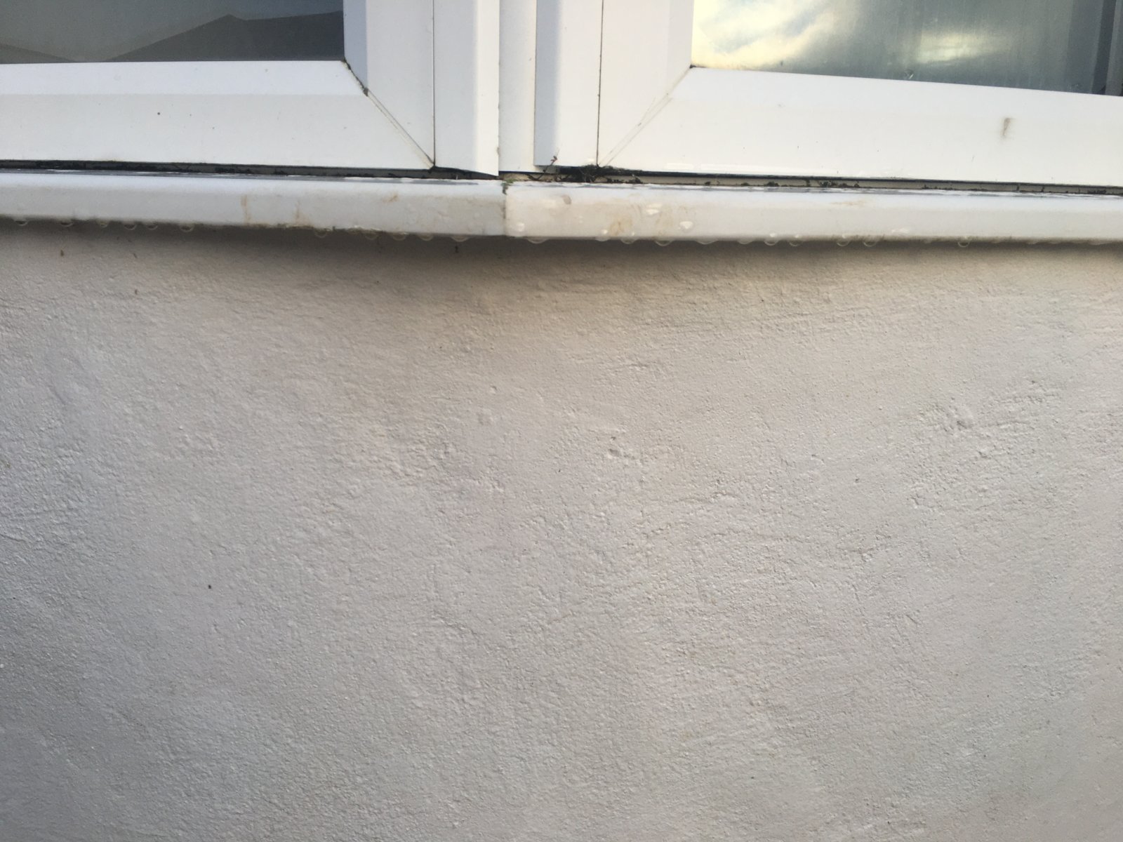

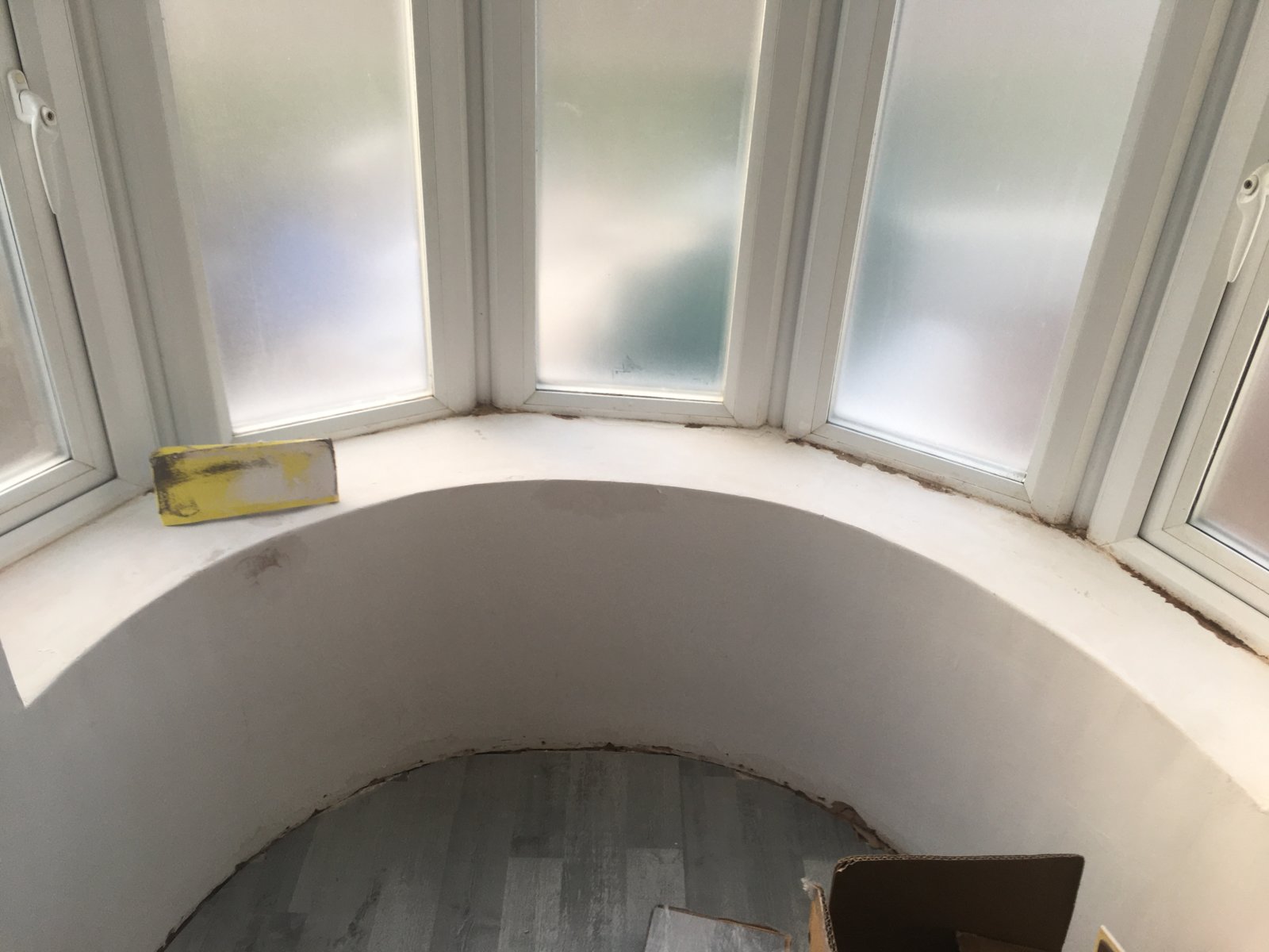

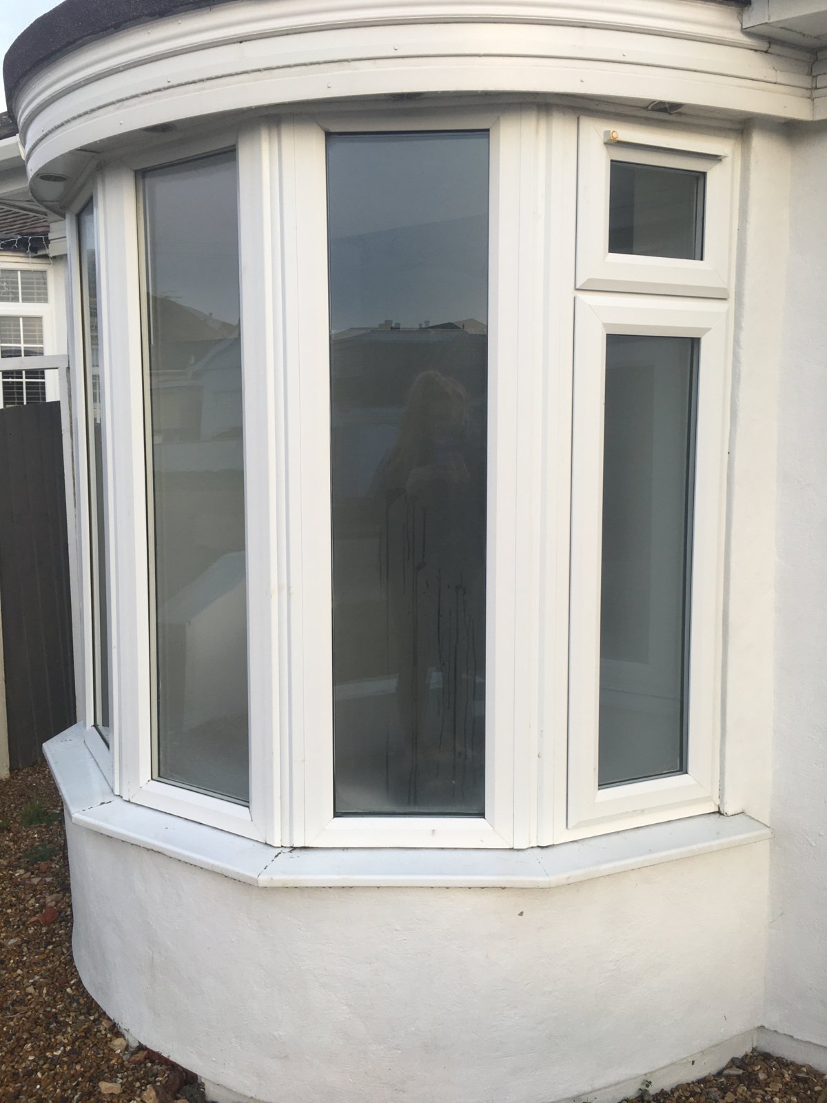

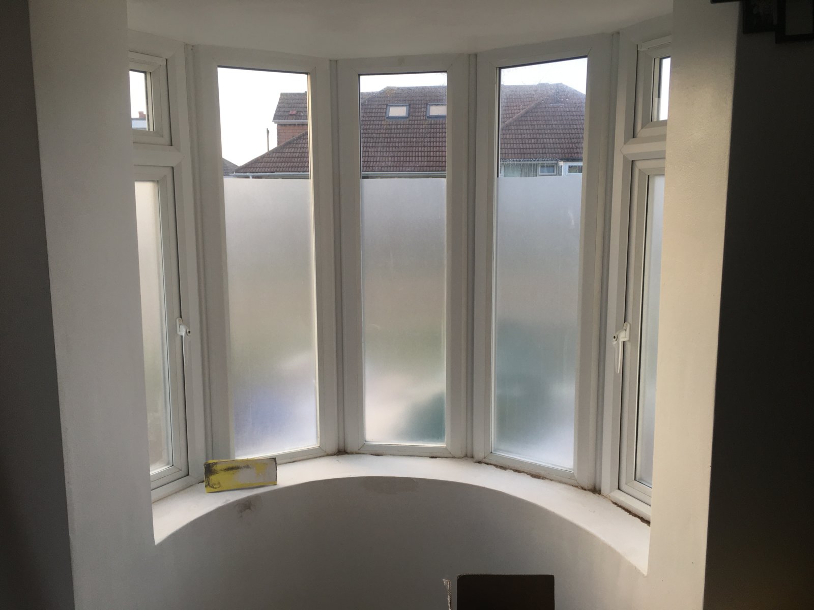

can you stand back and pic the whole bay interior and the bay exterior?
and a few close up's showing the suspect spots in detail from outside?
where's the skirting?
is that condensation on the glass or inside the D/G?
For me it looks pretty clean outside .
Skirting boards isn’t fitted yet as we recently got new flooring there and one windows it’s privacy firm .
As I only had condensation while cooking it might be my mistake I am opening window turning this now and extractor fan is fitted next week also bough dehumidifier .

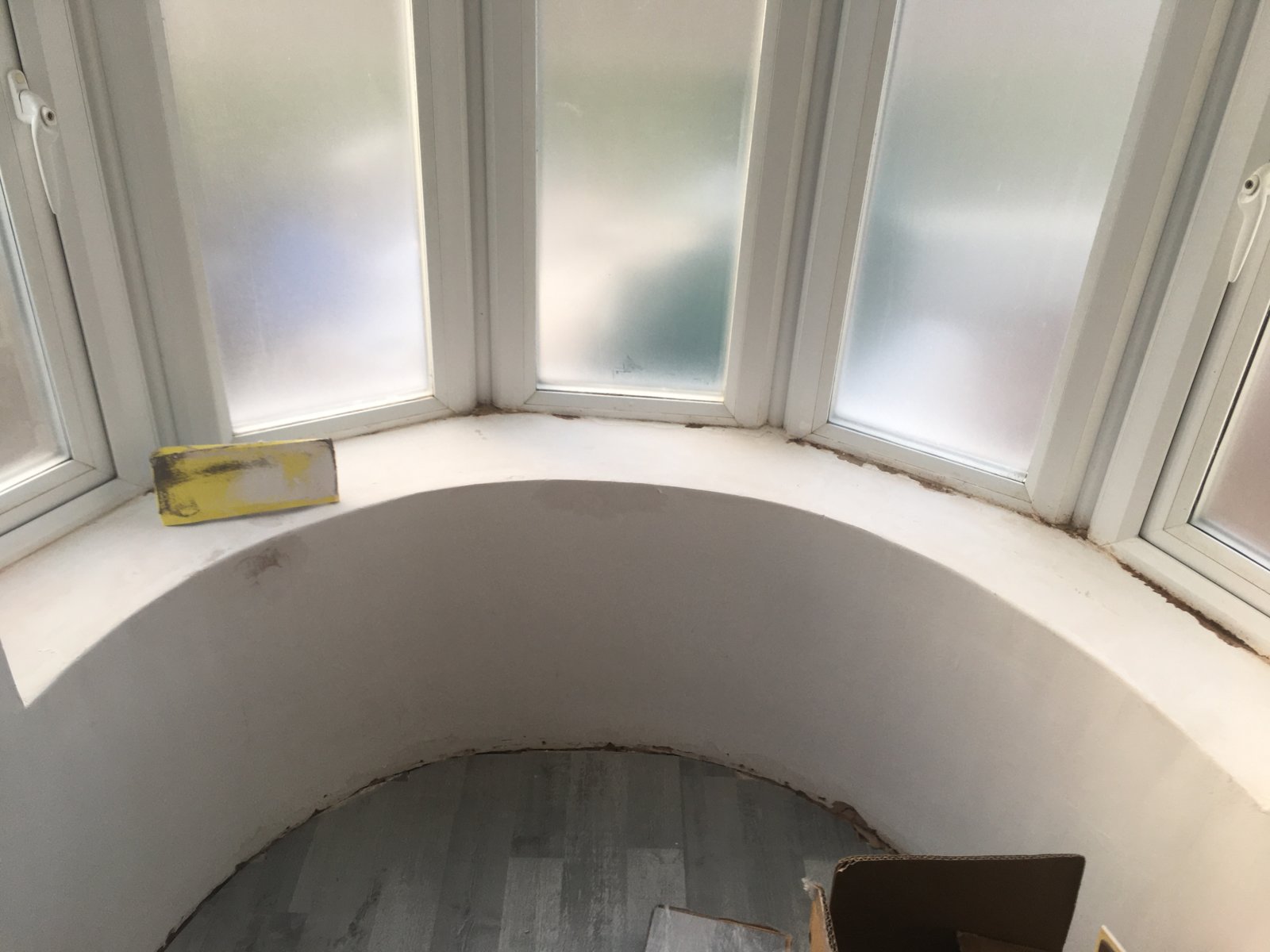

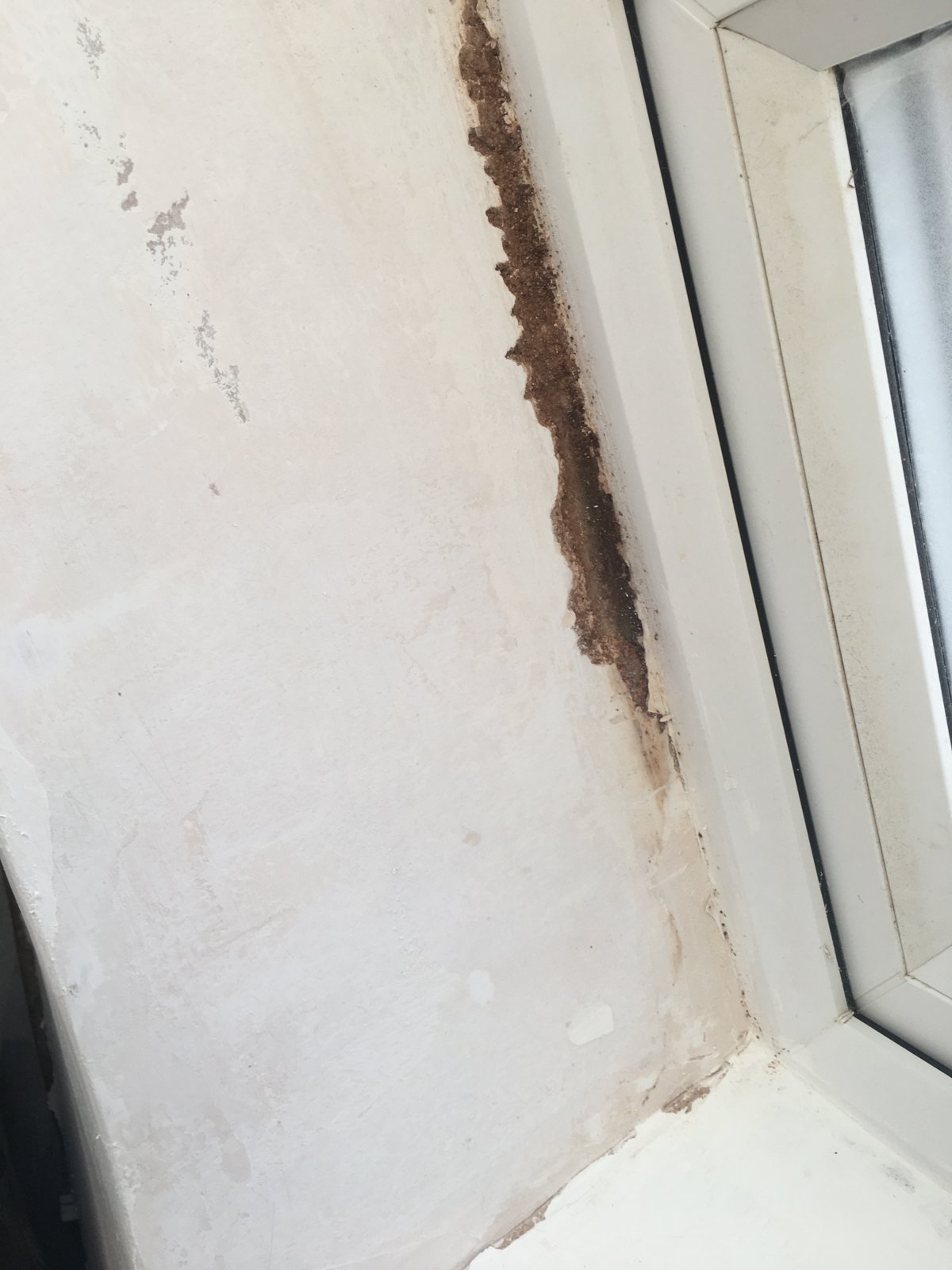

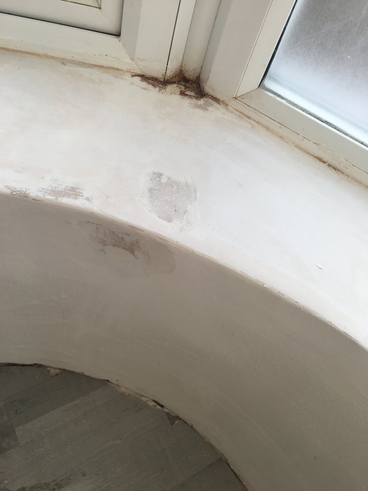

The paint is pealing of in rest of the house also so I was told by plasterer previously it might have been used wood paint on walls:eek:

thanks for the new pics.
given what they show and what you say its difficult, for me anyway, to give you a clear cut course of action.
the damage could be from heavy and long term condensation or condensation and penetrating damp - i noticed previous attempts to silicone seal off, presumably, penetrating damp?
maybe you would do best to call in a local doors & windows trader for an on site view?
aamoi: how is the rainwater discharging from the bay roof?
