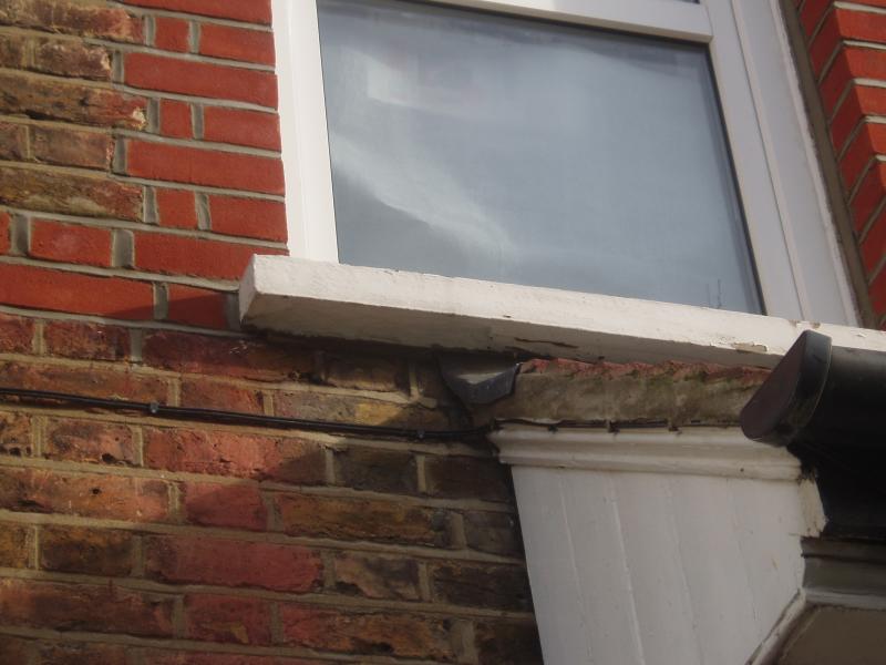

What's the brickwork/pointing like externally? Is there any water maybe pooling on the window cill and not being shed? Pics from the outside may reveal more.

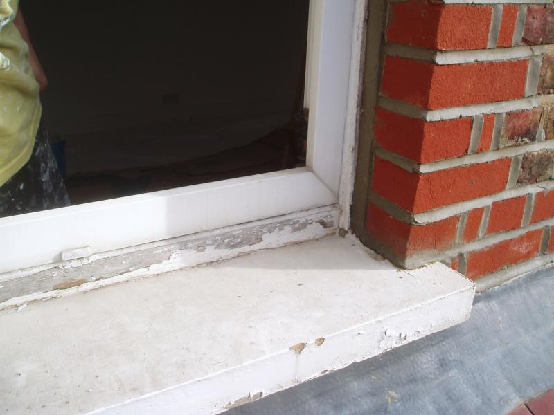

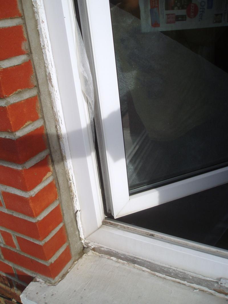

- the window unit sits within part of the old sash frame. The old sash frame is a little worse for wear externally where it meets the double glazing
- the brick work is just standard brick - its a Victorian house, no no cavity etc - I could not see any water pooling on the window sill, but the rain has eased off for a good 24 hours or so
- externally there is a small mini tiled roof over a bay window, which has a gutter. The top of this mini roof runs directly iunderenath the window sill externally and at the bottom of the roof there is a gutter
I have taken three photos of the window frame from outside. It does look like it is need of overhaul. Have a click on teh middle phot especially so you can see it upclose, it does look it has seen better days
Do you think that the moisture could be getting in through there?
that doesnt look good to me from those pics.my guess its getting through that silicone joint.
Bit of silicone may do the job, using the old sash as a sub frame may also be the prob if its past its sell by date. Could the fact that it's damp close to the verge of the roof be a point? Have you looked around that area for any gaps or loose pointing around the flashing? The flashing looks very tight to the cill & it may be that the pointing isn't too good there, after the wind & driven rain we've had, it's feasible that it may have soaked through and come out in the corner. Try the silicone solution first & go from there though, just a matter of eliminating each possibility.
