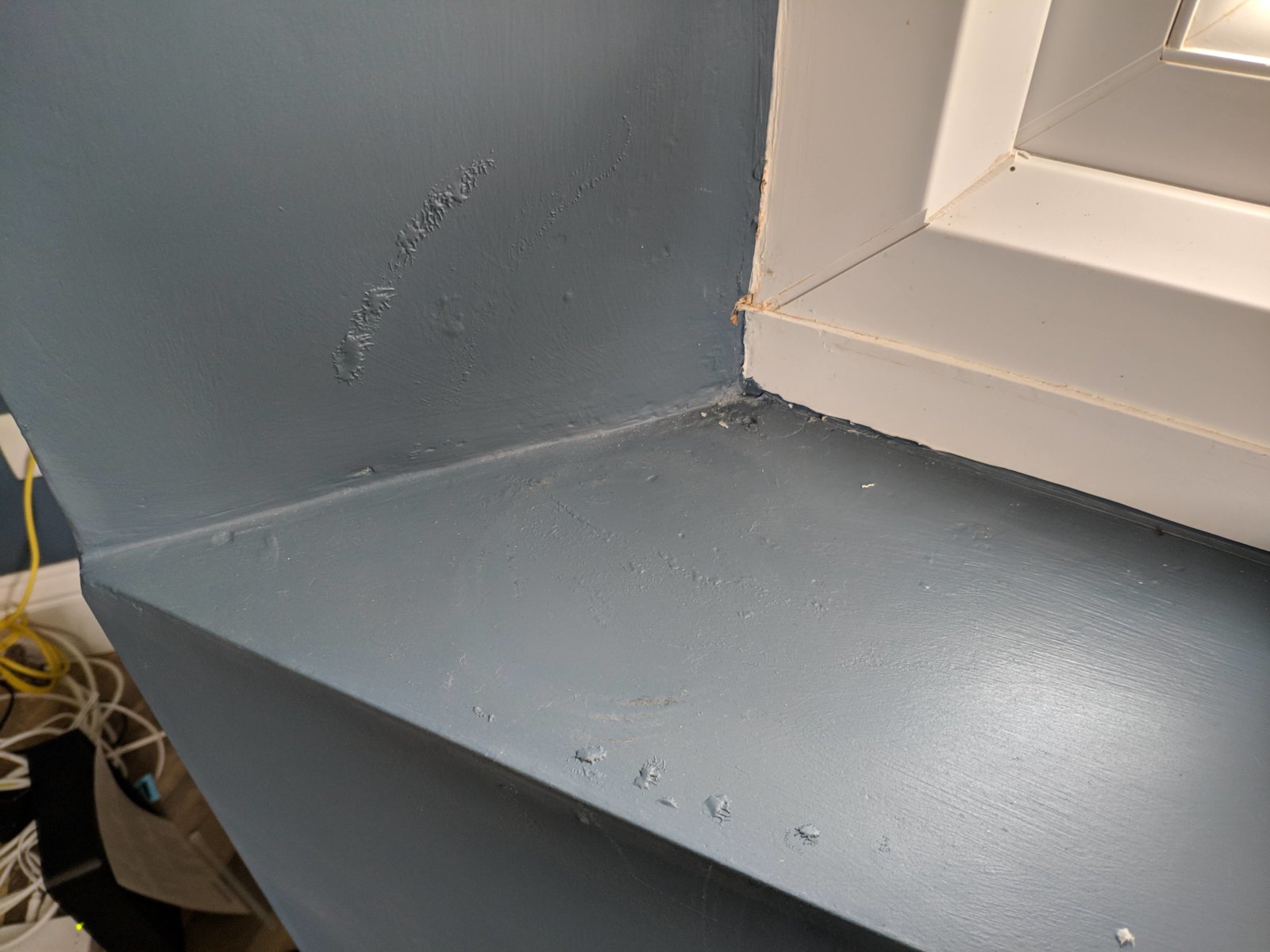

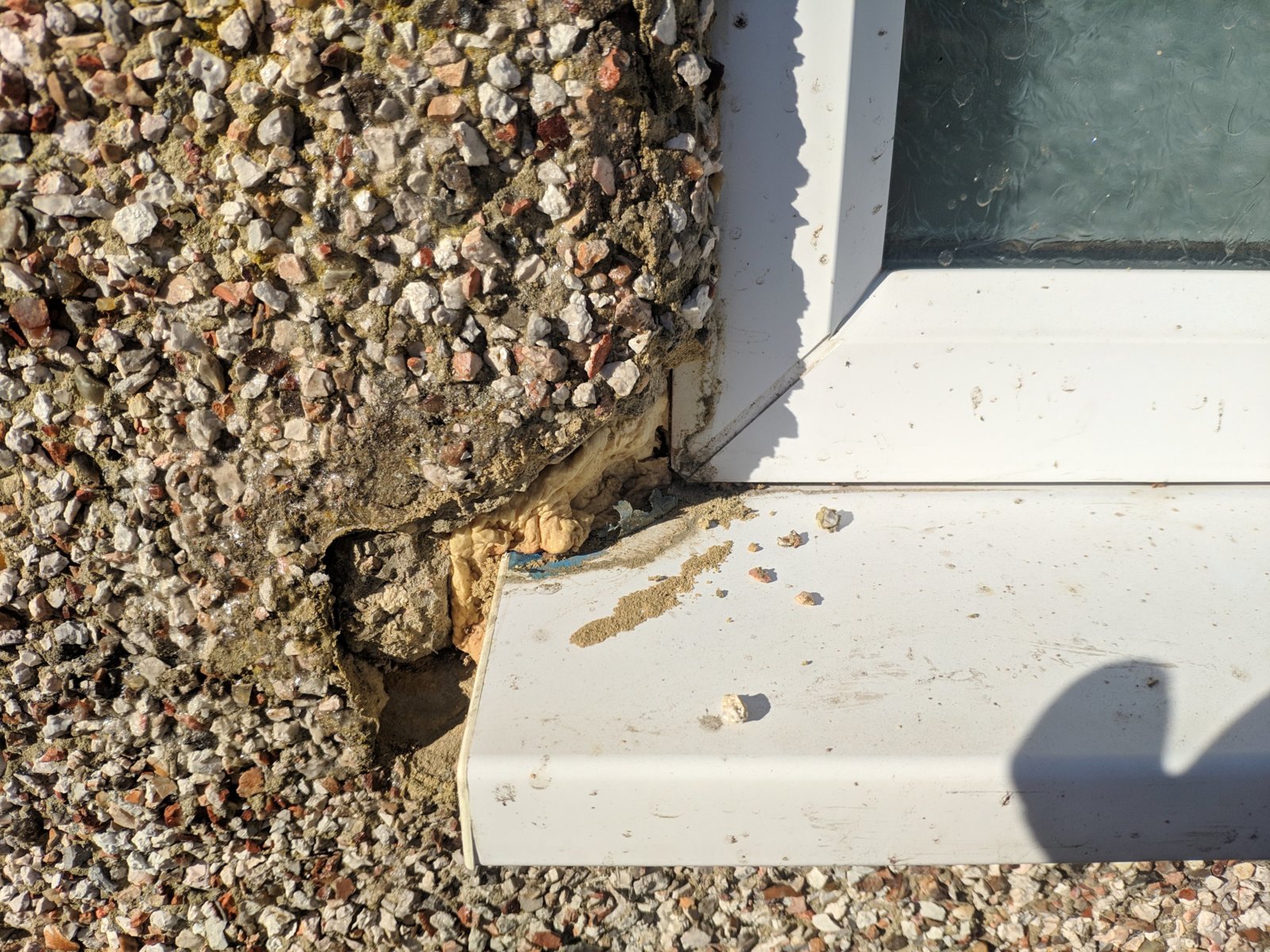

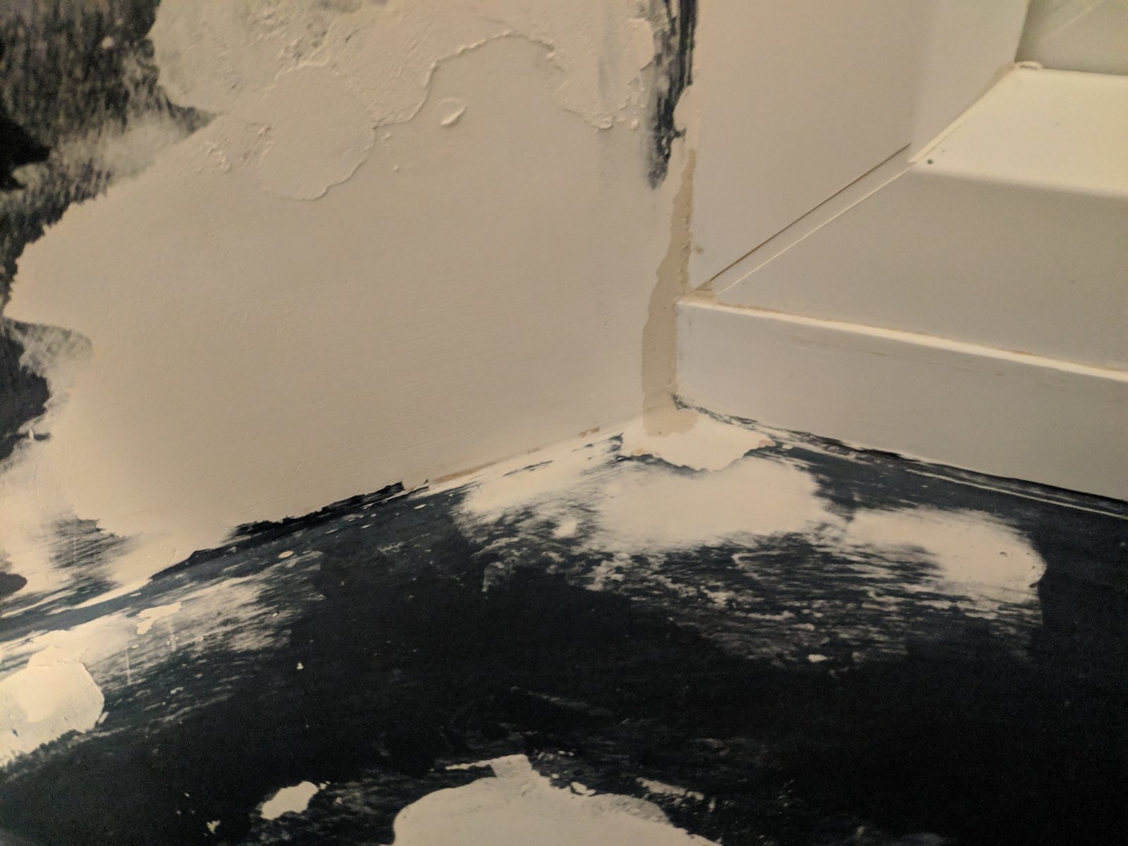

We have been renovating our house over the two years since we have had it and only after decorating have we noticed damp patches in the bottom corners of the windows. Paint starts to bubble with salt deposits coming through (efflorescence?).

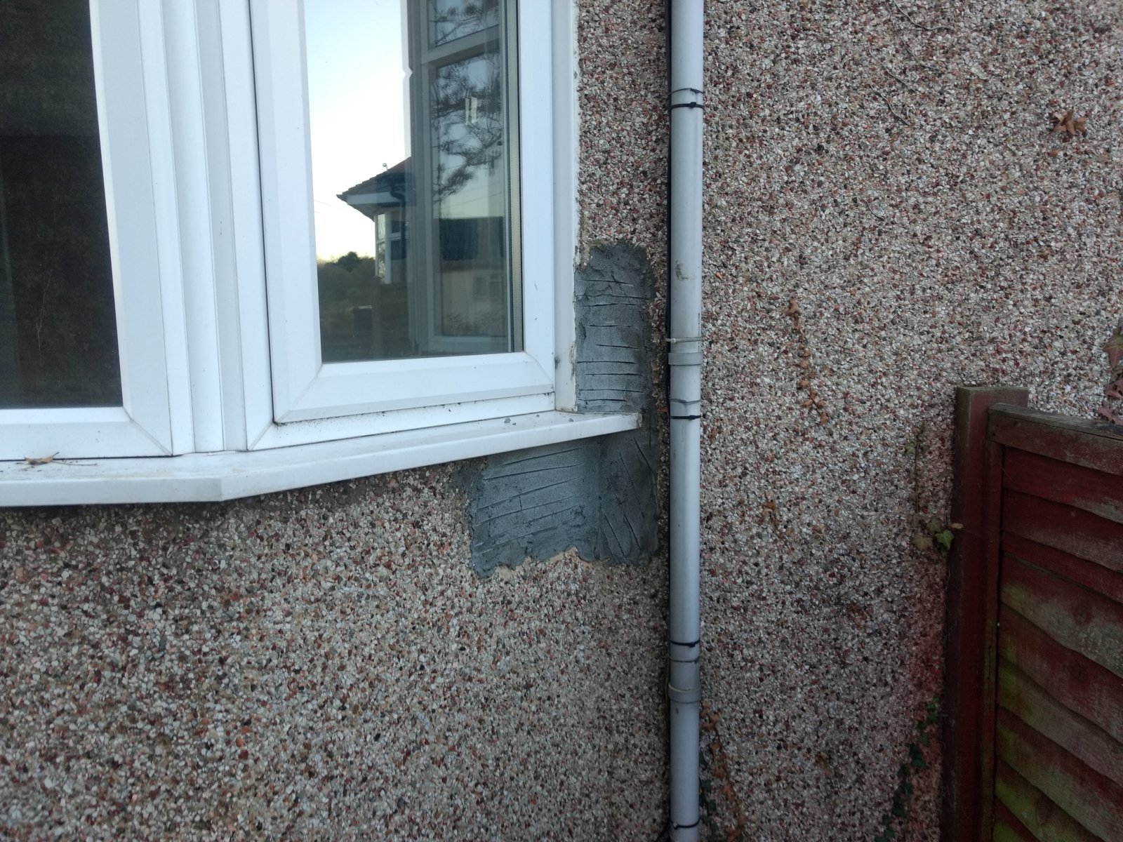

Thinking it was bad pebble dashing repairs from the window installers (from previous owners) we had the outside edges re-rendered. On the inside I scraped the salt off and scraped back the paint to pair plaster and re-skimmed the areas in preparation for painting.

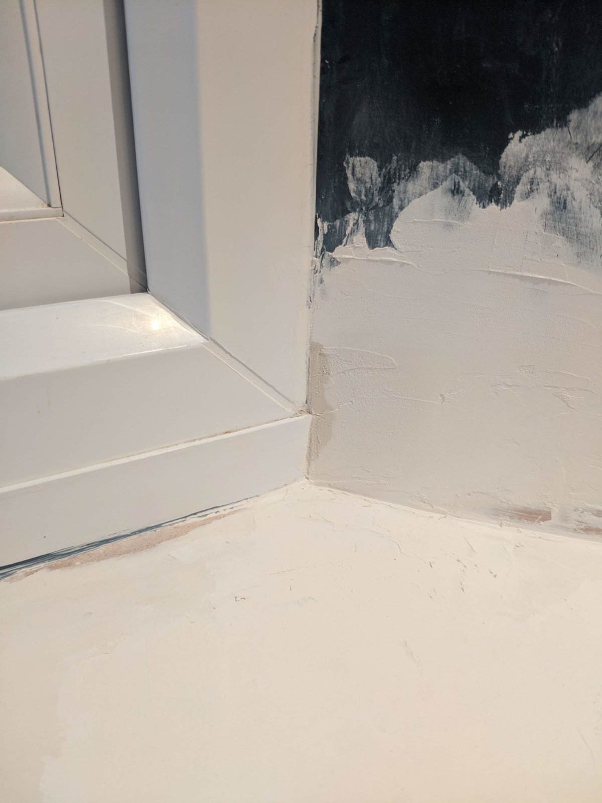

I left it for a few days to wait until it rained. It rained and the damp reappeared. After searching the internet again I came across here and several other posts of people reporting the same issue.

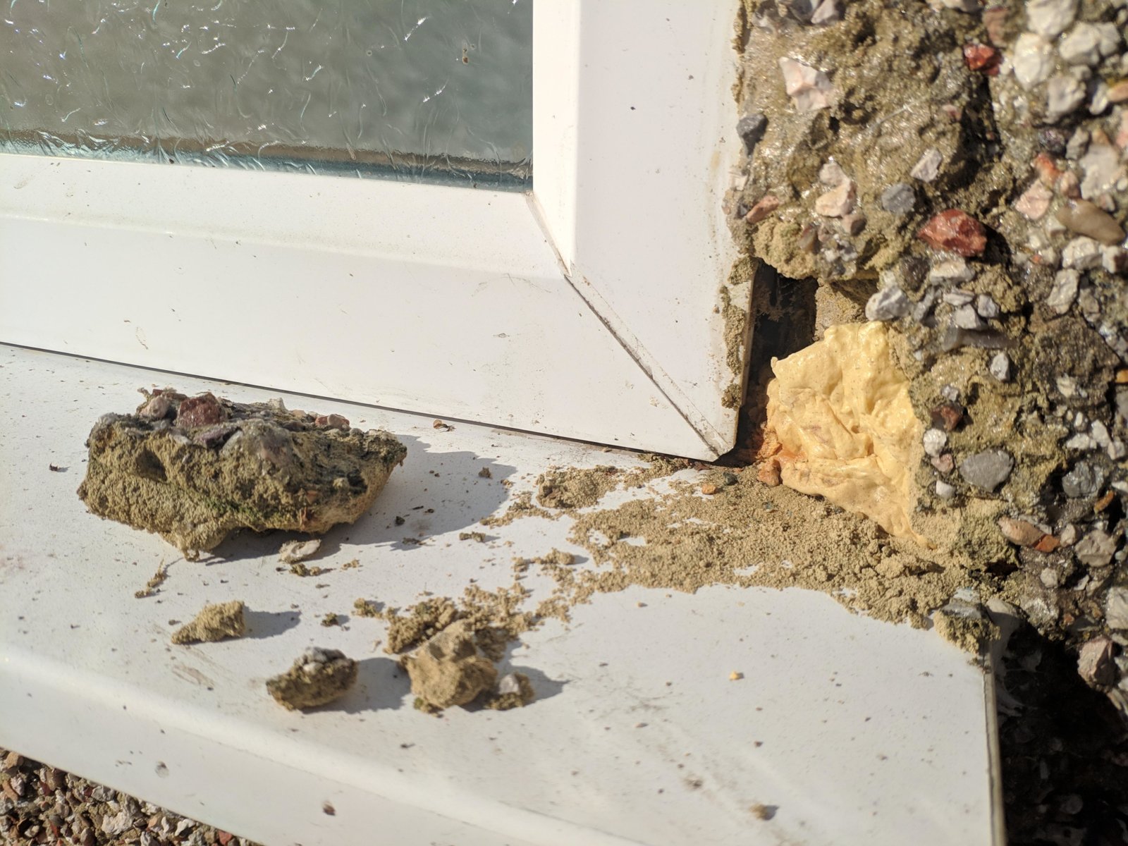

Most of the posts I saw said the problem sounds like the window and sill have not been sealed correctly. This inspired me to dig out the corners of the windows from the inside and have another look.

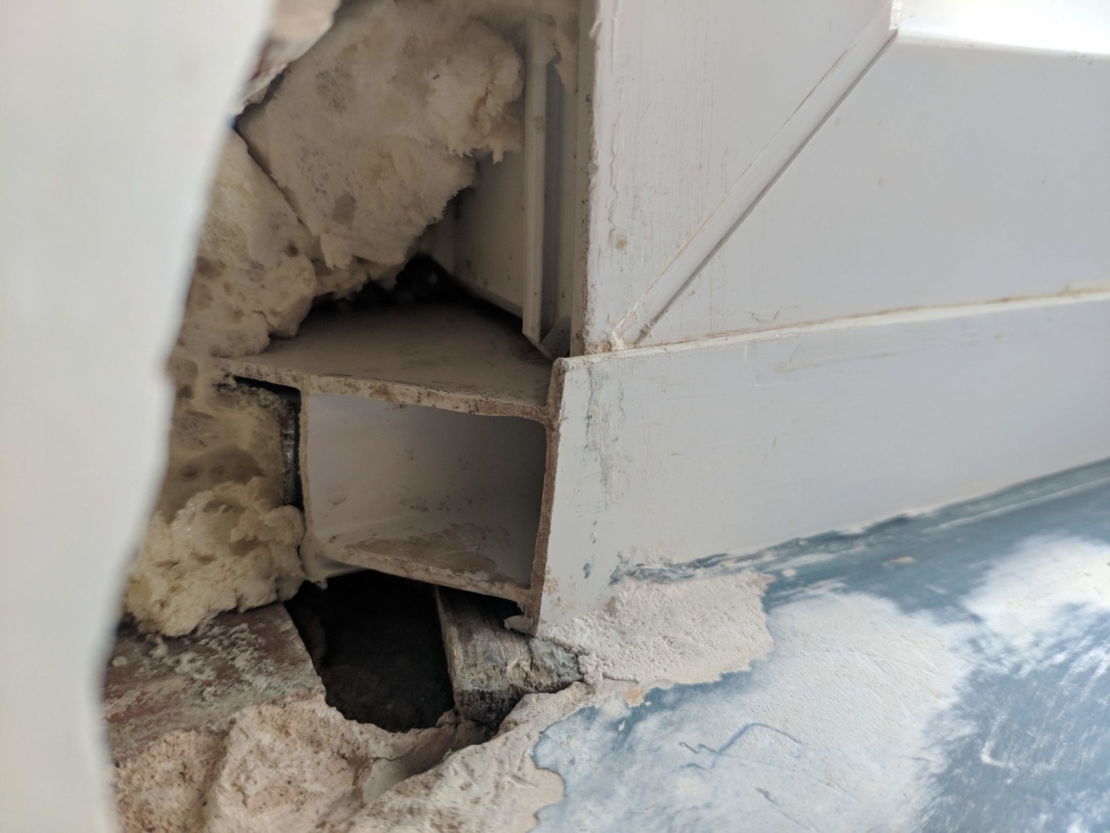

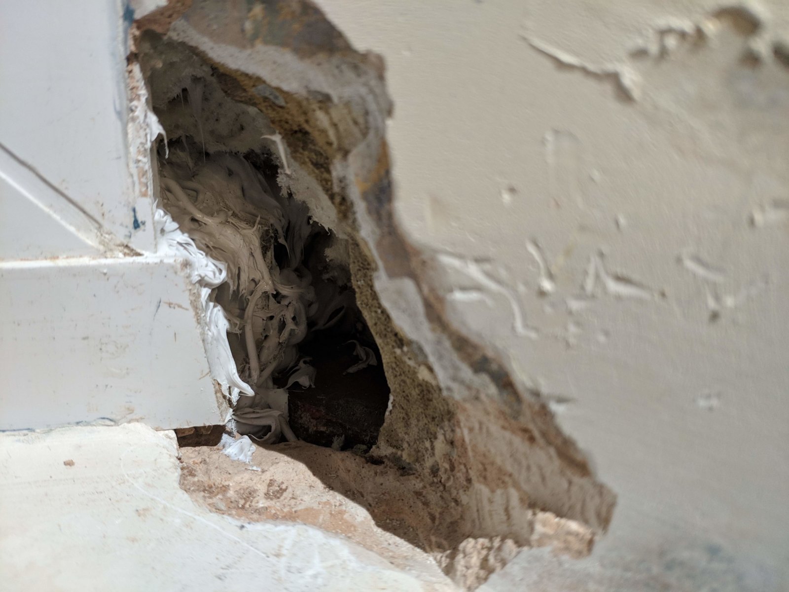

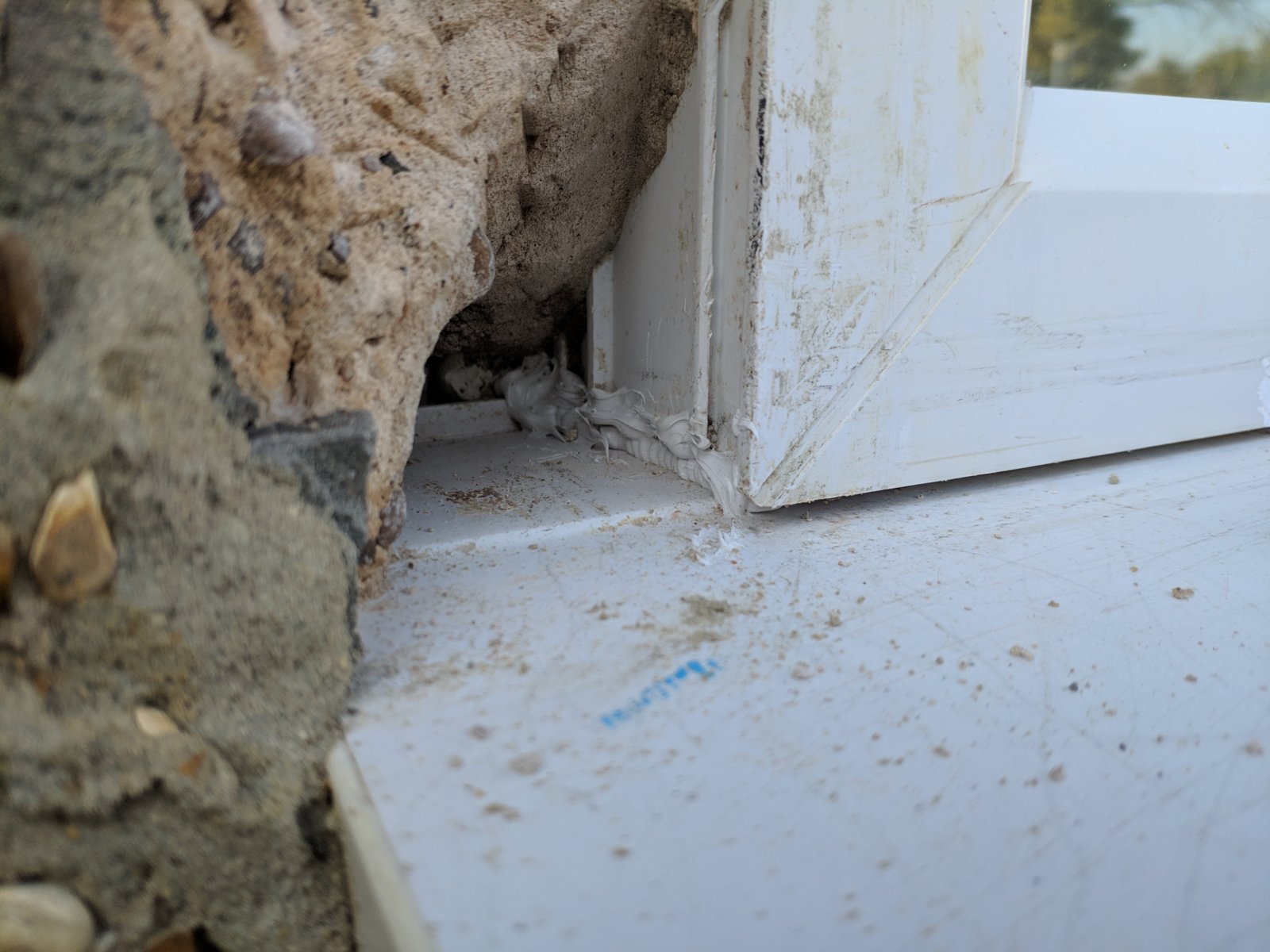

After digging out the plaster to expose the window sill edge I went outside and threw a cup of water at the window and had my partner watch for any leaks...
We didn't expect to see a whole stream of water pouring into the wall!! It seems to be making its way in from nearer the front of the sill.
I'm confidant now that this is the issue for all the windows that are showing this issue.
So my question now is the best way to repair?

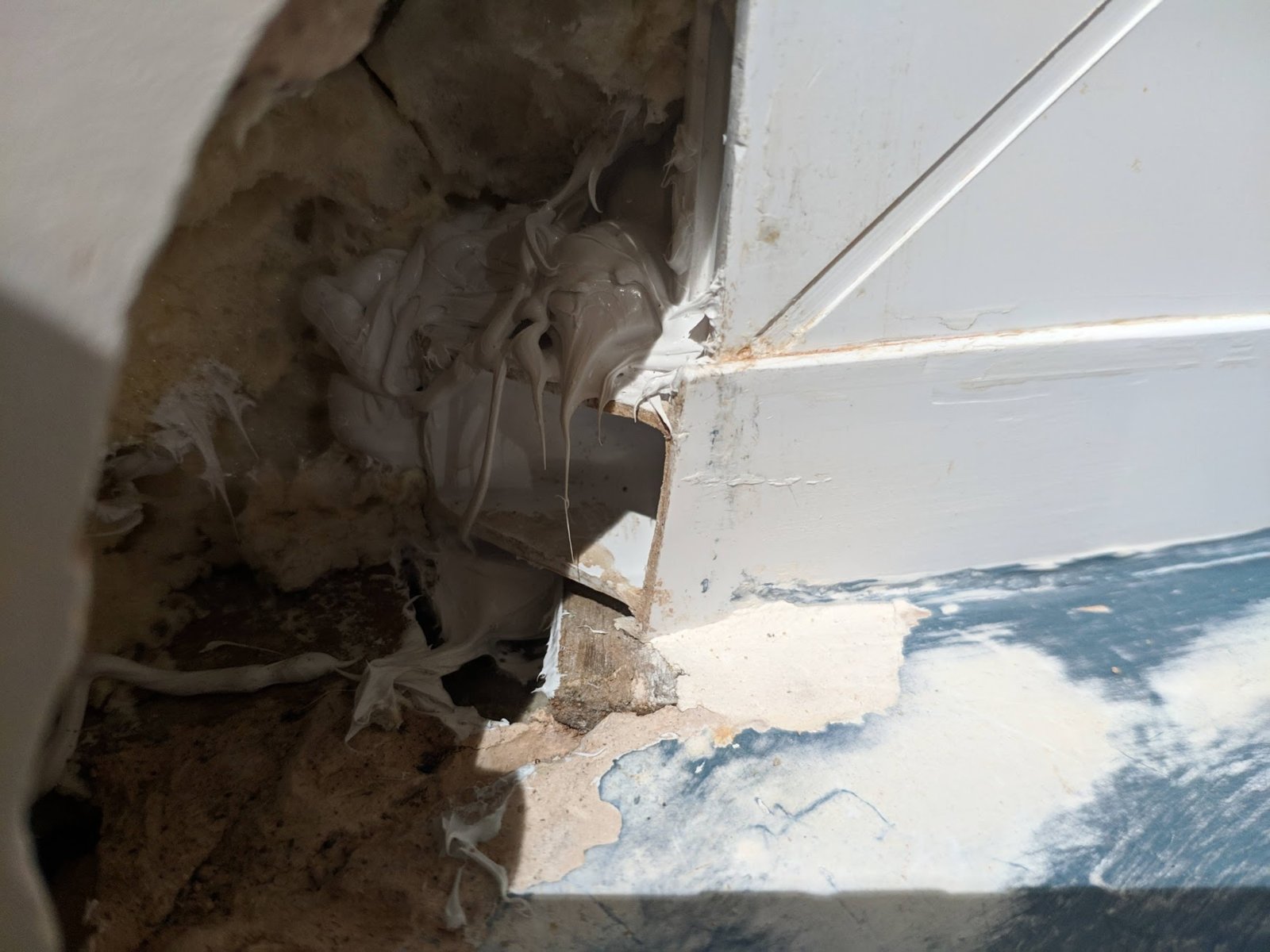

My thoughts are...
1. Run a bean of silicone along the window and sill + some extra for good measure.
2. Then fill the rest of the hole with expanding foam filler to help plug up any other gaps.
3. Then skim over the foam and paint.

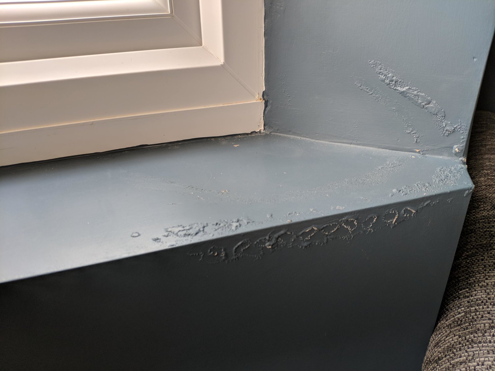

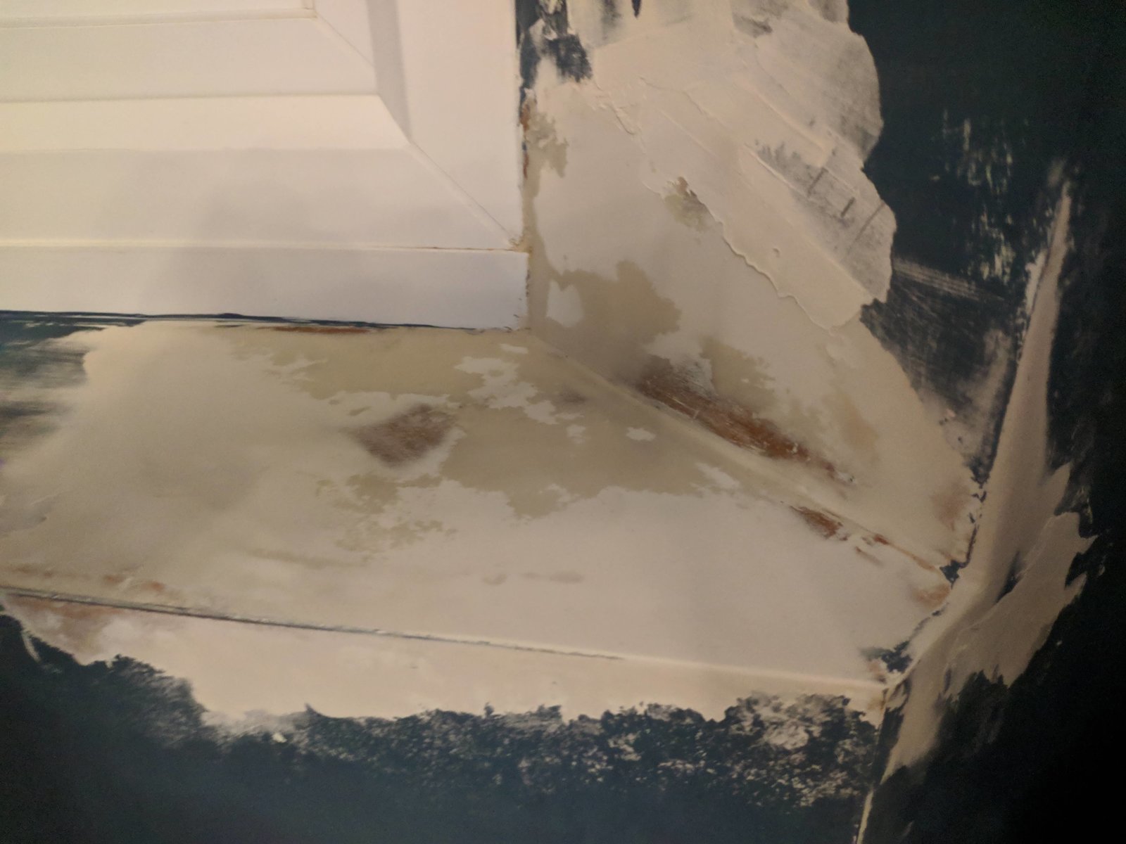

Paint starting bubble due to salts coming through...

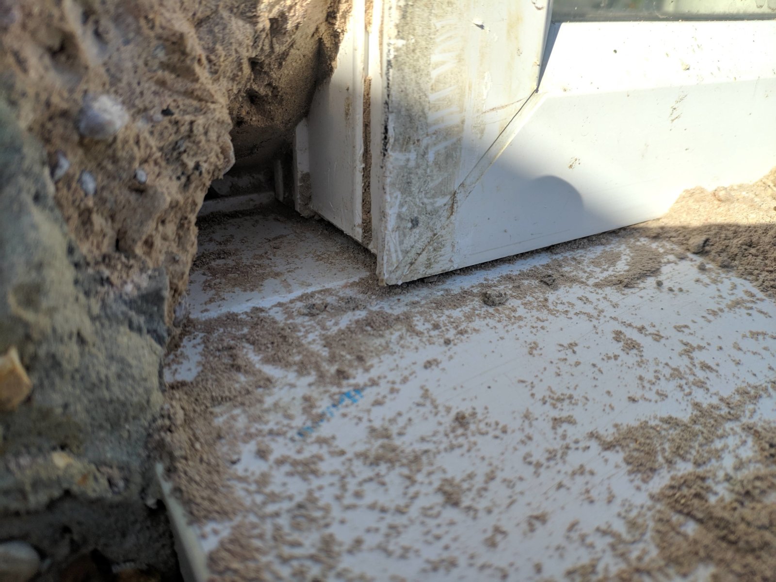

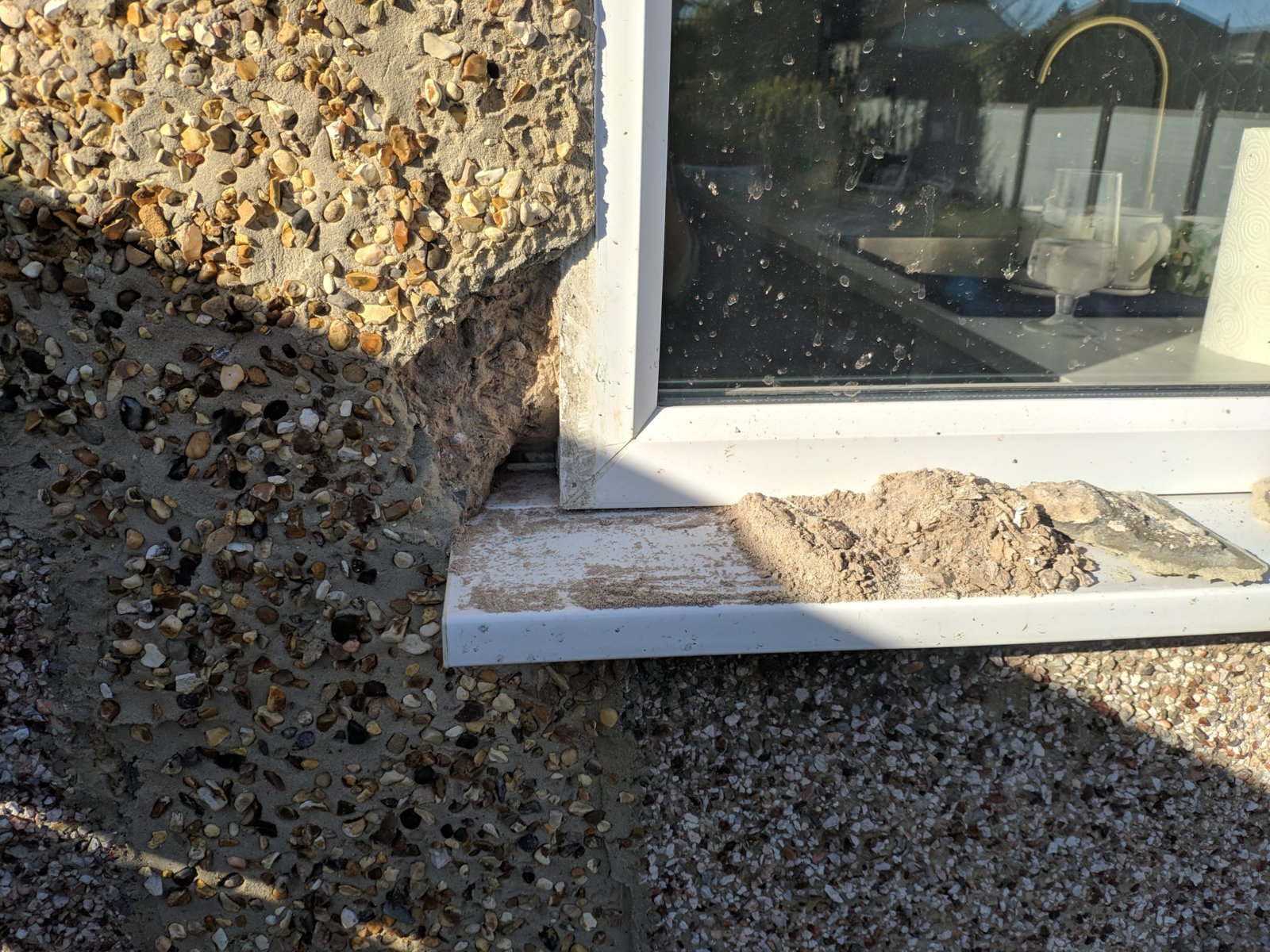

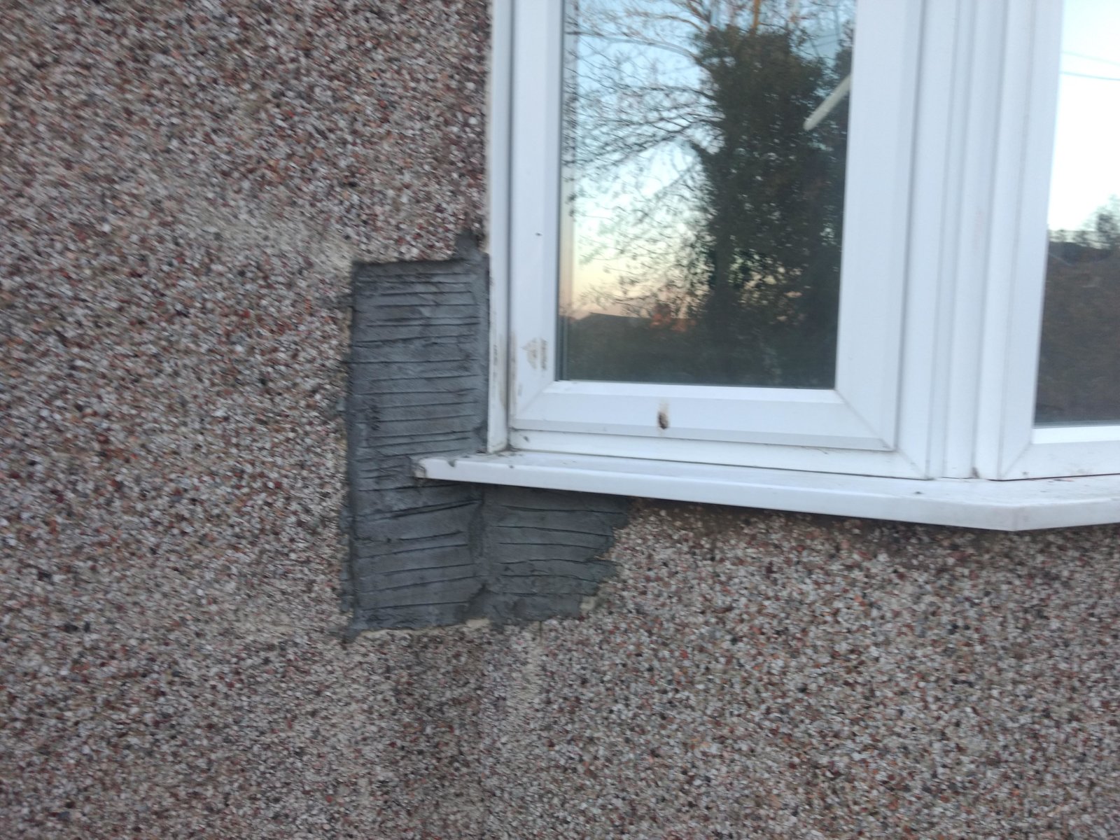

Repairing outside..

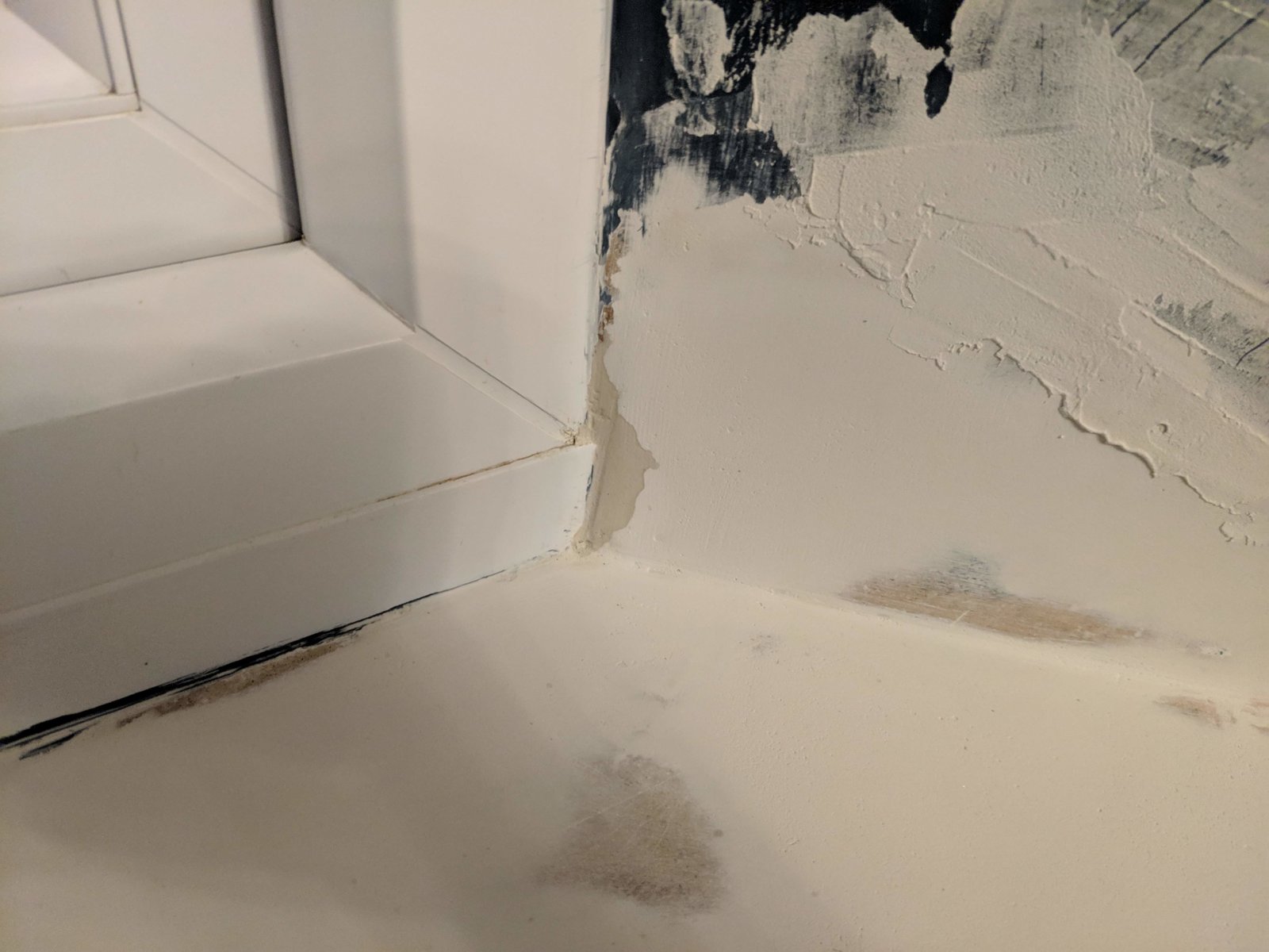

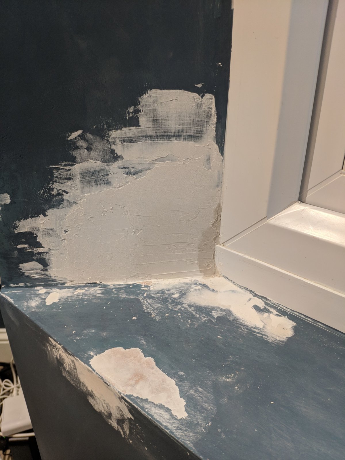

Damp re-appearing (more salt also started to appear. not in these photos)

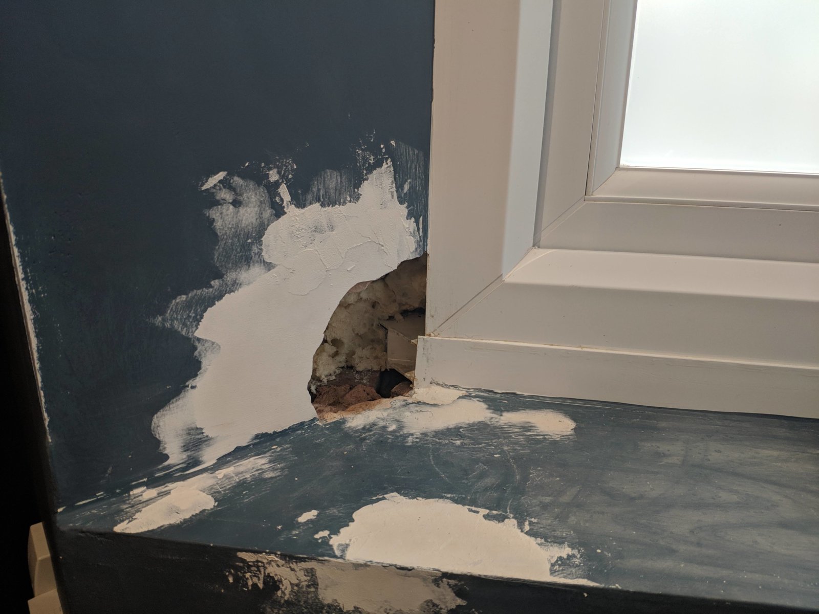

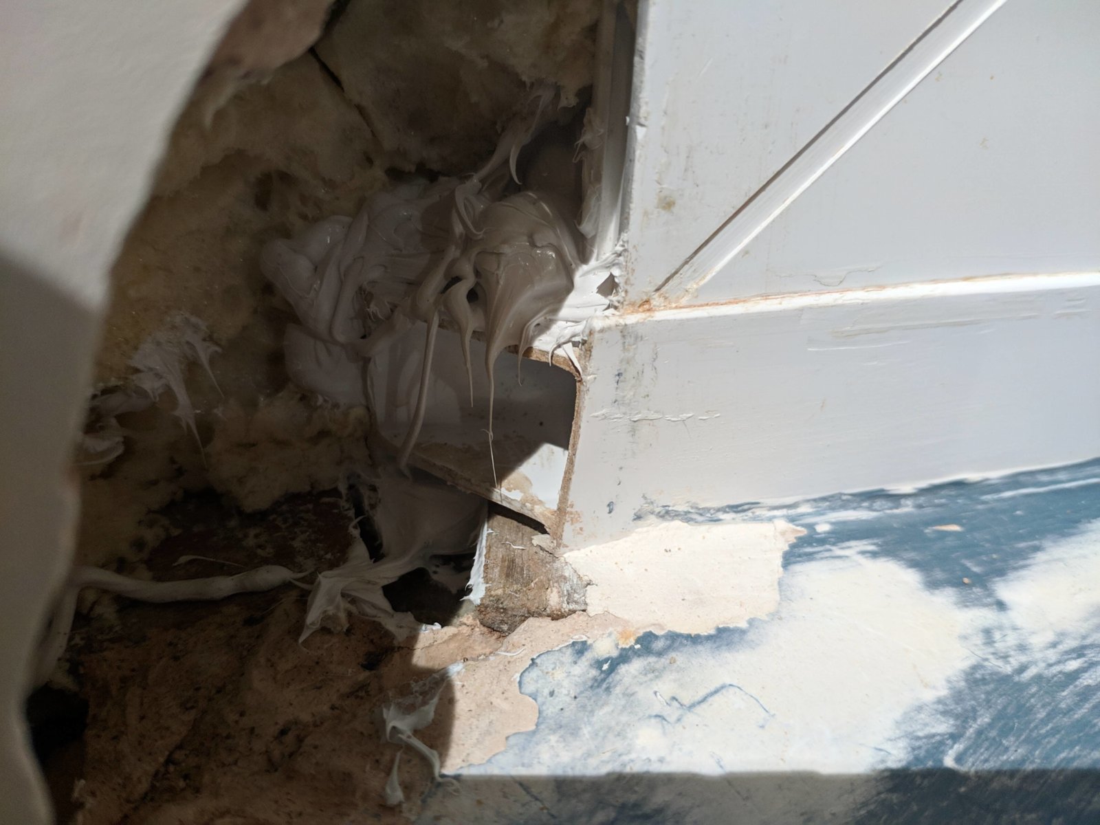

Hole made today..

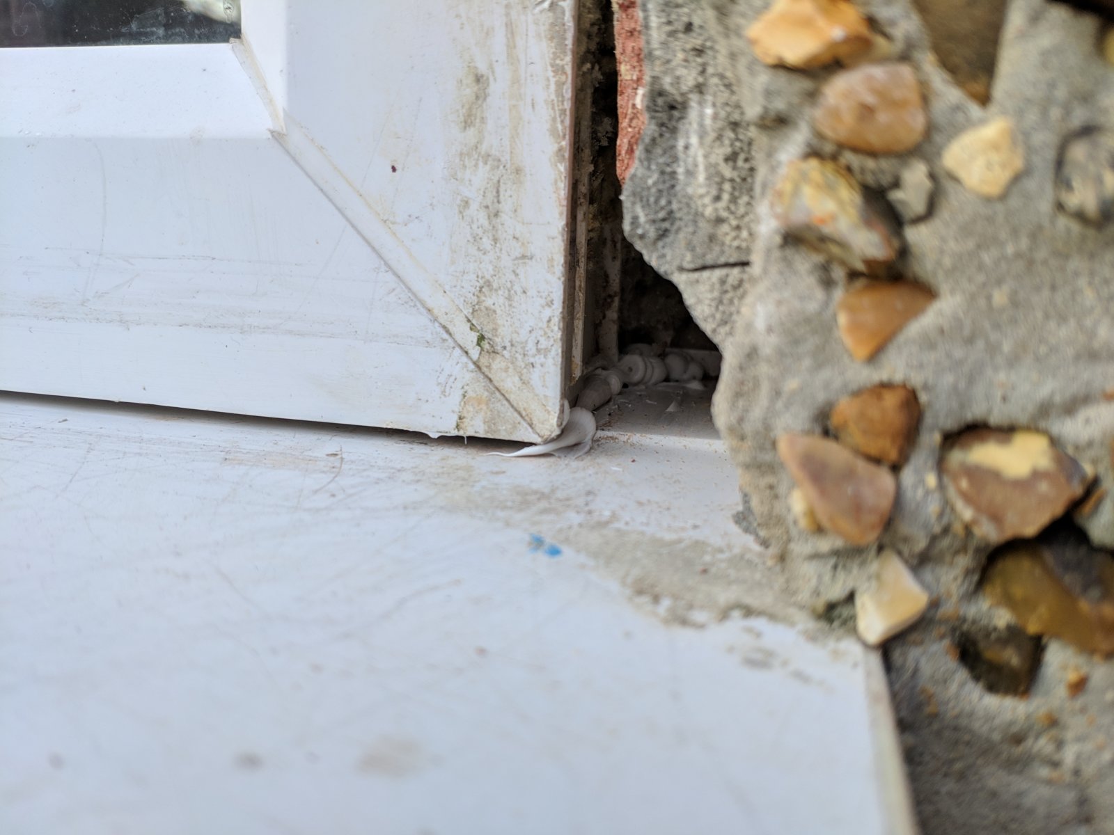

My thoughts are...
