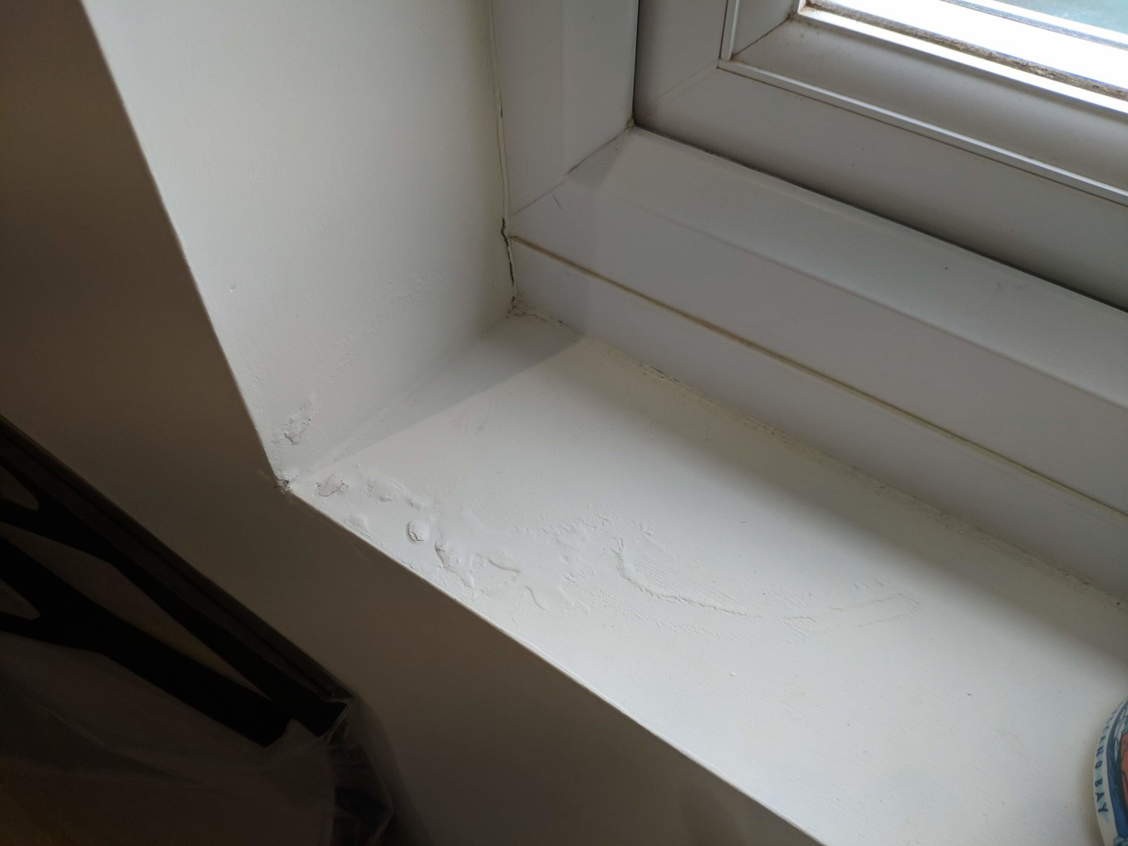

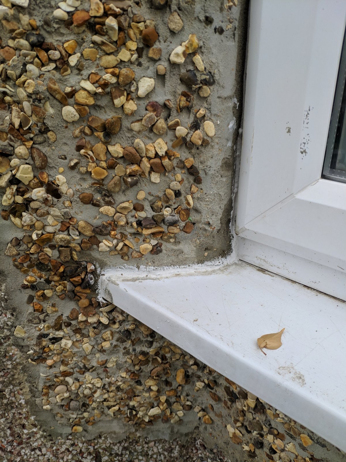

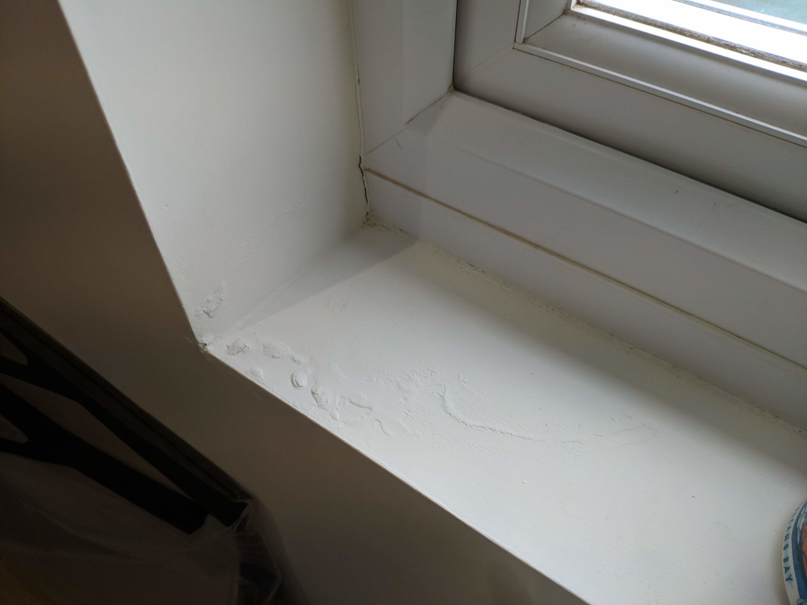

Damp patches in bottom corner of windows. Problem found. Repair advice
You are just investigating point of damp not how its entering

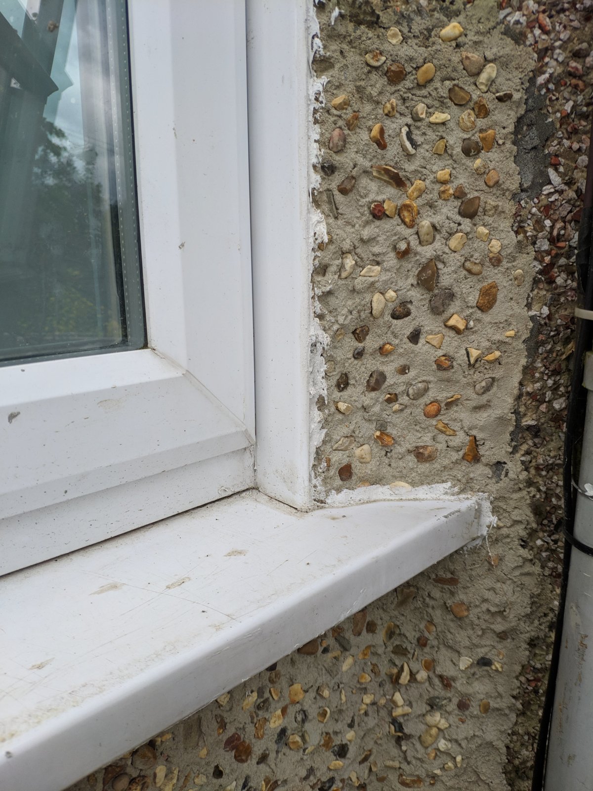

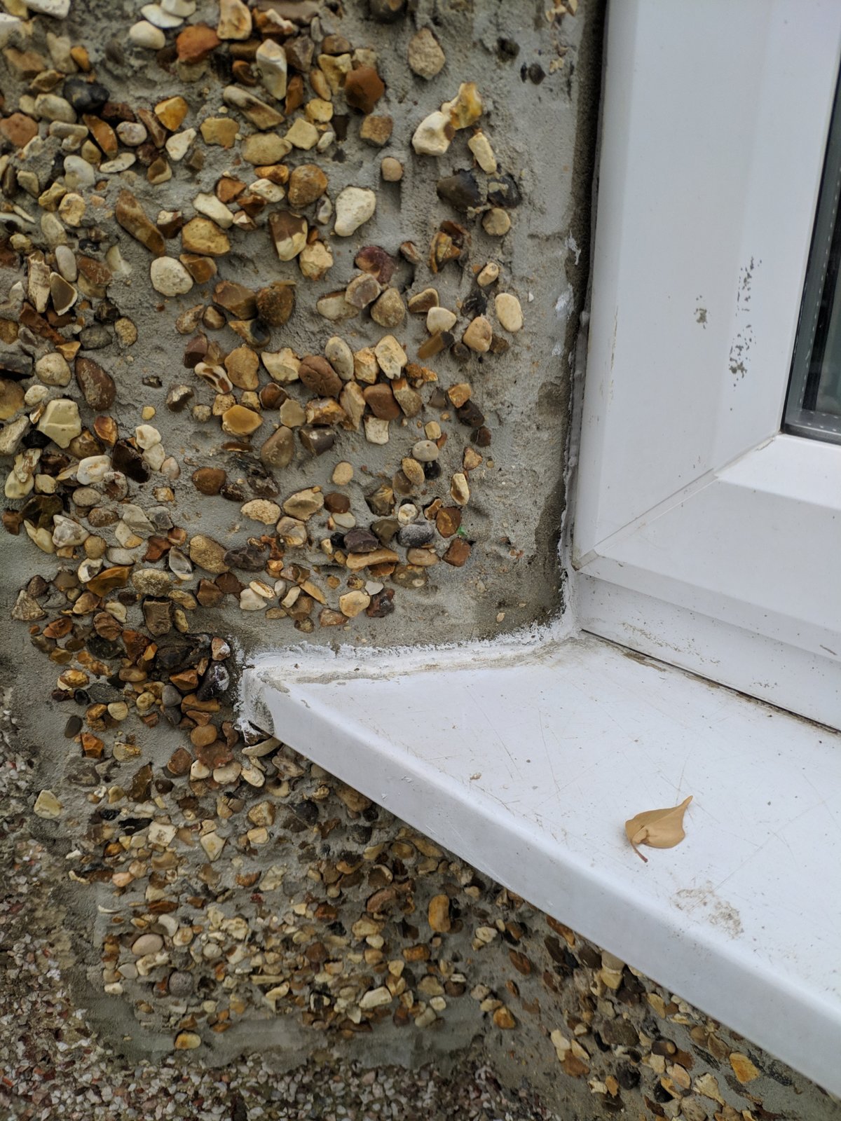

I thought I had found the entry point. Water was able to get in by running along the back of the cill, under the frame and then into the wall on the sides as there was no sealant at the edge. I suppose this was only one of the ways it is getting in..

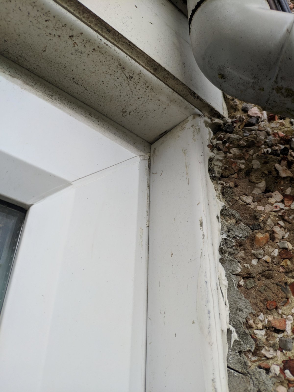

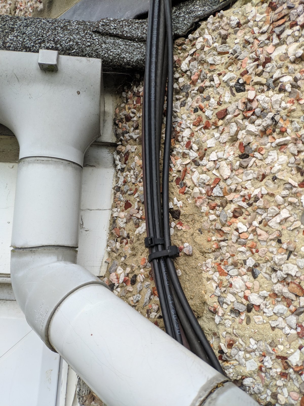

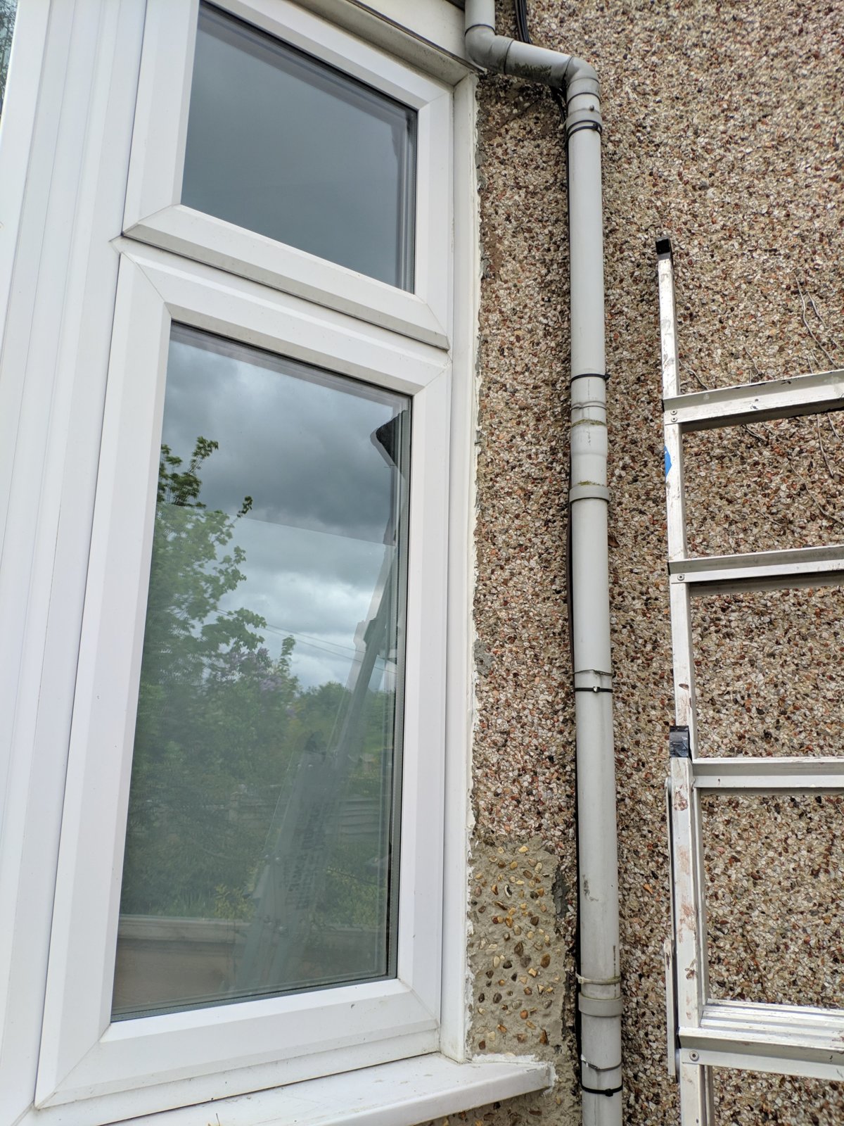

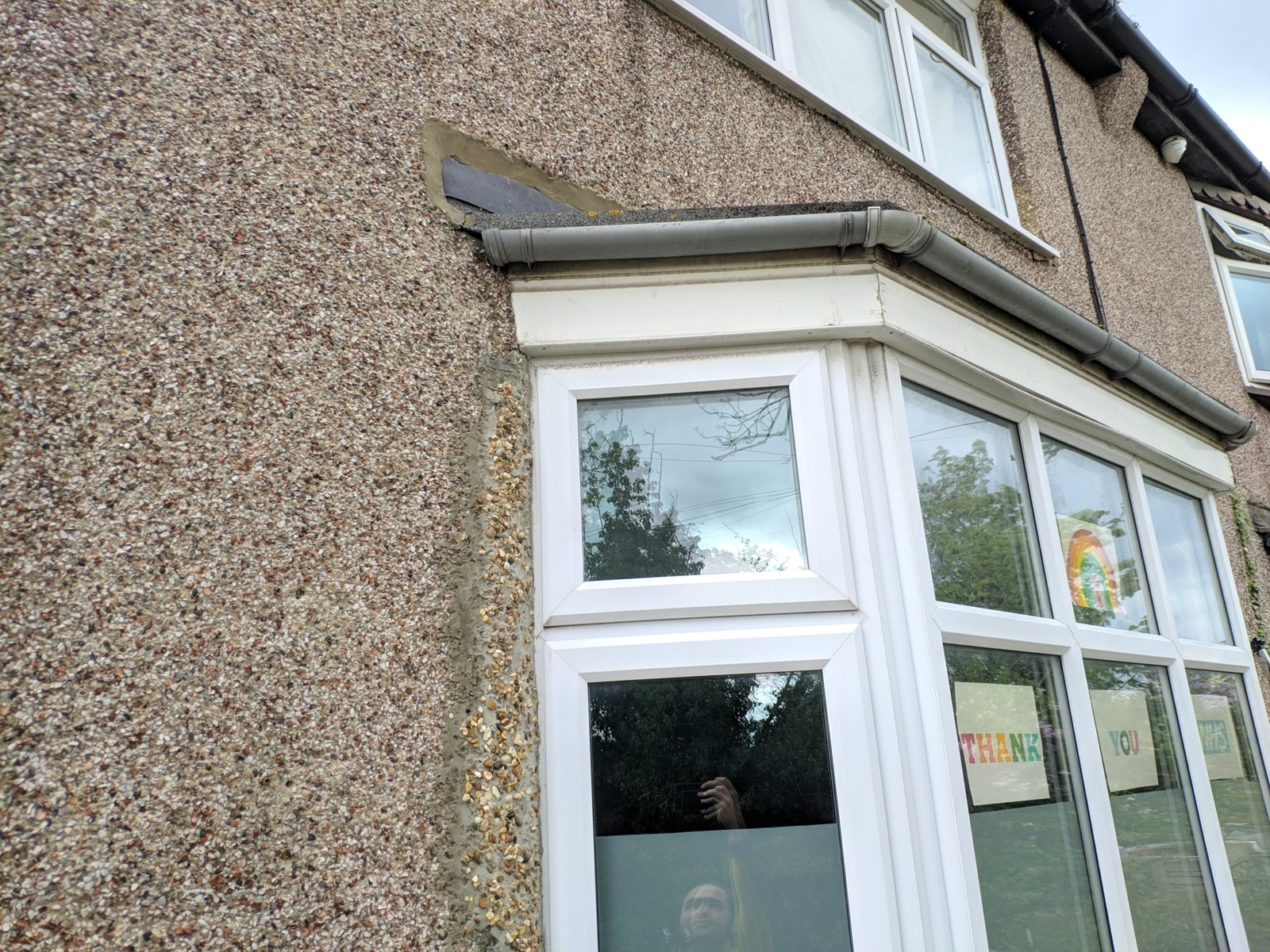

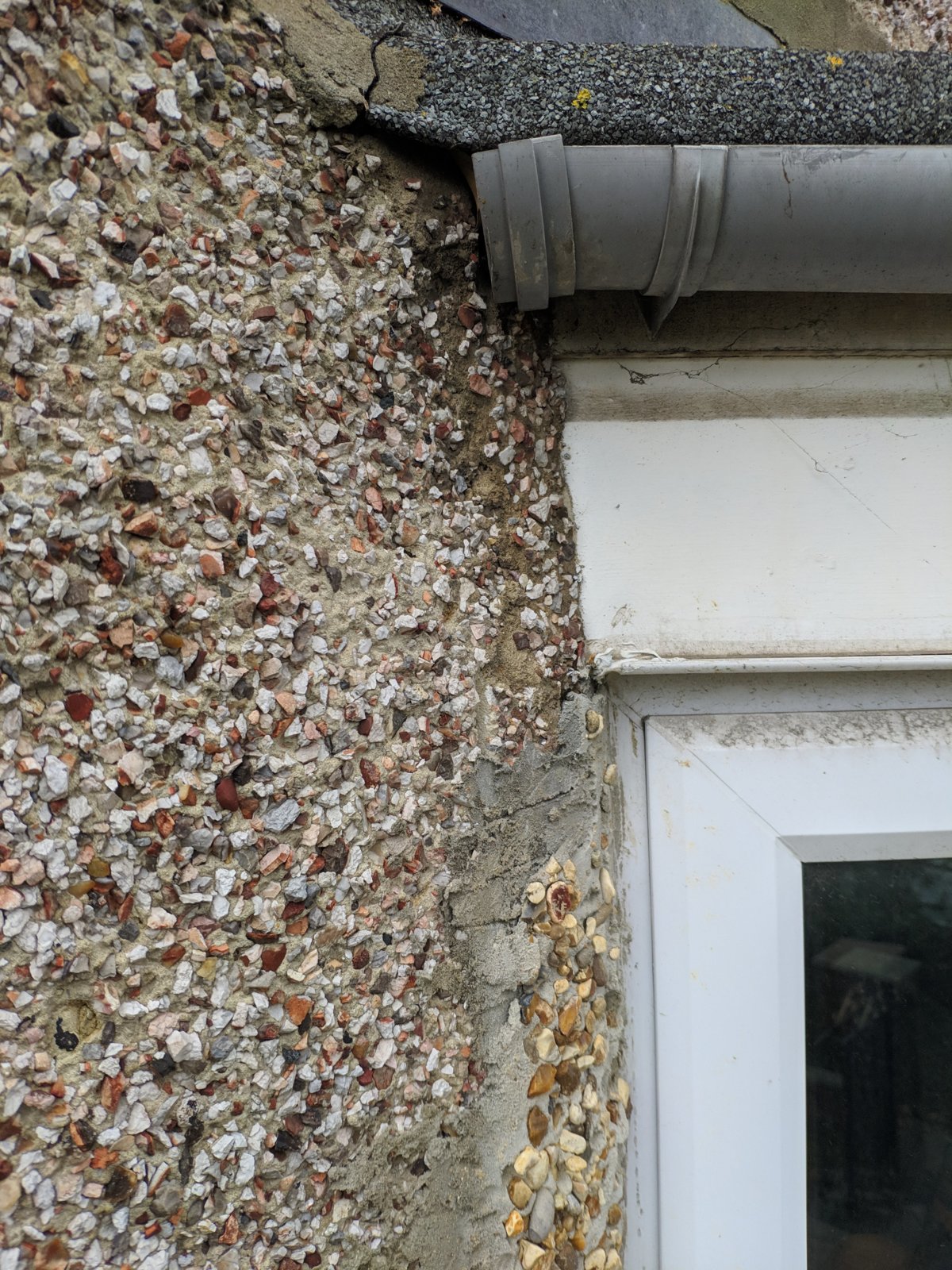

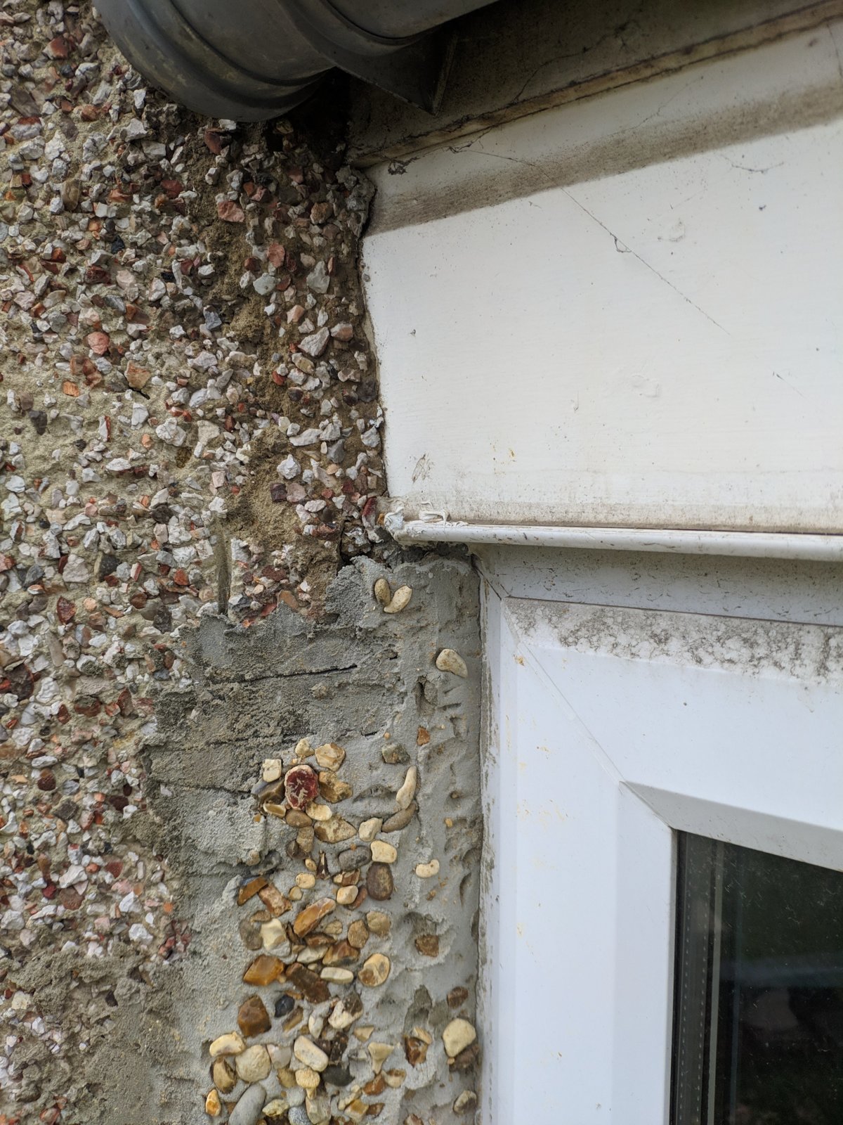

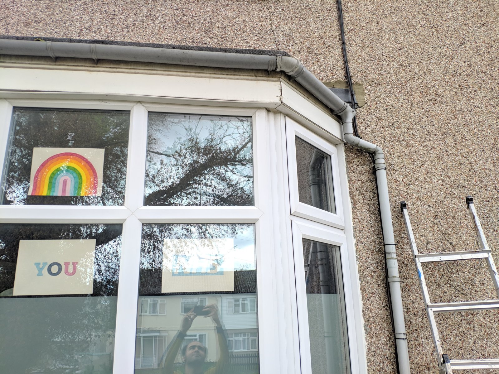

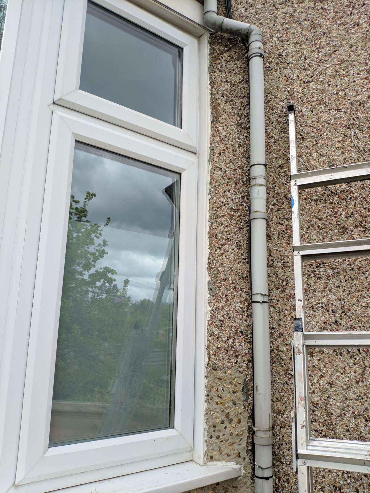

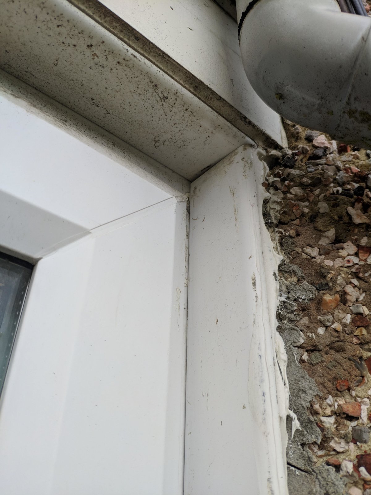

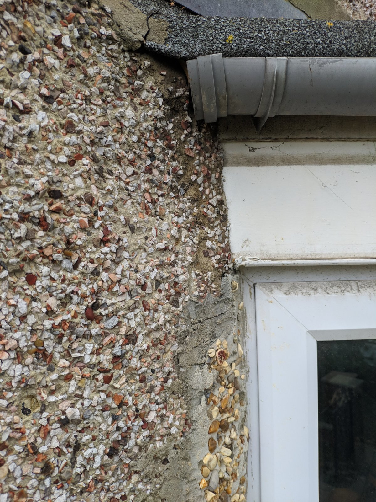

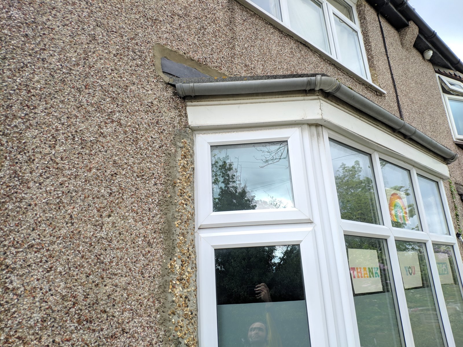

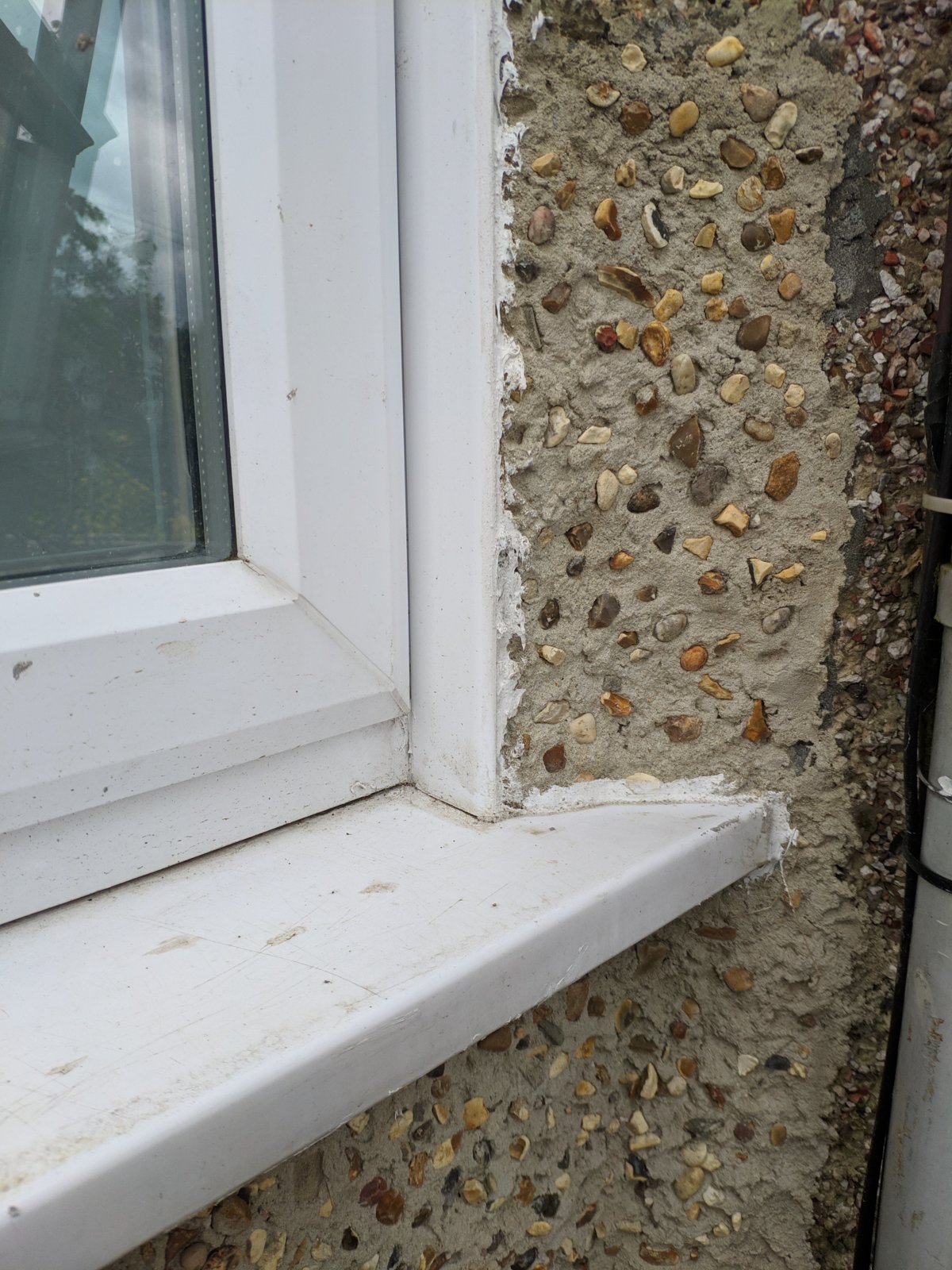

I would love to try and fix this from the outside without having to do anymore rendering or removing the whole window....if possible. Here's some photos from the outside
Left side (smaller damp patch)
IMG_20200429_122951.jpg IMG_20200429_123030.jpg IMG_20200429_123041.jpg IMG_20200429_123521.jpg

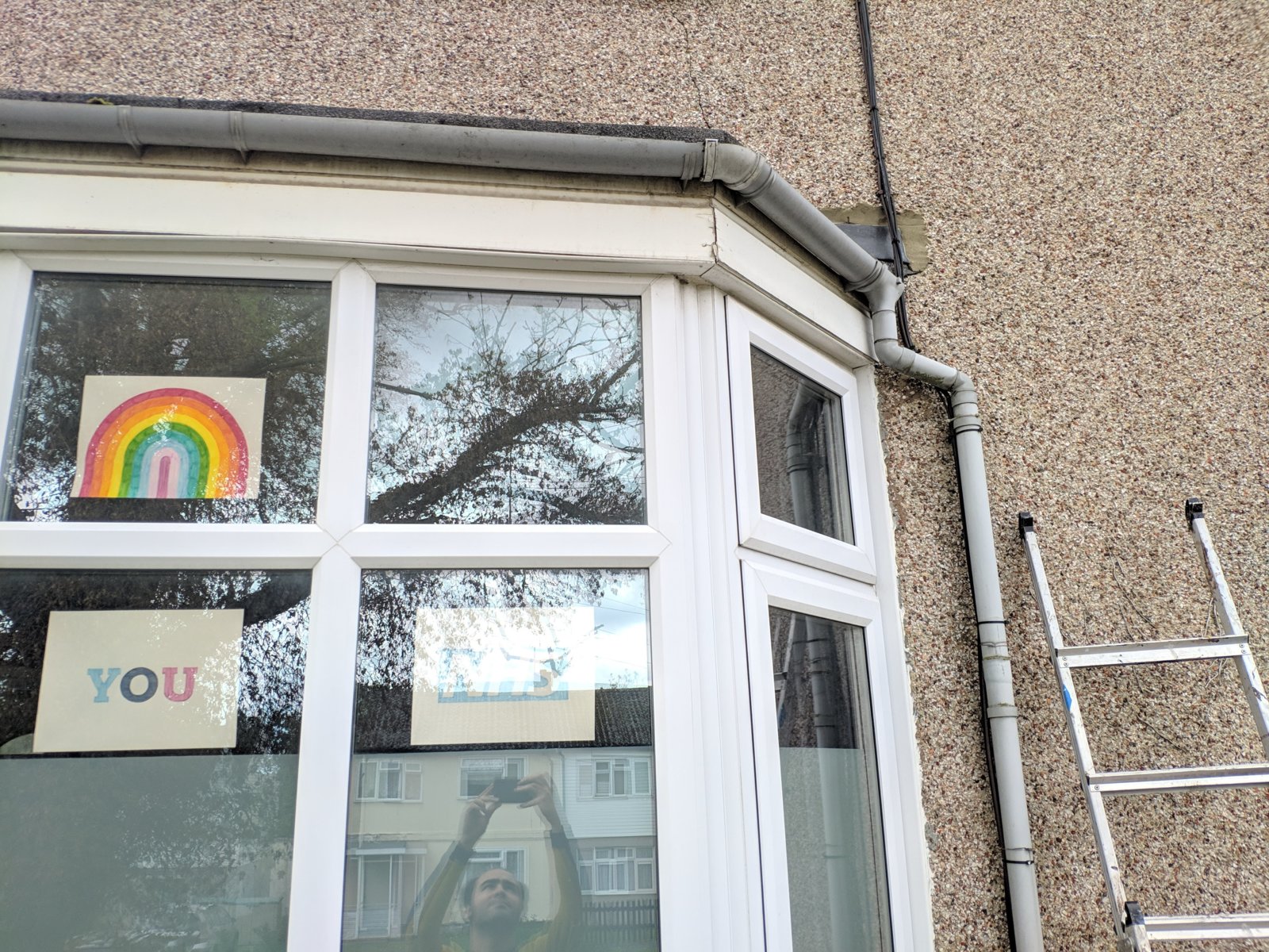

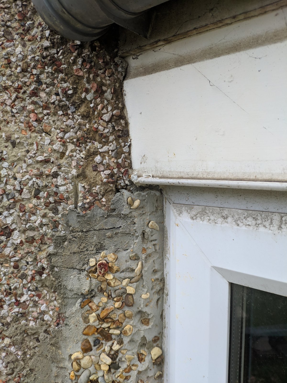

Right side (larger damp patch)
IMG_20200429_123144.jpg IMG_20200429_123410_1.jpg IMG_20200429_123416.jpg IMG_20200429_123512.jpg IMG_20200429_123605.jpg
Shall I just silicone every edge that comes of the window frame?

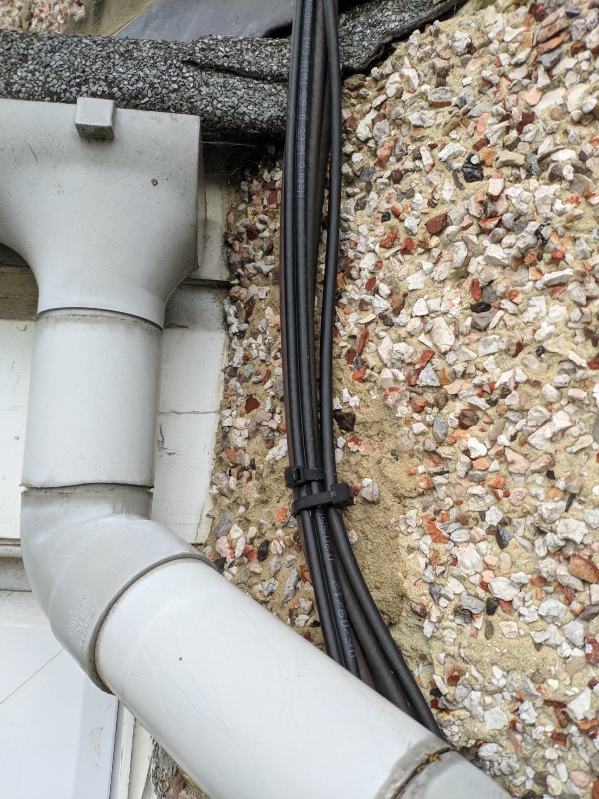

Just for fun, here is the same thing happening on the back bedroom window. This window was fine for over a year, went away on holiday last year during some stormy weather, came home and found this...
All windows show signs of the caulk in the corners coming away. You can see the gap on the caulk on the above photo. One bedroom doesnt show the damp patches (yet) but is showing the caulk coming away in the same way...
I would be looking at how the water is falling off the roof and into the gutter as well. The left side , it doesn't look like the end cap is on correctly , and maybe leaking water into the top of the frame , which is running down internally but manifesting in the corners . Again on the right side the gutter doesn't go to the end of the roof. Just a suggestion , may be wide of the mark but I think worth considering
