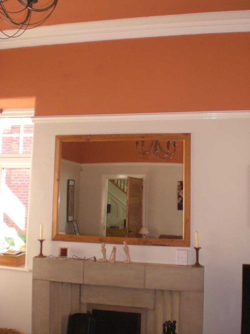

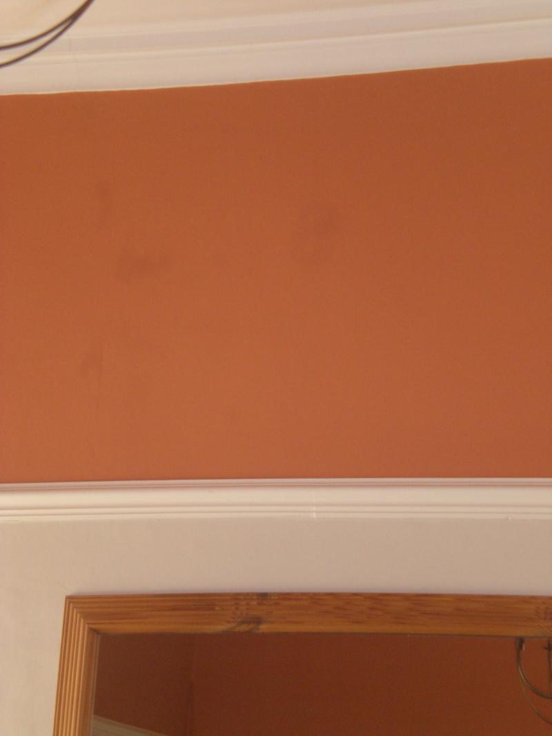

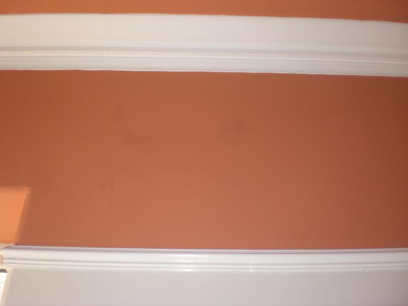

We have 3 or 4 small patches of damp just below ceiling height on the wall above our solid fuel fire. I have uploaded some pictures - you can just about see the patches below the cornice to the right of the window. They were there when we bought the house 10 years ago and we put up with it, but recently I think they are getting worse. The chimney breast is external and we have recently had the chimney stack repointed and the flashings looked at. We also have a U.F.O MKII chimney cowl fitted (mounted for solid fuel). I am therefore assuming the problem is unlikely to be external rain penetration. I am left thinking it is condensation within the chimney. If we get a burst of heavy rain the patches get darker and then slowly lighten up as they dry out. We don't use the fire much so I suppose it is not regularly 'dried' out from inside. Do we just put up with it or do we go down the expensive route of having the flue lined? Any advice would be most welcome. Thanks

Update as follows: i have had a damp proof specialist round who has said he will remove plaster etc to a suitable depth in order to be able to cover the relevant area (from the window to a width of 1.5m to the right, under the cornice and above the dado) with a damp proof membrane to stop any further penetration from the salts. He will then skim over the top. I am concerned this will just 'move' the problem and make the salt penetrate somwhere else. I just don't want to make the problem worse. Please help!

The damp also seems to be off-centre to the fireplace. Is the chimney skewed and if so are you sure there isn't a pile of debris such as soot, twigs etc building up on a ledge where the damp is. Might be worthwhile getting a video camera up for an inspection.
Yes you are spot on it is condensation from the combustion. Fitting cowls is a a stupid idea and I've been saying it for years. They slow the passage of air and allow condensation to form. You need an insulated liner.
Hygroscopic salts contaminating the plaster.
Salts come from products of combustion, and attract dampness whenever humidity rises.
