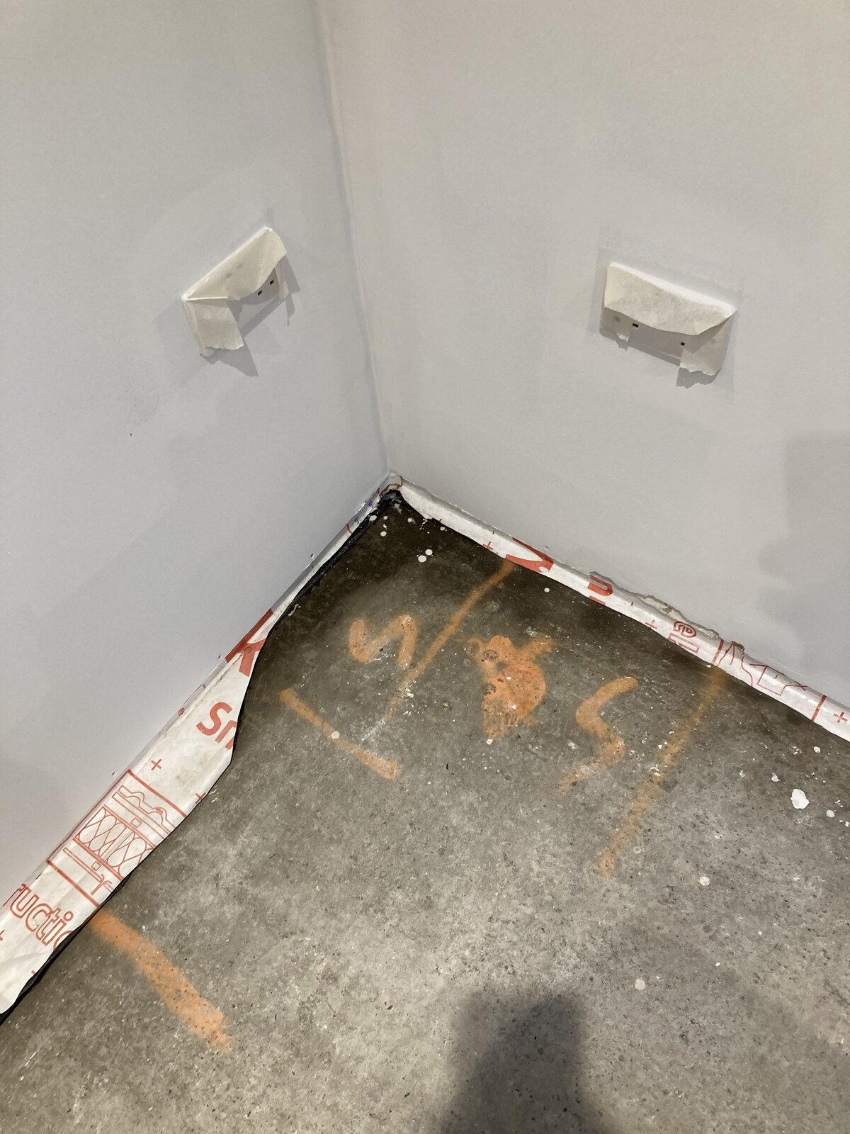

Hi,

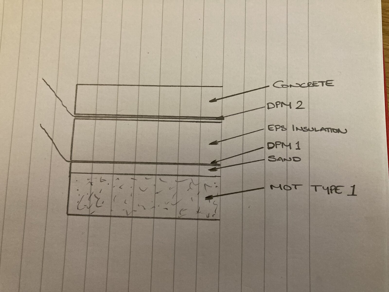

I recently laid down a new insulated concrete slab for my new garden room. I have drawn and attached the slab detail.
I have noticed a dark damp patch in the corner under the DPC I've laid under the timber frame.
There hasn't been much rain and the dampness is a brown-ish colour.
Would this be dampness rising through the slab from a hole in the either of the DPMs? I have attached a photo of the damp patch.
I have access to dig up the ground outside where this slab is so I could dig out the area to find the hole if this is the case, not sure what else it could be.
Any views/opinions would be greatly appreciated.

Hi! This is me, except you have the benefit of a few years. My construction is the same except I have an additional DPM laid on top of the concrete for the interior finish. I suspect it is condensation I am seeing. The room is still under construction and looks like it is a similar state to yours - except I still have conduit holes in the walls, the windows kept ajar to run temporary power, and no external cladding on. So lots of different contributing factors.
