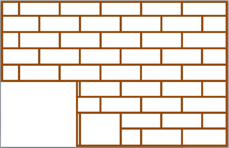

Also, what's the max span a 4x2 can take without sagging? The length of most joists will be 5400mm with some being 3600mm and I was thinking of 400mm centres.
The empty space in the bottom left is a patio area.
