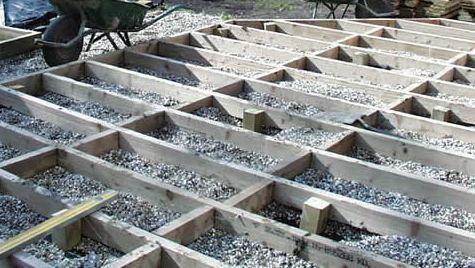

Hi,
I am building a ground deck 3m x 6m and I am using 4"x2" joists which are raised off the ground a couple of inches. I am trying to find suitable joist hangers, but only find the light duty ones shown below.
The heavier duty ones only seem to start at 6x2.
Would the joist hangers in the pictures be sufficient?
Also I am raising the deck up by 2 inches. I have read that this can be done on concrete pads for ground decks. I did see on one site where the guy doing the deck had dug holes in the area where he wanted to support the frame, chocked it up, then added posts in the holes and filled with concrete to get the position right next to the joist. I have a picture below of a similar one. I think that this was probably done the same.
Do you think that this is a good/acceptable method
Cheers for any help[/img]
1. You don't have to use hangers at all - you can screw the joists to the outer frame.
2. Use whatever method you like to support the frame at the required height - so long as it doesn't move laterally or bounce up and down then its fine.
