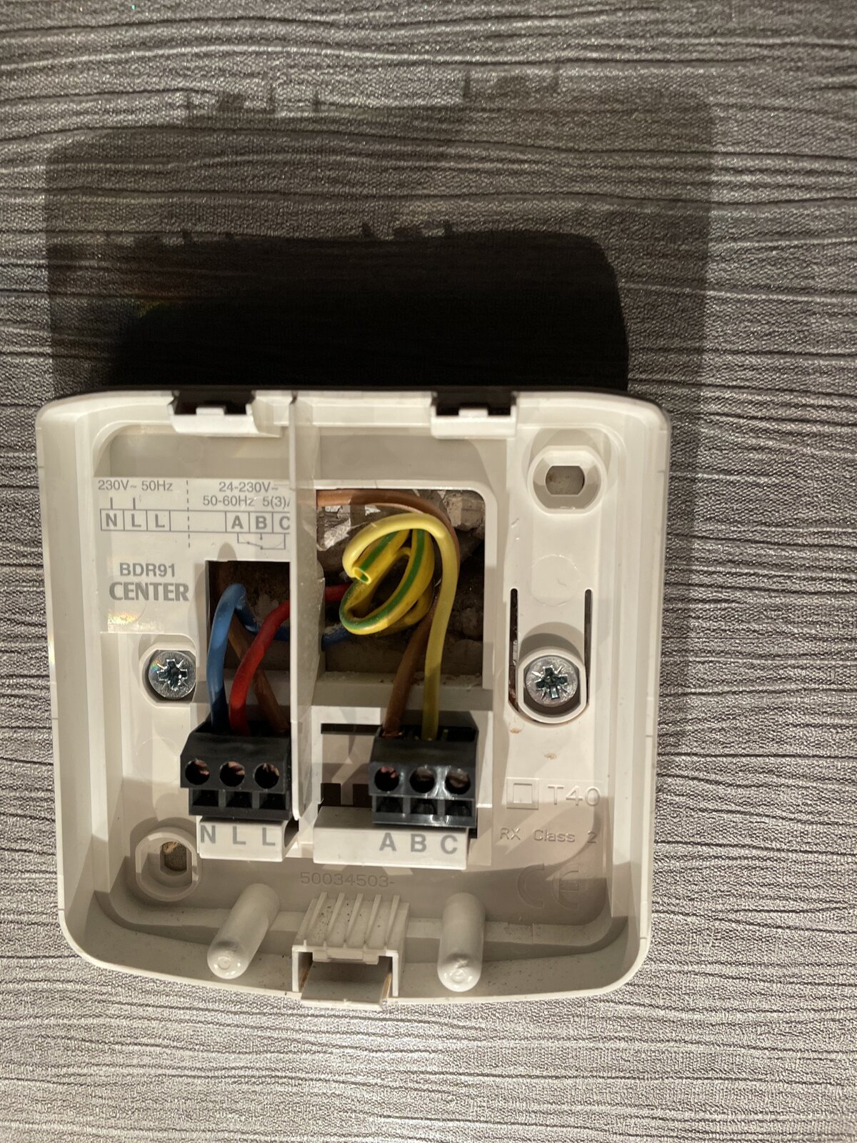

Please could someone tell me what I need to do to decommission this (see photo) I am happy to leave it in situ as am planning to install a Hive mini thermostat.

Does the brown core currently loop across between righthand L & A ?
If so (after turning off the power), using a terminal block
(a) isolate the blue into it's own terminal
(b) remove the brown loop
(c) place the red & yellow cores into a common terminal
That will effectively leave the connection as permanenly on.

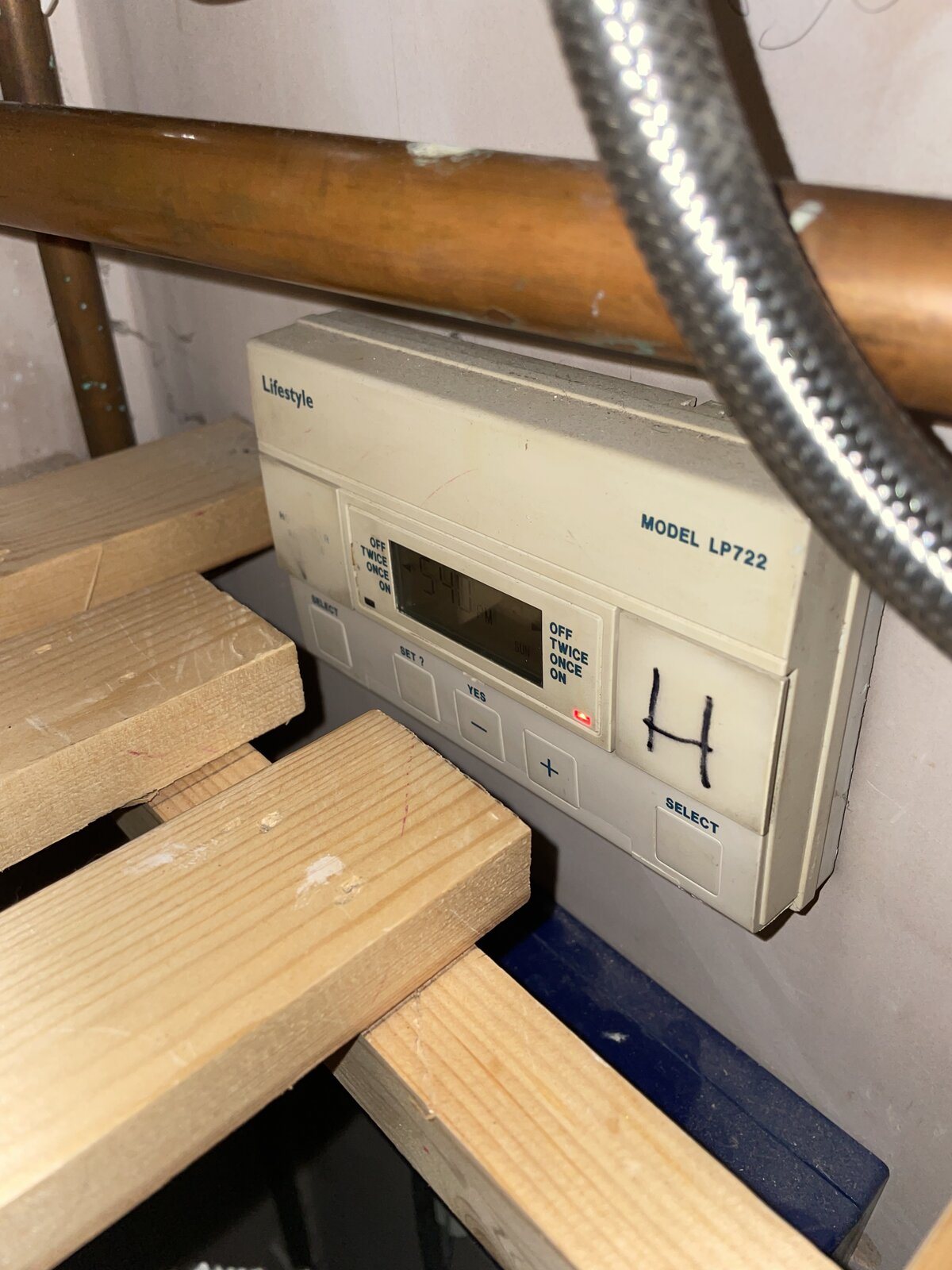

Do you have a separate programmer which will be replaced by the Hive?
Thank you very much. Yes, the brown does loop across as you say.
And yes, I have a Drayton LP722 to be replaced by the Hive.
