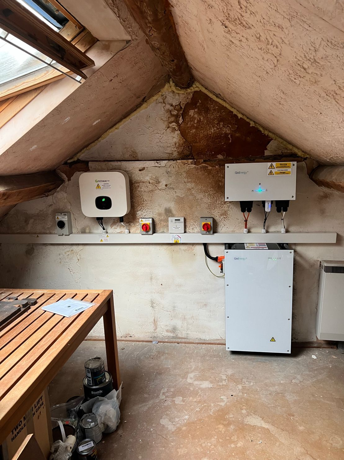

Hello everyone,
in these warm sunny days I noticed that my solar inverter reached an internal temperature of 50 degrees celsius. This is when running full whack with about 26 degrees outside temperature. Whilst the inverter is rated at an operating temperature up to 60 degrees, the inverter will start to derate beyond 45, so I am looking to add a simple cooling solution. The inverter has a passive system, i.e. metal cooling fins but no fans. I've read in a another forum that someone managed to successfully implement this, keeping their inverter at 35 degrees even with scorching hot outside temperatures. With the added bonus that it automatically switches on only when needed, i.e. at night it stays nice and quiet.
So my idea is to get a couple of 12v DC fans, mount them to the fins, connect them to a programmable temperature controller (which has a temperature sensor), and this connected to mains via transformer. The temperature would measure the temperature of the fins and switch on once it reaches 45 degrees and then switches off again once the temp drops down to 35. I have a lighting circuit very close to the inverter, which the installer also used to power the heat alarm. So that would be my power source.

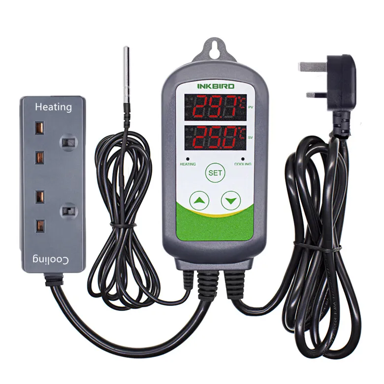

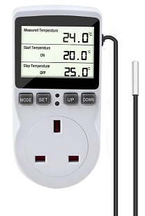

I would use a simple desk fan connected to some thing like this 1715422598426.png the InkBird 308 I have these 1715422671355.png got before the Inkbird came out, there are others 1715422781199.png but keep it simple. Not sure why is should be getting that hot now? I made up mine to brew beer, but have used them for all sorts, using a small freezer as a fridge, and turning on room fans in hot weather, what you show will work, but seems a lot of work to go to.

I like the idea of keeping things simple and these inkbird controllers look literally plug and play. If I really wanted to be lazy I could just buy these two and be done with hit?
triple fan with transformer and speed settings
inkbird-308s
the fan "set" is already wired together in series and even has different speed settings, so I can adjust to minimum effective speed. I'd just use the fan cable and plug it into the cooling socket of the inkbird. I do not have any sockets in my loft, so I'd need to cut the plug off and connect it manually to the lighting circuit. I would lose the fuse from the inkbird, but the fan plug would still have a fuse.

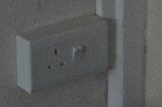

Using a fused connection unit (FCU) one can fuse to 1 amp, or maybe better with grid switch IMGP7387c.jpg like I did here. However "The PAS 63100: 2024 was published by the BSI in March 2024. Section 6.5. 5 states that batteries shall not be installed in 'voids, roof spaces, or lofts. '4 Apr 2024" but reading on here it seems not that cut and dried.
The picture they show 1715511080864.png there is a roof window with ventilation and clearly a large loft. With the work bench it seems more like a room.

It's all done now. Installed a new socket, went with the Inkbird-308, a simple DC transformer (with different speed settings) and this gpu fan, which perfectly fit over the fins. Setup and applicability of the Inkbird is super easy, great recommendation! Looks like a fairly sunny day ahead, so inverter should be running at full speed at some point, so will keep an eye temp development.

Yes definitely not clear, other than the fact that it is a recommendation only at the moment. For me personally I feel quiet happy with the location, I have mains wired heat detector, linked to the others in the house, use LiFePO4 batteries, got access to the loft. Also it's under the roof space where most of my panels sit. So I'd argue that the panels themselves actually dissipate a good amount of heat, as the roof is effectively now shaded for 80% of the surface. Tbf, I don't really have any other option if it became law... but as is the case with many aspects of old victorian terraced houses >> it appears quite rare for regulator to force costly change to an existing setup that was legal at the time it was installed.
Anyhow, according to this link, the working group will meet again in July to hopefully refine the standard and give some leeway/guidance for batteries in lofts, e.g. acceptable subject to some common sense additions (LiFePO4 only, access, smoke/heat detector etc). In this aged housing stock in London you already have to be lucky to have enough roof space, the correct orientation of that roof space, no trees covering that roof space, etc... for most of my neighbours in a 100m radius it rules them out and that is a good amount of properties.
